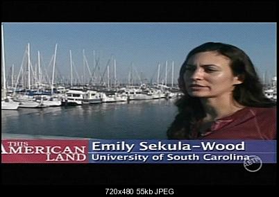

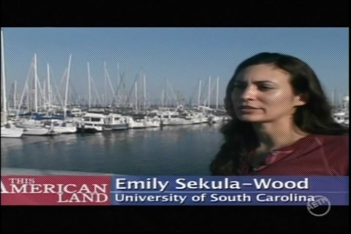

  1. I am trying to capture video clip off a DVR to PC. I am running RCA cable from DVR to hauppage HVR-1600 using WINTV 7 capture software. When viewing the captured clip I notice interference/noise not present on DVR clip when shown on TV screen. Any thoughts?
    Please see attached clip.

    The clip looks normal in specs. Describe the "interference/noise" you see.
    Looks to be the same artefact discussed here:
    https://forum.videohelp.com/threads/331681-s-video-artifacts
    One of my TVs has a dodgy S-Video socket and intermittently shows the same interference.
    Also when I set my DVD player to output composite/CVBS but set my TV to 'expect' an S-Video signal over SCART.
    dghyland; Are there any settings in the Hauppauge software where you can switch between S-Video and composite/CVBS?
    Are you using any adapters between your DVR and PC?
