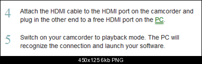

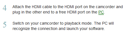

    Originally Posted by handyguy View Post
    Sony HDR-CX160 Full HD 16GB Camcorder HDMI Out Wide Angle 42x Zoom Black
    Has HDMI Out, use that, you can use really long cables with it & I use a 30' one with mine. cable was under $10 on amazon.
    Read this:How to Stream HDMI From a Camcorder to a PC
    http://www.ehow.com/how_8443982_stream-hdmi-camcorder-pc.html
    he is going to be streaming 640x480
    also 20m (~66ft) is too long for HDMI or Firewire without repeaters.
    eHow says this. No that isn't going to work.

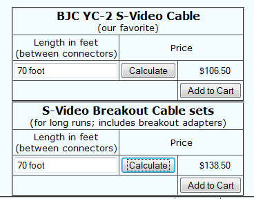

    Cheap Cables (should work)
    http://www.monoprice.com/products/subdepartment.asp?c_id=102&cp_id=10207
    Quality cables (recommended for 20+ meters)
    http://www.bluejeanscable.com/store/svideo/index.htm
    If this is important, I'd get the S-Video Breakout Cable set for the most reliable cable connection. This scheme uses two large coax cables to separately carry luma and chroma with S-Video adapters at each end.
