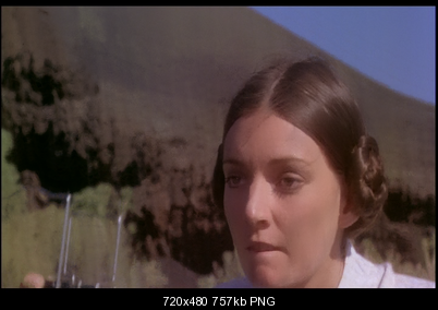

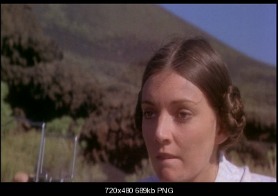

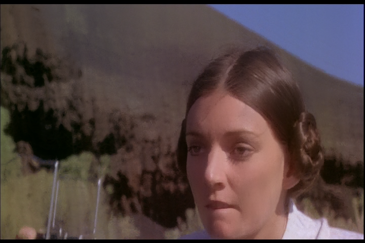

  9. McTemporalDenoise's major innovation is that it's motion compensated. Instead of averaging pixels from the same X,Y coordinate in each frame, it tracks motions and averages from the different locations. This eliminates the smearing that you get with simple temporal filters that only use motion masking.
    For example, here's a frame from a noisy MPG video where the camera was panning down, after some heavy filtering:
    original:
    VirtualDub's Temporal Smoother at 6:
    McTemporalDenoise(settings="medium"):
    Notice how Temporal Smoother has smeared the background and lost a lot of detail, and it still has more noise than MCTD.

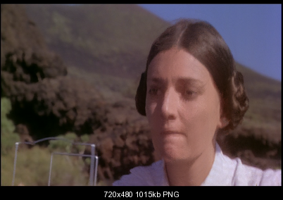

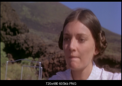

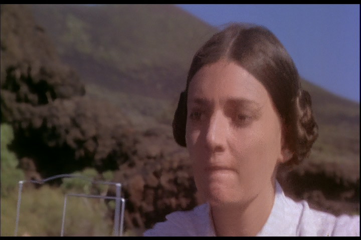

    Or a few frames earlier in the shot where the camera is still but the woman's head is moving down:
    original:
    Temporal Smoother 6:
    This time the backgrounds are similarly filtered but TS6 has mangled the woman's face.

    Meanwhile, another mystery. . .
    These are the first 6 frames (0 thru 5) of the "sample1.m2v" download, unprocessed. Opened directly in VirtualDubMPEG2.
    [Attachment 10186 - Click to enlarge]
    Below, this is what those same frames look like loaded via Avisynth. It doesn't make any difference whether or not I apply any filters. These were loaded from .d2v using exactly the same script jagabo posted, with no changes. I also tried loading it into VirtualDubMPEG and recompressing straight to AVI, but as soon as I open it with AviSource in Avisynth I get the same results. I don't think the problem is DGIndex, I tried other .d2v's with no problem.
    [Attachment 10187 - Click to enlarge]
    On top of that I get this error from VirtualDub at the end of processing with the script:
    [Attachment 10188 - Click to enlarge]
    Downloaded the .m2v again, scrolled through with DGindex preview, reinstalled VirtualDub and Avisynth, checked the related plugins, etc., etc., ad nauseam. Same problem, but only with this .d2v .
    Anyway, I deleted frames 0 to 4 in the final MPEG posted above.
