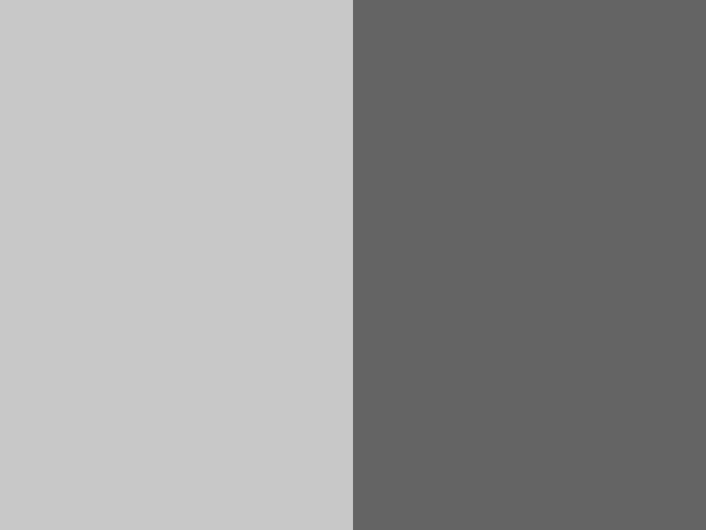

  25. I was just looking for a fast script to remove the flicker without causing motion trails but everyone has contributed massive scripts for stuff that I don't want! The original script Sanlyn posted removes the flicker without causing motion trails and it does a lot more but I still don't know what part of it I need to just remove the flicker without causing motion trails!
  26. I still don't know what you mean by flicker.
  27. Why do you keep asking that like this is the first time you've visited this thread? You've been here since the start of the thread and you know that I'm trying to remove the flicker/tape noise or whatever you want to call it, to the left of the guy in the video. The filter is called DeFlicker. The webpage for it says "This filter corrects video that has frame luminance variations over time, what we might generically call flickering". It looks like flicker, the filter is called DeFlicker, the web page mentions flicker and when I use the filter it removes the flicker so that's why I mention flicker. You can see the flicker clearly here
  28. I told you already that Deflicker filters are for WHOLE FRAME LUMINANCE CHANGES. Luminance changes in a small areas are not flicker they are NOISE. You use DENOISE filters to remove them not Deflicker filters.
    https://forum.videohelp.com/threads/341188-Still-have-flicker-after-Denoising-with-AviS...=1#post2125219
    This video may flicker but a deflicker filter will not fix it because the average luminance of every frame is the same:
    You may have to click on it to make it flicker.

    Mm . . .if you run another smoother without the other filters, you'll see something that "looks like" flicker in various areas, especially in the left-hand background and the dark clothing. But that's not real full-frame flicker. It's localized flutter, dancing grain and hopping artifacts -- I really hate the latter -- and damage on the left. Kinda like the tape was flawed and not hugging the heads, or maybe a VCR that made one of the dupes had fluctuating output of some kind (???). I don't know, but it's noisy and tough to fix on the left without wrecking something. But it's not flicker.
    To answer holygamer: Run DeFlick first to tame the flutter, about half of it anyway. The rest was cleaned with NeatVideo (at just below-medium power, mostly in Cb and Cr, less in luma. The .dnp and .nfp files I posted have NeatVideo's settings). If you run NeatVideo first, it still doesn't work! I looked for a NeatVideo replacement for your use, but can't find one. By themselves, neither filter did the job. Temporal smoothers are the closest I came, but as jagabo noted earlier if they're set strong enough they're overkill. Earlier, I ran MCTemporalDenoise by itself and NeatVideo by itself, each at pretty strong settings. I think you can see by the posts that neither filter alone did what I wanted.
    But it ain't flicker, unless you want to call it "local flicker" or "partial flicker", or whatever. By itself, NeatVideo is practically useless on flicker or spots, and wasn't designed for it. Flicker affects everything in a frame. I think what you refer to is localized temporal noise. I call it flutter, and I'm fairly certain it's from damaged tape. A line-level tbc would have helped -- if you separate fields, you'll see what I mean.
