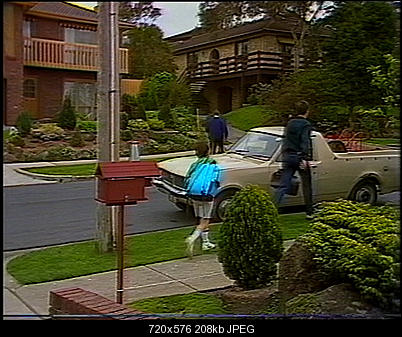

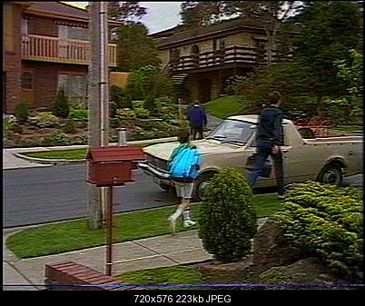

    Hello everyone, I am about to archive around 200 VHS tapes and am hoping someone here can advise me of a PAL VHS (preferably SVHS) VCR which does not filter the image. Let me explain this requirement ...
    I started off with my JVC S8700 deck, chosen for it's TBC. Due to some vertical jitter/jumping, I dug out my old Sony SE800 which exhibited a very grainy image but tracked well and had a very stable image. The graininess is not a problem thanks to PC noise reduction software, and adding an old Panasonic ES10 DVD recorder to the path (pass-through) eliminated horizontal time bass jitter.
    I would love my SE800 if not for the fact that for some reason it blows out (crushes) bright parts of the image, which looks awful on some recordings. SO - I would like a VCR that, like the Sony, does not attempt any filtering of the image (or has filtering that can be switched off), but which also does not crush whites/blacks.
    Let me demonstrate my objection to the JVC output. Here are two images from the same tape, one slightly brightened image from JVC 8700 (TBC/DNR OFF), and one from Sony SE800 :
Name:	ramsay st 8700 neatvidR1.jpg
ID:	9799Click image for larger version
Name:	ramsay st se800 neatvidR1.jpg
    Both have been through a modest noise reduction pass in Neat Video. While I suspect the Sony may be doing some sharpening (even with "Reality Regenerator" sharpening switched OFF), there are image features which are simply absent from the JVC output - I believe, even in EDIT mode, the JVC is applying a filter which reduces grain at the expense of "flattening" the image. The following thread demonstrates this :
    https://forum.videohelp.com/threads/267958-VCR-comparison-JVC-HR-S9600-Panasonic-NV-FS2...-%28AG-1980%29
    I know the panasonics are well regarded here, so I basically want to know which non-TBC models (apart from the rare HS900) have image filtering (e.g. CVC) that can be FULLY deactivated, and are otherwise decent models ? I have perused a few online Panasonic VCR instruction manuals, and the majority indicate that CVC cannot be switched off. Also, are there other non-Panasonic models I should be considering ?
    Many thanks in advance !
    Using s-video?
    It looks more like composite, given the degraded chroma shift.
    Assuming SCART not in use.
    Models listed here: VCR Buying Guide (S-VHS, D-VHS, Professional) for restoring video
    Aside from those, not many would come recommended.

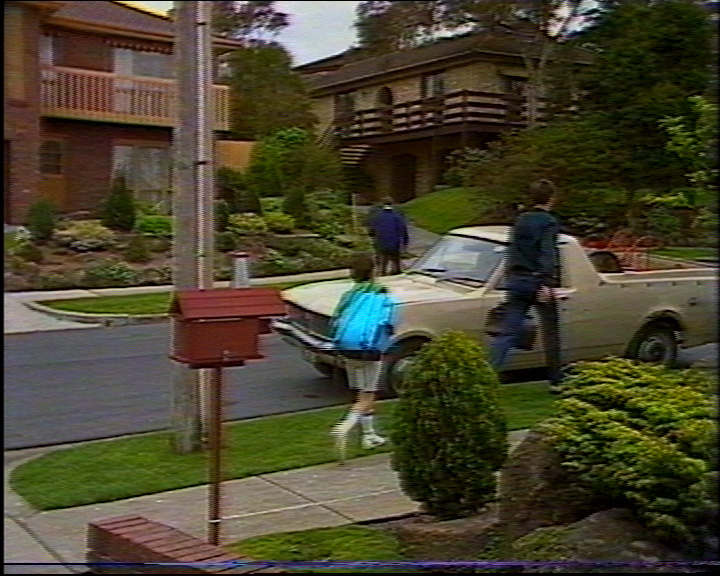

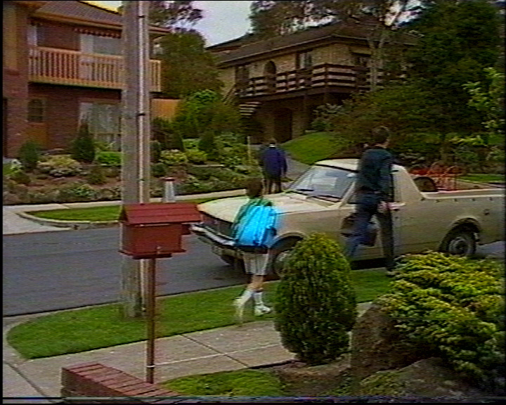

    Which values ? If you refer to brightness/contrast, I boosted the contrast on the JVC cap a tad so that it matched the Sony. These are not raw images - they have both been moderately noise reduced as I mentioned above. Below are the unfiltered originals. I posted the images mainly to compare apparent sharpness/detail - in particular the roof tiling in the upper left corner.
    Sorry, I should have mentioned in my original post that the JVC was indeed set to EDIT mode. While I am also suspicious that the Sony is using a sharpener or detail enhancer, how could such a filter pick out the roof tiles if they are all but absent in the JVC cap ? Vertical lines on the front door of that building are similarly absent on the JVC.
    Sanlyn - in fact I don't use the sharpener in Neat Video. I also have a JVC 6700 which produces output very similar to the 8700, perhaps marginally better. I also have a second SE800 which has identical grainy output to its twin. All of them came off ebay.
    Jagabo - until LS mentioned the chroma shift it hadn't even registered with me ! While I am anxious to produce a detailed cap (real or perceived), I am pretty insensitive to chroma issues. The chroma shift appears to me to be in both caps.
    I am eyeing up several Panasonics on ebay, including one which is collection only (local to me) and apparently allows for the image filter to be bypassed.
    Here are the unprocessed caps - I should mention that this tape is 20-22 years old.
Name:	ramsay st 8700 raw.JPG
ID:	9805Click image for larger version
Name:	ramsay st se800 raw.jpg
  8. Member 2Bdecided's Avatar
    Nov 2007
    I think it's 20% greater resolution, and 80% high frequency boost. I've done a 2 pixel unsharp mask on the JVC image, and it's close to the Sony, but not quite there. Some roof tiles do appear, amazingly. The halos on the Sony indicate the equivalent of a 2.5 pixel unsharp mask horizontally.
    There are a lot of JVC fans on here. These threads usually include a "your JVC must be faulty" statement, and a "it's just edge enhancement" statement.
    In this case, I think it's mostly edge enhancement, but there may also be a little more detail on tape.
    FWIW I prefer some Panasonic machines (the DNR on Panasonic and JVC does sometimes visibly remove details - and with JVC you can't turn it off without turning off the TBC), but beware HF boost that can't be switched off - some seem to add it even in "soft" modes - I swear some even soften the picture after sharpening it!

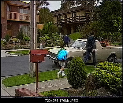

    Well, well ... so I dug out my JVC 6700 to see if the difference would be noticeable. Judge for yourselves :
    8700 EDIT mode
    6700 EDIT mode
Name:	ramsay st 6700 raw.JPG
    6700 EDIT mode with NeatVideo
Name:	ramsay st 6700 Neatvid3 R1.jpg
    lordsmurf was right - the 8700 has problems. I cleaned the heads a few weeks back, are they just worn out ? Can anything be done to improve the deck ? Apart from lack of detail, the image is very clean with no sparklies etc. I thought worn heads lead to drop outs etc. Anyway, this 6700 has better definition for sure. Although I like the edge enhancement on the Sony, I'm now tempted to settle for the 6700 since it doesn't blow out whites - the Sony can look terrible on certain images, with half the image a solid featureless white.
    I may yet grab one of the Panasonics I'm watching on ebay just out of curiosity - especially if I can get the one I'm watching (local pick up only) for 10 quid. I will surely post results if I do.
