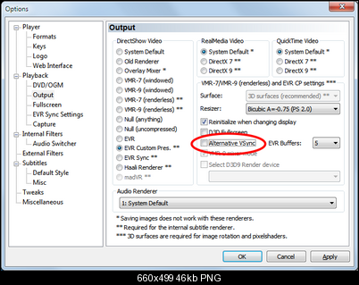

  3. If tearing is the problem, look for vertical sync options in the players. MPCHC for example:
    In VLC, try changing the output device. Tools -> Preferences -> Video -> Output.
    Another problem is that some graphics chips only support vertical sync on one output. You may be able to switch which display is the primary display in the graphics card's setup applet.
    [Attachment 9793 - Click to enlarge]
    Thanks--I wil work on this and post results tomorrow.
    Dec 2009
    Thailand
    "Another problem is that some graphics chips only support vertical sync on one output. You may be able to switch which display is the primary display in the graphics card's setup applet."
    Worked like a charm
    Thanks very much.
