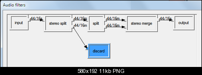

  4. VirtualDub can open VCD DAT files directly and alter the audio. You have to use it's advanced audio filtering to split the stereo track, discard the silent one, duplicate the remaining one, then merge the two tracks back to a stereo track:
    Select a video and audio compression codecs and save as AVI.
  5. Originally Posted by jagabo View Post
    [Attachment 9789 - Click to enlarge]
    Genious, thanks a millon. I will have a go.
    Or don't bother duplicating the track to make fake stereo, just have a mono track.
