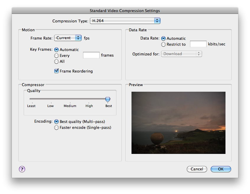

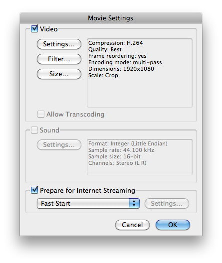

    Also as suggested by aedipuss on another topic (now closed, apologies to the moderator) here is a screenshot of my export settings
Name:	Screen shot 2011-11-29 at 22.03.45.png
Name:	Screen shot 2011-11-29 at 22.04.43.png
  24. aBigMeanie aedipuss's Avatar
    Oct 2005
    666th portal
    since you probably want pal, change the framerate to 25. and turn off frame reordering!
  25. Everything is fine in the screenshots. (In case you're wondering "frame reordering" has nothing to do with the order of the frames, it has to do with encoding frame order, which is different than display frame order, so unchecking it shouldn't make a difference)
