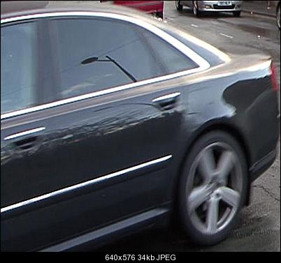

  14. Here's wcars2 after phase alignment and motion interpolation to 50p with this AviSynth script:
    Import("C:\Program Files (x86)\AviSynth 2.5\plugins\DoubleFPS2.avs")
    Mpeg2Source("wcars2.d2v", CPU=2)
    AssumeTFF()
    SeparateFields()
    Trim(1,0)
    Weave()
    DoubleFPS2()
    Of course, you would be better off getting the original 25i video.

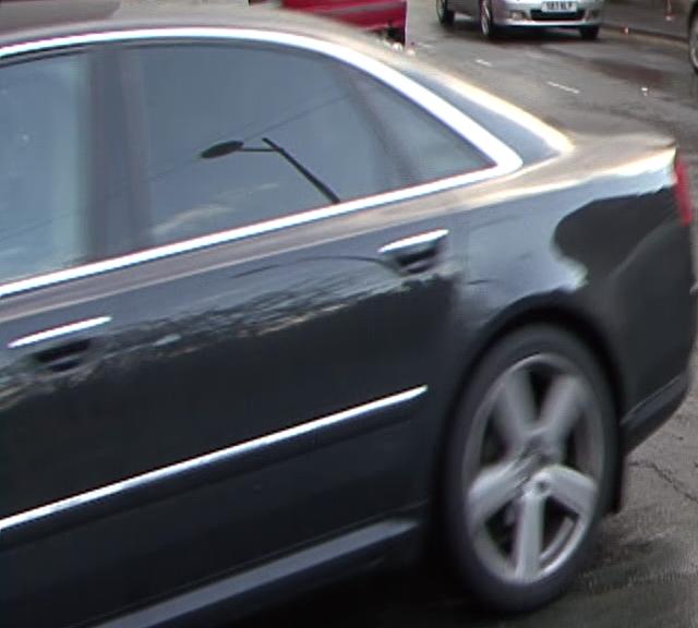

    It looks like it was originally 25i interlaced video that was deinterlaced poorly to create 25p then a field delay added and encoded interlaced. So half the vertical information is gone. This can be seen as jagged near-horizontal edges:
    That image was made by realigning the fields back to progressive frames with AviSynth:
    AssumeTFF()
    SeparateFields()
    Trim(1,0)
    Weave()
    You can do the same with VirtualDub's Field Delay filter.
