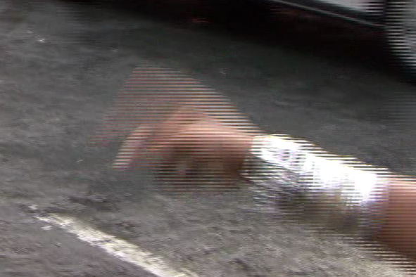

    something's severely mucked up. here is a vlc screenshot with de-interlacing turned off. i count part of 8 frames in this one field. count the number of index fingers.
    i shoot 30p with canon HV30 all the time and have never had any problem. both fields of a 25/30p frame are recorded at the same time so it really doesn't make any difference if it's called progressive, tff, or bff. when combined all of those create the same frame in the 50/60i stream.
