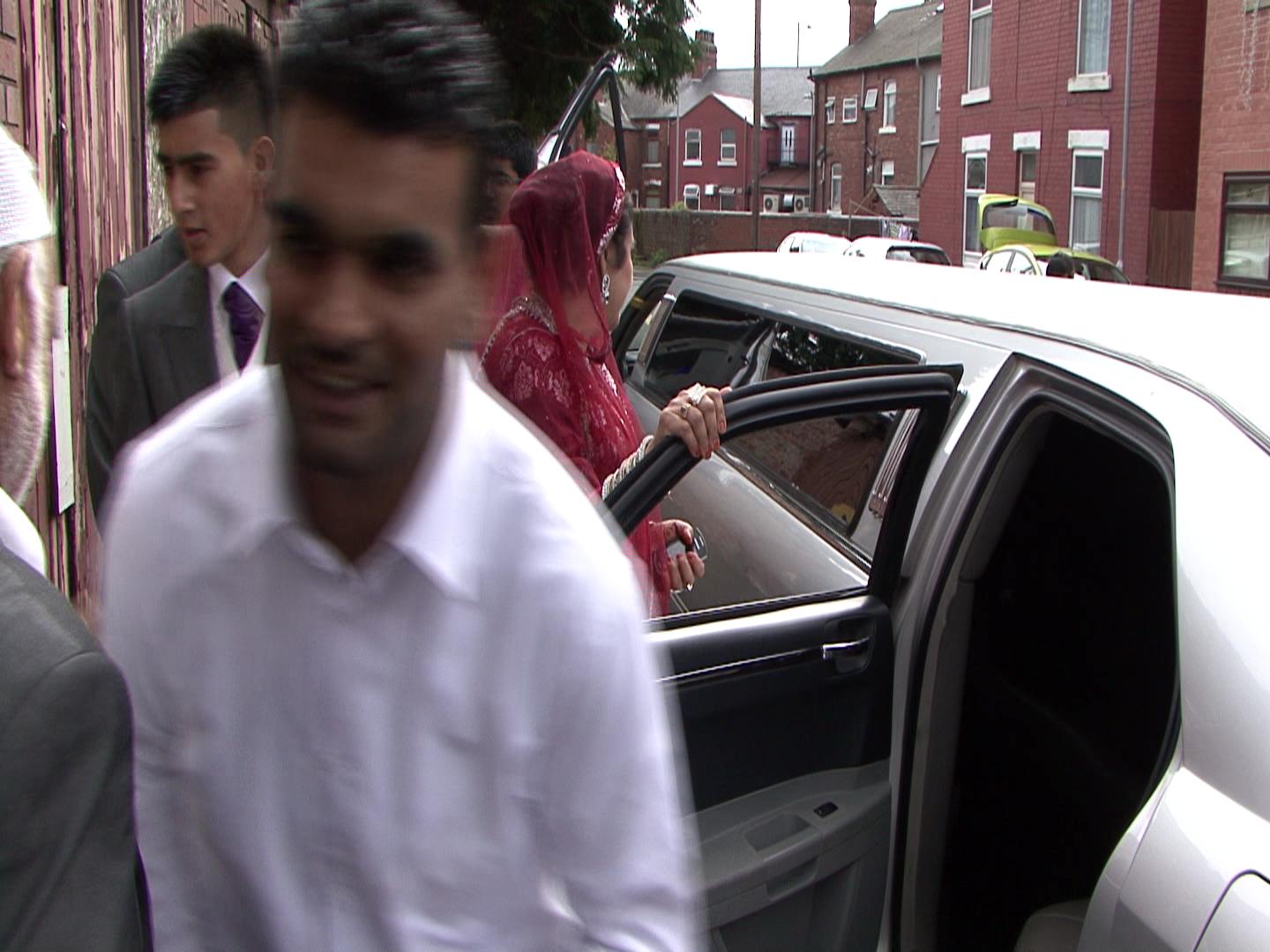

  8. Part of teh original mpeg2 file.
  9. Member edDV's Avatar
    Mar 2004
    Northern California, USA
    Classic blend deinterlace motion artifacts.

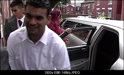

  14. The video at youtube was not blend deinterlaced. One field was discarded and the remaining field resized.

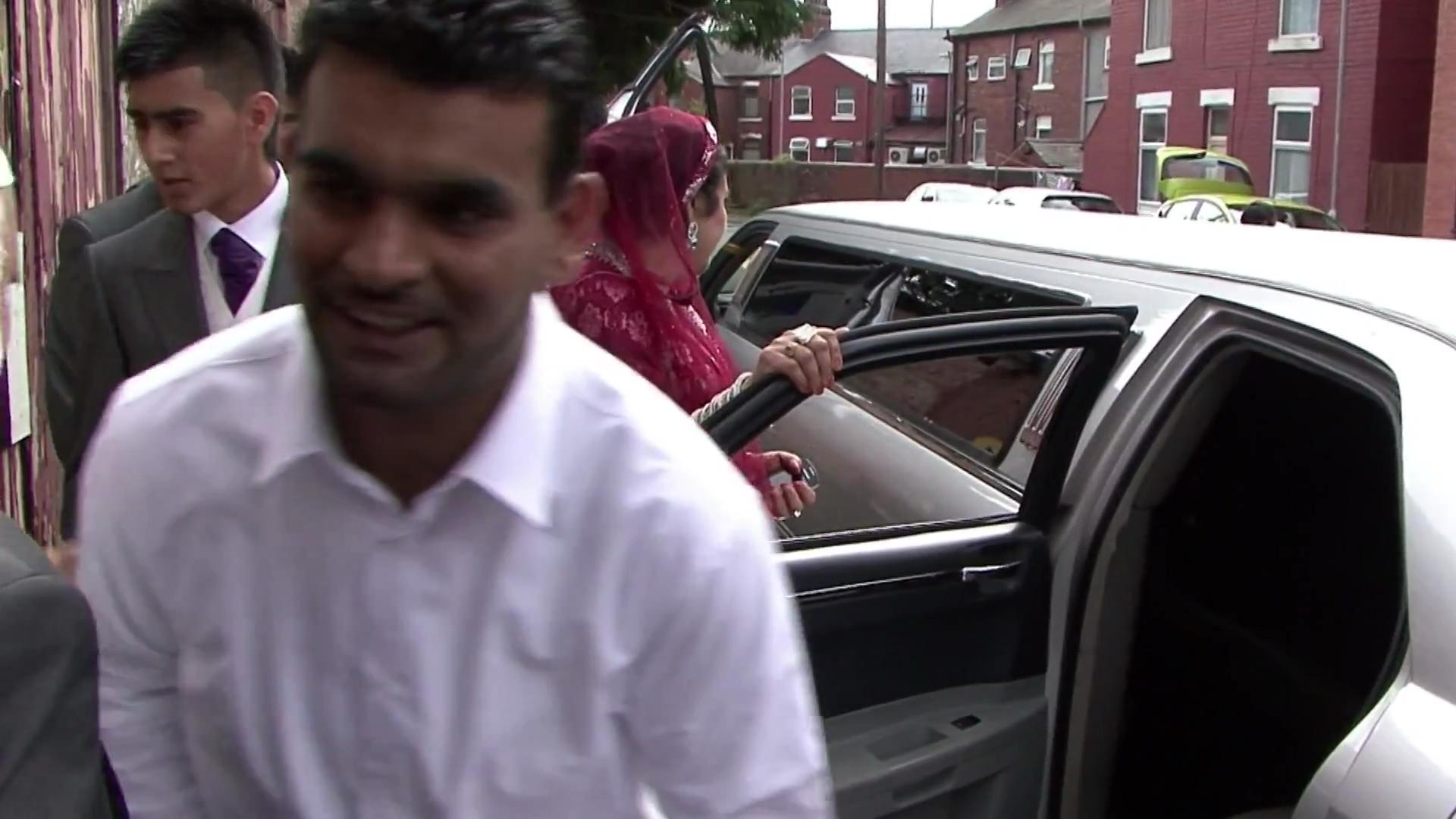

    I don't think youtube did anything to it. I think it just treated it as 29.97p, so adjacent fields are smashed together and treated as a frame
    The low bitrate and compression make it appear if a field resize was done, but you can see fine combing from consecutive fields on individual frames
    This is from the youtbe 1080p version (of course you have to view at full size):

  16. I only downloaded the 1080p version. It had no comb or blending artifacts when motions were large. But there is a bit when motions are small, like in your picture. That tells me it went through a smart deinterlacer like Yadif.

    The same frame from the original video with blend deinterlace in VirtualDub (not resized for AR):

  17. Originally Posted by jagabo View Post
    I think it's bitrate related. In high motion, the quantizer is too high to preserve the fine pattern. As a result, what you see is a blending of edges. If youtube allocated a higher bitrate, I bet you would see cleaner separation and the same pattern in the screenshot during higher motion areas
    EDIT: I'm going to take that back. jagabo I think your smart deinterlacer conclusion is correct. Unless youtube's encoder is really really poor, I cannot replicate the results using very poor settings at similar or even lower bitrates
