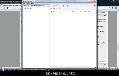

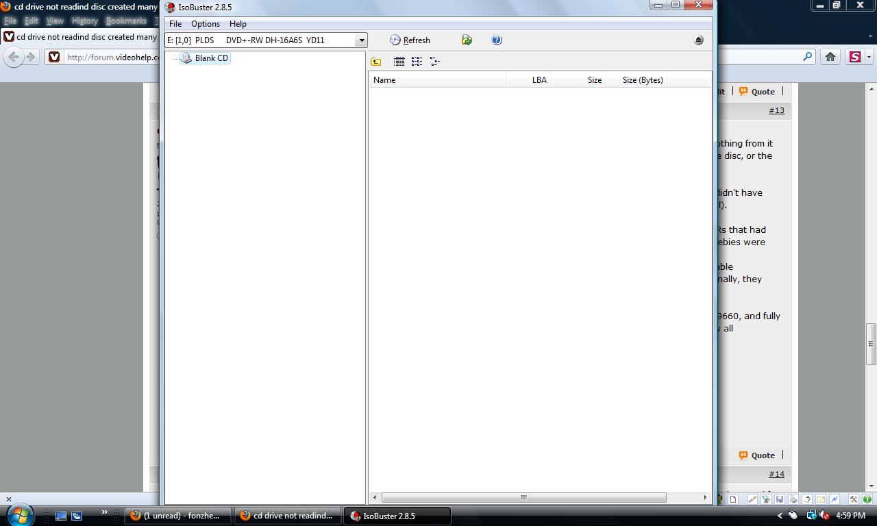

    When I load the cd, all that appears in the left pane shows "blank cd", when I right click on it, all options are shaded out, this is a mixed music cd I had purchased from a guy selling on the street.Click image for larger version

  16. Member Cornucopia's Avatar
    Quoted from ISOBuster's Helpfile (bold added by ME):
    Using IsoBuster is in fact easy. You just need to know a few things :
    • Scanning a CD / DVD / Image File layout and File-System(s) is done automatically, once the device is selected.
    • Actions are triggered by selecting an object (track, file, directory, ...) and clicking the right mouse button.
    • IsoBuster is many tools in one, don't let it confuse you. E.g. don't go creating an image file if you just want to recover data etc.
    When you select a drive or an image file, the CD / DVD in the drive or the image file will be scanned automatically. The content will be listed immediately, the session(s), track(s) and file-systems.
    If you don't see anything, it means IsoBuster could not detect anything or the device is still mounting the media. In case of the latter, wait till the media is mounted properly by the drive. In most cases you can monitor this by looking at the LED behavior of your CD/DVD/BD/HD DVD drive. There are cases when the CD / DVD / BD / HD DVD reader will not mount media anymore because it is beyond recognition ! If the drive doesn't mount the media, IsoBuster will of course also not be able to access the media.
    Ok, so we know that it's a burned CD. Could be -R, could be -RW. If it's -RW, it's possible the disc(s) somehow got erased. If it's -R, it's possible the dye was volatile enough (with exposure, etc) where the data "disappeared" like my crappy freebie discs, to the point where it can't even mount the disc. Who knows what quality of media this was...
    Since you seemed to get something with MPDR, why not try to "recover" at least that 1GB - just to see what's on there. If something IS on there, you can decide whether or not to buy the full version then. BTW, If this were a standard AudioCD, there would be NO reason to go beyond 747MB, as way, way back then the longest CDR was 74minutes (not 80, or 90, or 99).
    Afa ISOBuster is concerned, it could be you just need to give it time to fully mount. This has been known to sometimes take HOURS or even a DAY for extremely bad discs. Be patient, you want the data, don't you?
    Let us know what you find...
