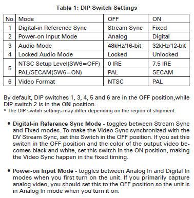

    Thanks for the tips. Apparently the DIP switch 1 setting is "Digital Reference Sync." The ON position is FIXED and the OFF position is "Stream Sync." So turned of the Stream Sync. I hope this makes sense.
    Thanks again

    Basic PAL settings for the ADVC-110 are
    5 OFF - PAL
    6 ON - PAL
    Others that are easy
    3 OFF - 48KHz/16bit audio should normally be used
    4 OFF - Locked audio is the normal mode to prevent audio sync drift
    That leaves switches 1 and 2
    The manual says for switch 1 start with OFF. If the video becomes black and white, turn the switch ON.
    The strange thing is switch 2 must be set OFF (Analog) or PAL is impossibe. This is different than my ADVC-100.
    http://www.pro-video.it/provideo-incorso/images/File/Canopus/ADVC110%20Manuale.pdf
