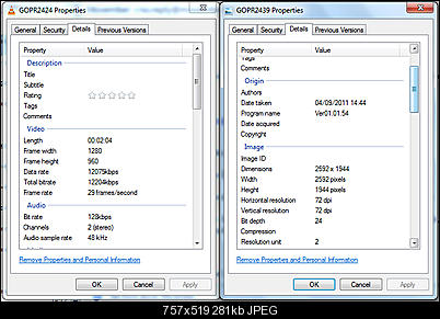

    I am after a simlar outcome to the timelapse videos when fullscreen is selected, or like GoPro have on their youtube channel (http://youtu.be/GUEZCxBcM78?hd=1).
    I think the issue I am having is the properties between the photos used for the time lapse and the videos are different. Click image for larger version

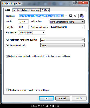

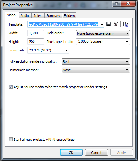

    These are the project settings I am using to process the video.

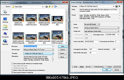

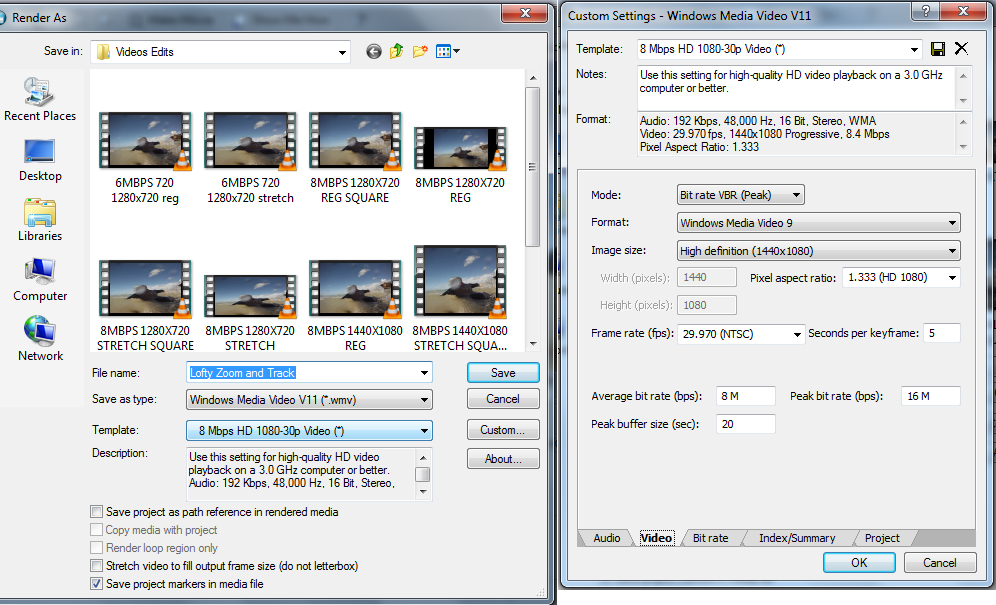

    And these are the render settings I am using, these are also what I used for the timelapse videos.

    I have tried to stretch to letter box size but it alters the video and everything is squeezed and look silly.
  5. But what kind of monitor resolution are you using ? If you have a 16:9 monitor, the footage for the go pro demo will fit 100% perfect. They resized that video to 1280x720 which is exactly 16:9 AR . On anything other than a 16:9 monitor, you will get black bars
    If your source videos are 1280x960 with square pixels, you will NEVER get it to fit in a 16:9 window without black bars without cropping or distorting the image
    Your export settings don't match your project settings, you are exporting 1440x1080 with PAR of 1.33 (non square pixels). On youtube this won't look right either
    Post mediainfo view=>text of the source files copy & paste back here

  9. As budwzr says, your source files are 1280x960 4:3 aspect ratio (square pixels)
    The youtube display is 16:9, as is your monitor
    You're trying to fit a 4:3 "box" in a 16:9 "rectangle" , so you will ALWAYS get pillarboxing
    The only way to avoid this (without distortion) is to crop off 240 pixels: 120 from the top, 120 from the bottom . Because (960-720)/2 =120
    When you export, use 1280x720 settings, that is a perfect 16:9 display. That's probably what the go pro demo used.
