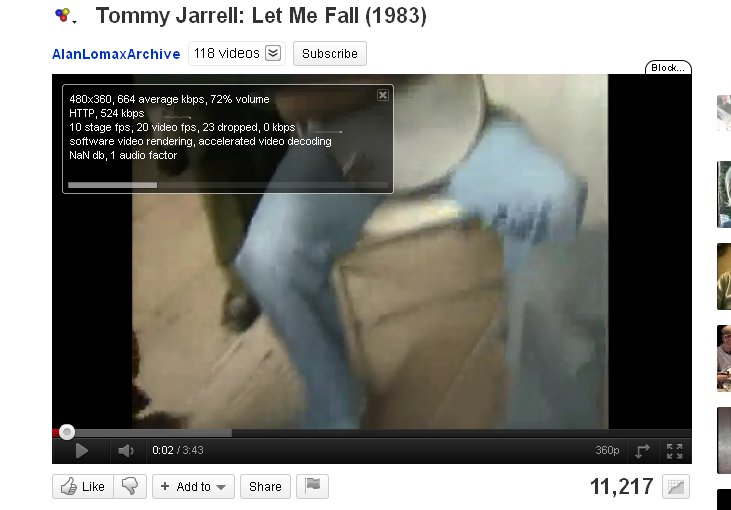

    I've seen it on many occasions, but in Youtube you can right click the video
    and select "show info" and you can see a count of dropped frames
    (not that you really need the count; it's obvious by the stuttering the frames are dropped)
    Some observations - Just moving the mouse around increases the count, but system resources in use seem low.
    For example, opening the task manager shows CPU usage at less than 15%.
    IT occurs even when the video is fully cached so you can't blame the network speed.
    Is Firefox to blame? Is it some how allocating extremely low priority to the Flash thread?

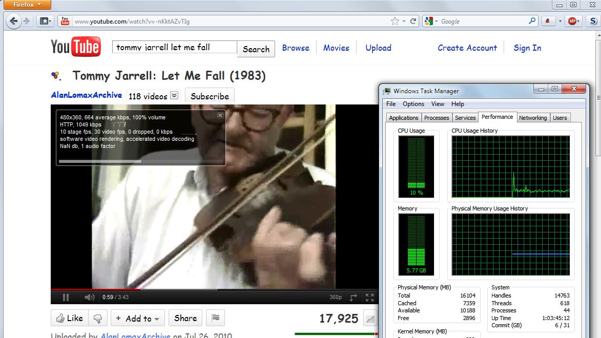

  4. One of my comptuers is an AMD Athlon 2 x2 255 system with a Nvidia 8600 GT. I get 0 frames dropped there too.Even with 720p videos. That system is running Firefox 7.0.1, 32bit XP SP3. The system I spoke of earlier was an i5 2500K with the built in Intel graphics, 64 bit Windows 7.
    I Occasionally get a few dropped frames when I switch to full screen or back, or if I start up some other program. But that's expected.
    When the player is windowed I get software rendering. When it's full screen I get accelerated rendering.

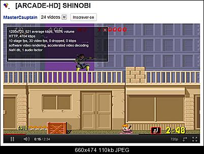

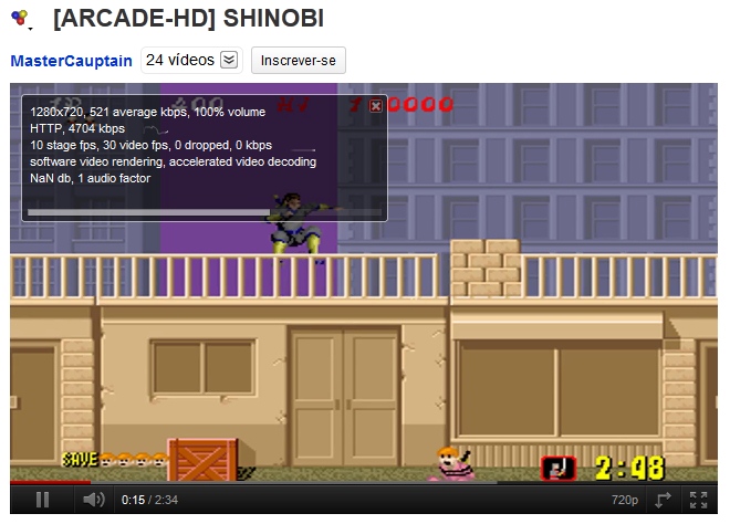

  7. Lone soldier Cauptain's Avatar
    Jan 2006
    Brazil
    I'm using Firefox 8. I always see 0 frames dropped. Be sure you have hardware acceleration enabled on the Advanced tab of the Options dialog.
    Firefox 8 here too...No dropped frame at 720p.
