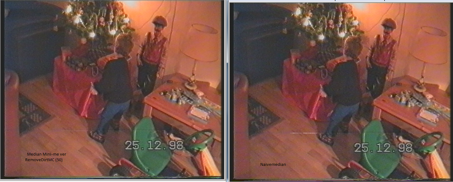

  15. I thought I'd contribute a little something here:
    Like jmac, I heavily rely on performing medians of multiple captures in order to get "exactly what's on the tape, no more, no less...assuming the VCR has enough bandwidth and doesn't use DNR or sharpening, etc." However, I've recently discovered that there's a way to "stack the deck" against noise and cheat a little bit, and I've gotten excellent results from it.
    # Load captures
    try1 = Avisource("1.avi")
    try2 = Avisource("2.avi")
    try3 = Avisource("3.avi")
    # Align captures temporally
    try1 = try1#.Trim2(whatever)  # See http://avisynth.org/stickboy/jdl-util.avsi
    try2 = try2#.Trim2(whatever)
    try3 = try3#.Trim2(whatever)
    # Test alignment:  Scan through interleaved or stacked output to see if captures stay aligned, and fix
    # them here if they get out of sync.  No matter what TBC or capture settings you use, this is likely to
    # happen if you have long stretches of the tape between scenes with unrecorded/garbage material.
    # return Interleaved(try1, try2, try3)
    # Create spatial medians, but beware artifacts from interlacing (or from coarsely spaced lines with separated fields):
    try1spatialmedian = try1.QTGMC(preset = "super fast", lossless = 1).RemoveGrain(mode = 4).Reinterlace()
    try2spatialmedian = try2.QTGMC(preset = "super fast", lossless = 1).RemoveGrain(mode = 4).Reinterlace()
    try3spatialmedian = try3.QTGMC(preset = "super fast", lossless = 1).RemoveGrain(mode = 4).Reinterlace()
    # Create three medians, each using two real captures and one spatial median.
    # Personally I renamed Median1 to MedianOf3 for clarity, but I'll use Median1 here
    # to emphasize that it's the same function.
    median12 = Median1(try1, try2, try3spatialmedian)
    median13 = Median1(try1, try2spatialmedian, try3)
    median23 = Median1(try1spatialmedian, try2, try3)
    # Create a final median.
    median = Median1(median12, median13, median23)
    # Return!
    return median
    # Helper function:
    function Reinterlace(clip c)
        # If you have a BFF source, you will have to replace some or all
        # of the AssumeTFF calls with AssumeBFF.  I haven't really thought
        # the differences through though.  A well-formatted function
        # would take the field parity from the original interlaced clip,
        # but that may make usage more complicated.
        evens = c.SelectEven.AssumeTFF.SeparateFields.SelectEven()
        odds = c.SelectOdd.AssumeTFF.SeparateFields.SelectOdd()
        return Interleave(evens, odds).AssumeTFF.Weave()
    The idea is as follows:
    Each of the initial medians use two real captures and a spatial median of another capture. The spatial median serves as a baseline for what the underlying image would look like without detail or noise. It's a quick and dirty way of saying, "Look, pretend for a moment that all high-frequency content is just noise. If it is, what should the underlying image probably look like?" If the other two captures are noisy enough to have pixels on opposite sides of the spatial median, the spatial median is used. (Basically, the initial medians use the spatial median of one capture, clamped within the actual values of the other two captures.) This greatly clamps down on high-frequency noise in flat areas. If the real captures "agree" on the detail or noise, then the softer version of each particular detail pixel (the one closer to the median) will be used.
    You generally do NOT want to use the initial medians directly: Not only does the process create a slight bias toward softening of detail, but a median of try1, try2, and try3's spatial median will completely throw out any fine detail shared by try1 and try3 but not try2 (for example). It will also give strange results in cases where one or more captures "glitch" on a particular frame with tons of dropouts or a huge vertical shift or something similar, and it can overuse the spatial median when the other two captures have different levels.
    Instead, the trick here is that doing this process three times helps eliminate the corner cases, and it helps recover the detail that you would get with a naive median of three captures. The detail will be slightly softer, but generally speaking it should all be there. At the same time, this reduces more noise and converges more quickly toward what's "actually on the tape" than naive medians of multiple captures. The basic algorithm works something like this: "Use the spatial median closest to the actual median of three captures, but clamp it to the pixel range defined by the three captures themselves." I kind of expected this to soften detail considerably, but in practice, it looks great...and this isn't from a casual viewing perspective but from the standpoint of interleaving the final frames with the original captures, zooming in, and scrutinizing them closely.
    This method is very slow, but it should often be faster and more manageable than capturing a tape five, seven or nine times and taking a median of all of them. I can also sometimes get better results using three captures with this method than I can get using nine captures with a naive median! I should note that I'm a detail fanatic, by the way: I'm creating "digital intermediates" and archiving them, and I wouldn't dare DREAM of directly using a "real denoiser" like Neatvideo on a single clip until I'm creating distribution copies from those.
    I used a spatial median above, but you can apply the above principle to any form of denoising, however harsh or sophisticated. However, using Neatvideo or something similar three times is going to get extremely slow...and simply denoising a single capture and limiting the result by the other two is risky and can produce artifacts if your captures have vertical jitter, different luma levels, etc.

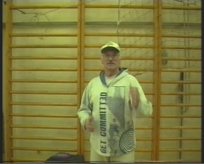

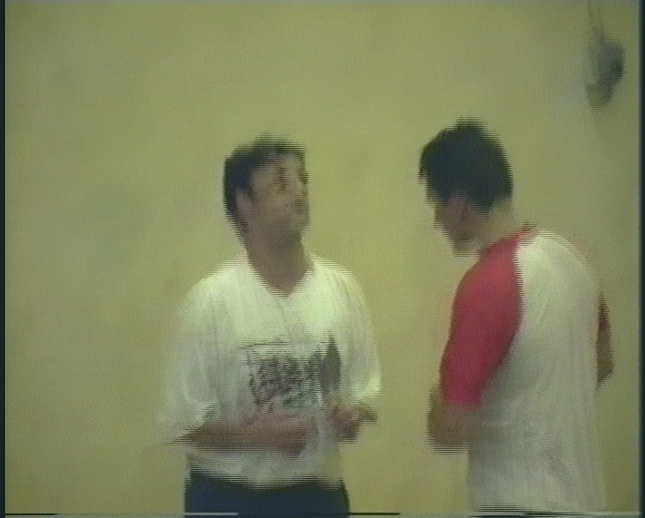

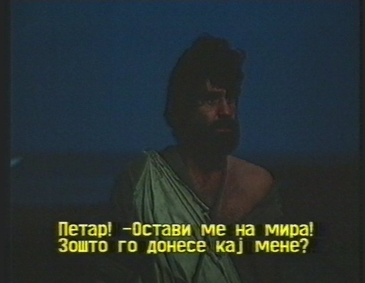

  21. Thanks Mini-Me for the explanations I will experiment with McTemporaldenoise to see how it goes.
    I usually use the median function for capturing 8mm tapes from camera composite (doesn't have svideo) > DVD recorder Es15 or other pany of mine and then from there with svideo to capture card Averemedia Trinity. My camera has worn out heads so it produces allot of thin drop outs and some glitches the tbc from dvd rec keeps the frames from dropping and stables the picture no waviness.
    Yesterday i had some tape and I recorded 3 times to use median ( and your script), i had very difficult time of aligning the 3 captures, it seemed that on places that look like same frame for all captures had different frame count in the end ( so something must gone wrong)
    Can it be that I am trying to align longer videos around 90 min that i have this issues.
    After i did make them same frame count and on the same spot i got some weird artifacts ( with median1 and with your script )
    could it be from longer videos ( because some of the scenes don't have artifacts only on certain frames) or from not align good
    the first 2 pictures are from your script and naive median and the third is with artifacts on the same videos

  22. Originally Posted by mammo1789 View Post
    Ugh...not good. You might be in for some real misery here. Using median filters across multiple clips only works when every single frame is perfectly aligned for each capture...but it looks like your captures are dropping or inserting frames in places. Even if your videos line up in one area, dropped or inserted frames later on will make them lose synchronization with each other, and they'll usually get worse and worse as the videos go on.
    If you align the beginning of your videos, how many frames are they usually off by toward the end? If you only have to deal with a few videos, and they're only off by a few frames, you could just interleave your captures in Avisynth, preview with Virtualdub, and search through to find the first frame where one of your captures differs. (I've done this a LOT throughout the past year, and I roughly approach it from the standpoint of a binary search instead of stepping through by just 1/50/etc. frames at a time.) As soon as you find out which capture dropped or inserted a frame and where, you can insert or remove a frame in that same spot to compensate...then preview again and find the next spot where a capture dropped or inserted a frame, then fix it again. Keep doing this until you've reached the end of your videos, and you'll eventually have all three aligned all the way through.
    I did things manually like that with my EP VHS tapes, because the captures were occasionally inserting a frame at random every hour or so. (For the record, these inserts did not show up in Virtualdub's statistics, because it wasn't Virtualdub inserting the frames. They were being inserted earlier in the chain by my TBC.) It created a lot of work for me, but it was manageable. The typical advice here is to get a TBC to fix this kind of thing, and this will help a HUGE amount if your VCR is just putting out a weak sync signal that your capture card isn't locking onto correctly. However, in your case, your ES-15 should probably be doing a good enough job in that area, so lack of a TBC is probably not your problem. In my case no TBC could have helped (and in fact, I was using a pretty good one already), because I think the VCR I was using was running ever-so-slightly slow. Full-frame TBC's and frame synchronizers can ensure your capture card receives frames in sync with a consistent clock, but they have no effect over the playback speed of your VCR, so if it's running slow, your TBC will eventually have to insert a duplicated frame while it's waiting for input...and if your VCR is running fast, your TBC will eventually have to drop a frame once its memory has been exceeded. Some TBC's are better and more reliable than others due to having more memory or having more graceful behavior when things go wrong, but none of them can fully correct for a deck that's playing at the wrong speed.
    Recently, I've been dealing with a problem that's even worse: I've been trying to match the video from one capture (taken with one VCR) to the audio of another capture (taken with another VCR), and it's hell. My video deck for SP tapes is a Sony SVO-5800, and its built-in TBC is dead-on frame accurate. As long as I set my Virtualdub settings correctly (more on that later), capturing with the SVO-5800 never inserts frames, and it will only occasionally drop a frame when playing back static (unrecorded tape) between scenes. I use it due to its excellent TBC and video quality for SP tapes...but its audio is extremely noisy and has unreliable levels for my old home movies (pro deck weren't meant for playing those back). I could play back my tapes with any old deck for better audio, except many are recorded in linear stereo, and there are VERY few VCR's with such a rare feature. As a result, I have to capture my linear stereo audio with an old Sears SR-2000 from the 1980's. Unfortunately, that deck will never EVER give me reliably frame-accurate output, no matter what TBC I use, and I've tried a bunch.
    Virtualdub resamples the Sears audio to sync up with the Sears video while it's capturing, so all I have to do is align the video from both VCR's to have the audio aligned too...but there are just SO many frame drops that manually aligning the videos is unacceptably time-consuming. I get the least frame drops when I use my Philips DVDR3475 as a passthrough TBC, but they come somewhat sporadically, and sometimes they come in "sprees" where the capture will drop several in a row. That's not particularly good for audio quality given the resampling Virtualdub performs to maintain synchronization, so I've actually taken to using my AVT-8710 as my TBC instead (which I never found useful for anything else before). It results in more frame drops, but they're usually more consistently spaced throughout the video (like one every 10000-15000 frames), so I can just align the beginning of my Sears capture to my Sony capture, count how many frames they're off by at the very end (e.g. 20), then stretch the Sears audio appropriately with SoX resampling to match the Sony SVO-5800 video. It sounds like a pain, and it is, but it's much less stressful than manually aligning multiple captures by finding the exact frame where they get out of sync and inserting or removing frames to compensate.
    So...what lessons can you learn from this? Sometimes you have to manually align captures and keep them aligned by removing duplicated frames and inserting frames to compensate for drops during capture...but it's a huge pain in the butt, so it's probably worthwhile to find a better way. If you have the "right" VCR and the right Virtualdub settings, you will get consistent captures every time, so let's start with setting up your Virtualdub settings right (I'm assuming you're using Virtualdub for capture):
    Go into Capture mode and open up the "Capture" menu, then "Timing..." The ONLY box that should be checked should be "Correct video timing for fewer frame drops/inserts," and the resync mode should be "Sync audio to video by resampling the audio to a faster or slower rate," and the audio latency determination should be "Automatic." All the other boxes should be unchecked. These recommendations differ from Virtualdub's defaults.
    Using those recommendations, a lot of VCR's will give you perfectly frame-accurate captures, especially if you use a full-frame TBC or a DVD recorder with a frame synchronizer (I believe your ES-15 probably has a decent one, though someone can correct me if I'm wrong here; I've never used it). If your VCR plays at the right speed and your TBC can lock onto its signal, you should only have to align the beginning of your captures for every frame to be aligned for a median.
    My problem comes from the fact that I'm trying to capture linear stereo audio, and it's a very rare feature that's only present on pro decks (which have terrible audio for my home movies) and old 1980's premium consumer decks (which do not play back tapes at precisely the correct speed). You shouldn't have this problem: In your case, hopefully your current VCR will produce consistently frame-accurate results with the above Virtualdub settings. If it doesn't, it might be worth experimenting with other VCR's, unless the one you're using has much better quality in some other area that's important to you. If that's the case, you might be stuck with the life-consuming drudgery of manually aligning your captures and compensating for dropped/inserted frames.
    I really hope you can get this working without too many problems, because I know exactly how frustrating frame drop problems can be when you're trying to align multiple captures. Once you get all this solved, I'd definitely encourage you to play with MCTemporalDenoise or RemoveNoiseMC instead of RemoveGrain(mode = 4) in the above script, because the first two images you showed are way too similar to justify using my time-consuming filter over a naive median.

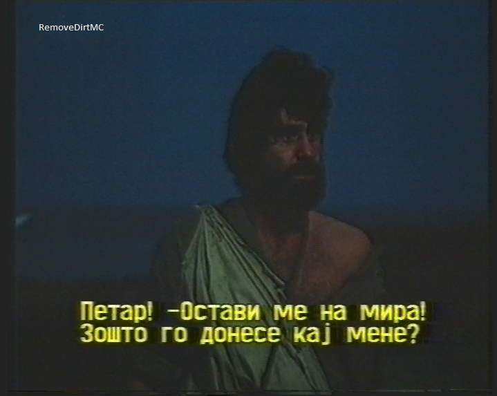

  23. Thanks Mini-Me I will try later with the 8mm setup ( wich produces a lot of thin lines drop outs ) to see how it goes. I wondered if i use ( in my case it was on i put it off) progressive in dvd recorder and passtrough it ( that he might do some deinterlacing in passtrough so that can screw the fields order that i was getting or maybe I am wrong.
    I tried with my oldest vcr JVC HR-D211EM regular vcr mono trough es15 ( by the way I align them perfectly this time immediately) to see how it will go with MCtemporaldenoise instead and here it is the result notice how noise is suppressed more with this script ( to justify the work ) but it is slooow as hell 0,08 fps for 3 min video it took almost 2 hours.
    The result looks much cleaner i couldn't see some loosing of details but might be wrong.
    It seems that this can be ultimately noise reduction
    The last picture is naive median it seems that it only helpfull for drop outs and this script does aditional noise reduction due to using mctemporaldenoise ( or removegrain in your case ) i will try with removedirtmc

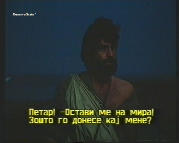

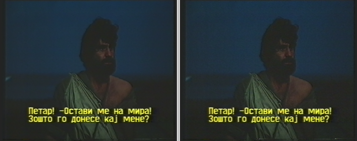

  24. I tried again the script median (mini-me) with RemoveDirtMc but on tape that had some more nasty drop outs
    the script runs around 3 fps ( faster than mctemporaldenoise alone and slower than removegrain version ).
    I didn't notice too much softening ( do it has some ) what do you think it seems better than naive median

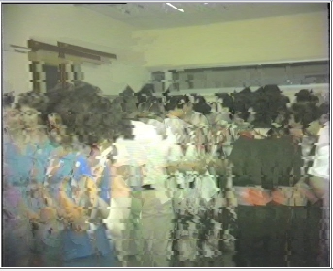

  25. There are many cases in which the filter is doing damage to the video.
    For example:
    [Attachment 17141 - Click to enlarge]
    Is there a way to solve it?
    I use Median1-function (3 caps)
    If I will use in five cap so that fewer would occur?
    I sync the videos right ..
    I tested it with the Subtract (cap1, cap2) .. Subtract (cap1, cap3)
    Everything fits ..
    I have to go through the whole video and replace frames. With ReplaceFramesSimple ..
    It's a nightmare.
    Is there a way to make a log file which contains all the frames that this function worked on them?
