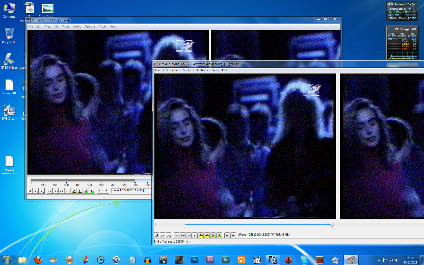

    Can anyone suggest on how to prepare these identical caps, i.e. how to make all copies begin from the same frame?

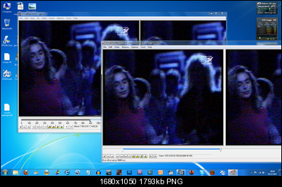

  3. Click image for larger version
    The easiest way is opening one instance of virtualdub and one of virtualdubmod put them side by side and by eye look for first frame to last ( at least thats how i do it ) compare source 1 to source 2 then source 1 to source 3 and so on. I think jagabo has some approach trough avysinth you can try that also. By the way i captured 5 times very noisier record from 1990 MTV channel with a lot of analog broadcast noise because of the reception so i will try how the median and blending approach will keep up with it.I captured in windows 7 intentionally that way i can't use the pc card proc amp controls (levels) in vdub while capturing so i get original from vhs tape. The source vcr ag1980 trough dvd recorder es15 to pc card pinnacle 110i. game booster on ( so it will help stop the interference from other programs while capturing ) Will it going to be irrelevant because the noise from the source is bigger than the noise from the equipment let see

    Thank you for your reply. After a bit of fiddling with VirtualDub I figured out that aligning 3 clips is not as scary as it sounds.

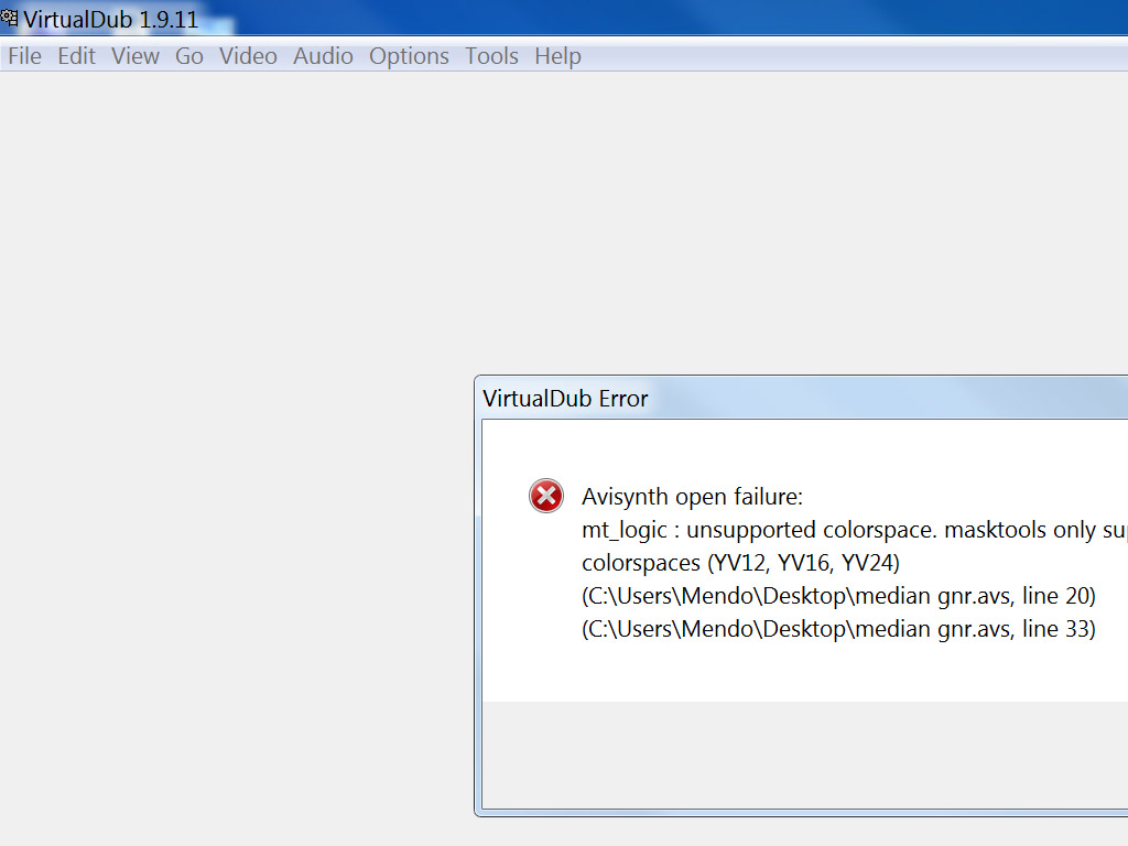

  5. BTW did you make the median function work?
    Nope I just tried the blend one and as I suspected the difference is none. Probably the quality of hardware has to do with it when i post those samples that had difference earlier were from analog 8mm camera Samsung( nothing special) and probably the playing path put some noise which is evident in the example however with Panasonic svhs i captured 3 different materials video ( 5 times each one ) and i didn't noticed any noise reduction so i must conclude that the blending technique is well suited for less quality equipment ( people with bad vcr players can try these and trough some camera ro dvd recorder to act them as tbc other wise not) Median script is giving me error
    the script
    v1=AviSource("E:\New folder (3)\gnr top.avi")
    v2=AviSource("E:\New folder (3)\gnr2 top.avi")
    v3=AviSource("E:\New folder (3)\gnr3 top.avi")
    v4=AviSource("E:\New folder (3)\gnr4 top.avi")
    v5=AviSource("E:\New folder (3)\gnr5 top.avi")
    #Median2-function that gives median of 5 clips:
    Function Median2(clip "input_1", clip "input_2", clip "input_3", clip "input_4", clip "input_5", string "chroma")
    {# median of 5 clips from Helpers.avs by G-force
    chroma = default(chroma,"process") #default is "process". Alternates: "copy first" or "copy second"
    #MEDIAN(i1,i3,i5)
    Interleave(input_1,input_3,input_5)
    chroma == "process" ? Clense(reduceflicker=false) : Clense(reduceflicker=false,grey=true)
    m1 = selectevery(3,1)
    #MAX(MIN(i1,i3,i5),i2)
    m2 = input_1.MT_Logic(input_3,"min",chroma=chroma).MT_L ogic(input_5,"min",chroma=chroma).MT_Logic(input_2 ,"max",chroma=chroma)
    #MIN(MAX(i1,i3,i5),i4)
    m3 = input_1.MT_Logic(input_3,"max",chroma=chroma).MT_L ogic(input_5,"max",chroma=chroma).MT_Logic(input_4 ,"min",chroma=chroma)
    Interleave(m1,m2,m3)
    selectevery(3,1)
    chroma == "copy first" ? last.MergeChroma(input_1) : chroma == "copy second" ? last.MergeChroma(input_2) : last
    Return(last)

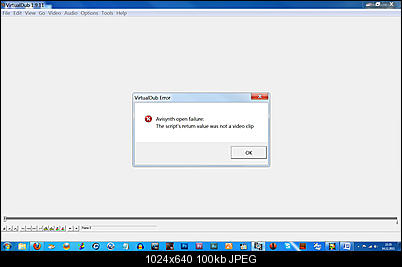

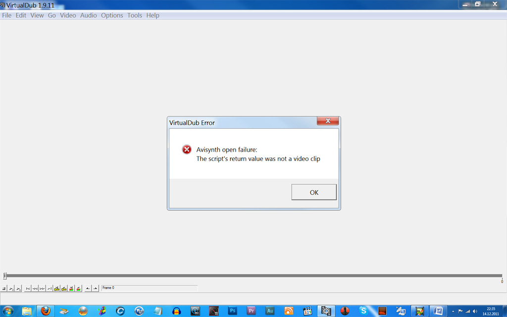

  6. You're not actually using it. What's it called, Median2? If so, then maybe try this (unless and until Gavino shows up to correct me) . Add it after the last line of the script you showed above:
    Median2(V1,V2,V3,V4,V5)
    I think it also relies on some other filters, but you should (might?) get a different error message next time.
    Dec 2011
    Russia
    Median2, apparently, requires MaskTools plugin be preloaded and something else to source Clense from.
  8. Clense requires RemoveGrainT and maybe RemoveGrain also. Its use is explained in the RemoveGrain 1.0 doc. I think, not having used it in awhile, so I'm a little hazy on the details:
    You're quite right manono.
    I told him that 10 days ago in post #60.
  10. You're not actually using it. What's it called, Median2? If so, then maybe try this (unless and until Gavino shows up to correct me) . Add it after the last line of the script you showed above:
    Thanks manono
    I have all of the plugins possible including masktools and remove grain t removegrain and many others ( weakness of avisynth- not bashing that's why i don't like it very much its confusing some times and not to much transparent )

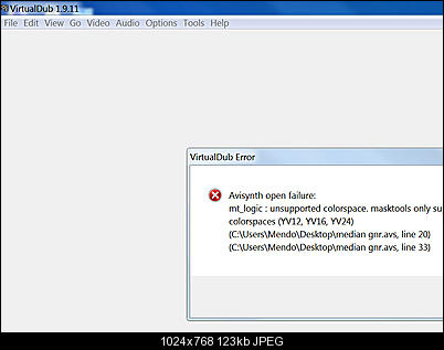

    thanks gavino i didn't understand where exactly in the script my bad
    no i have another error concerning yuv the files are yuv2 lagarith should i convert them in yuv12 ?

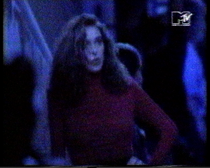

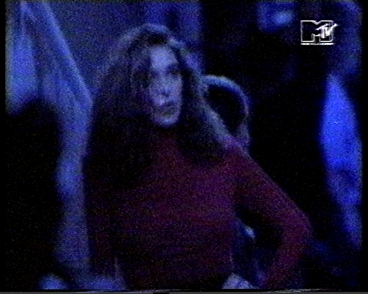

  12. Click image for larger version
Name:	vague denoiser remove median.png
ID:	10104Click image for larger version
Name:	cnr 2 avisynth.png
    cnr 2 vs (cnr2 vague denoiser degrainmedian fft3dgpu and unsharpmask)

    You mean YV12 and the answer's 'yes'. Try doing it like this:
    v1=AviSource("E:\New folder (3)\gnr top.avi").ConvertToYV12(Interlaced=true)
    to each of your AviSource lines

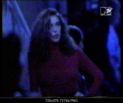

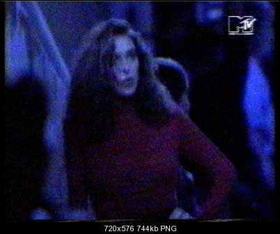

  15. Click image for larger version
ID:	10107Click image for larger version
    original vs median 5 approach. I don't see any difference what so ever ( zoomed in between blend 4 and median 5 approach )
    Only neatvideo get rid of all the chroma and a lot of grain noise ( although with little smoothing )

  19. masktools supports YV16 and YV24, they are planar formats for YUV 4:2:2 , 4:4:4 . But you need avisynth 2.6.x for YV16 or YV24
    ConvertToYV16(interlaced=true)
    But as manono says, considering the source quality , I wouldn't bother

    Originally Posted by jmac698 View Post
    I would never recommend using converttoyv12. Instead, resize each input clip to double the height, then convert to yv12. This way is completely lossless.
    v1=avisource("..")
    v1=v1.pointresize(v1.width, v1.height*2).converttoyv12
    at the end,
    median3(v1,v2,v3).converttoyuy2.pointresize(v1.wid th,v1.height/2)
    And you have full precision yuy2.
    The conversion to YV12 is lossless, but the conversion back at the end is not (and is equivalent to a chroma shift).
    The steps at the end need to be:
    median1(v1,v2,v3)
    u = UToY().ConvertToYUY2()
    v = VToY().ConvertToYUY2()
    YToUV(u, v, ConvertToYUY2().PointResize(width,height/2))
    (I've also changed the function name to median1 to match the function you supplied in post #27.)
  30. Thanks G! I see you are avoiding the chroma resizer, I guess the reason is the implicit chroma offset. What is the assumed chroma placement and what style (mpg2, dv etc.) does it correspond to?
    I still don't find this obvious to find in the documentation. I usually ignore chroma, not a good practice of course. I think we need meta data per clip for chroma placement that's set on sourcing.
