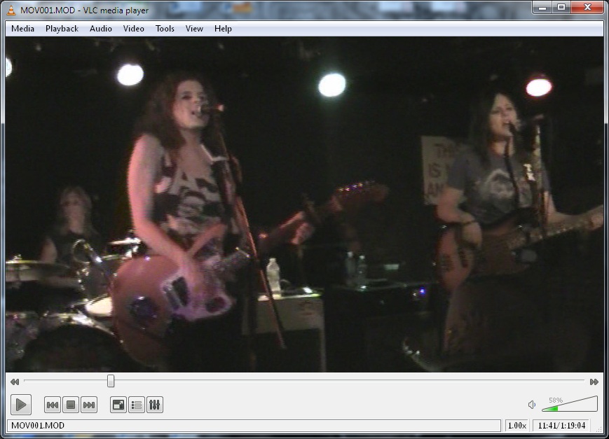

    This video is shot in 16:9 format and the .mod file plays back properly on my computer with VLC as 16:9, yet when I check, G-Spot says its 4:3. There definitely is some info in the header that says it 4:3, so how the heck does VLC know to play it back properly as 16:9 ?? I am very puzzled by this.

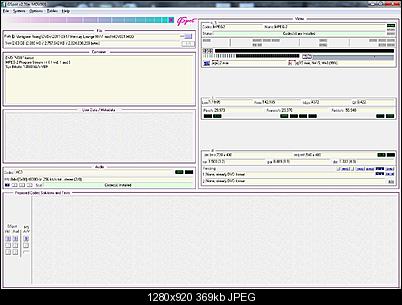

    Here is the screen cap from G-Spot saying the .mod file is 4:3:

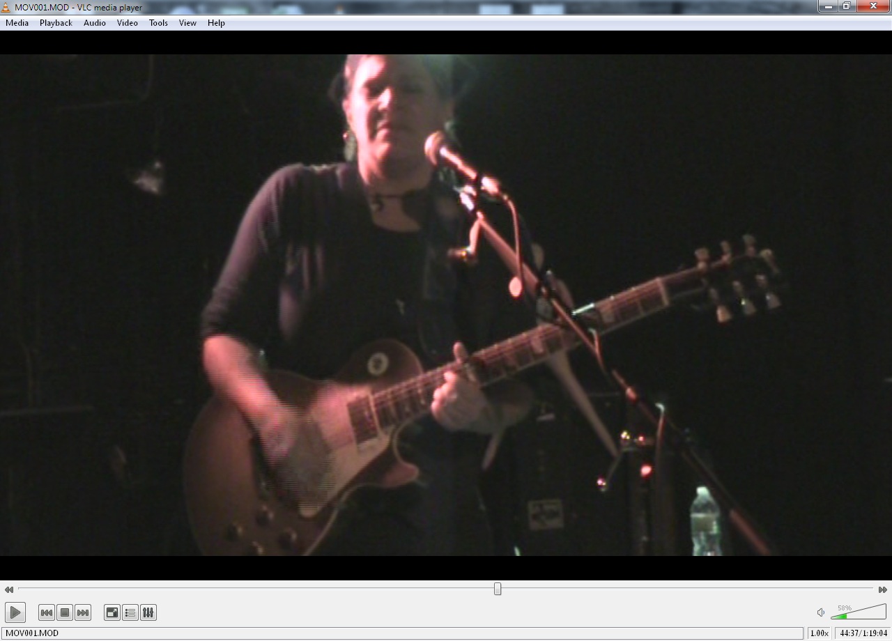

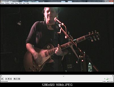

    and here is a screen cap from VLC playing back that same file as 16:9, which is how it should look:

    When I try to do a re-encode it comes out all squished side to as 4:3. Obviouly the encoder is paying attention to the info in the file header that says its 4:3. I can easily correct for this by using DVDPatcher to make a change in the file header before the re-encode takes place to say it 16:9. Problem solved.
    My question is if original file has the wrong info in it out of the camera - how in the world is VLC able to tell its 16:9 and correct for that on playback?? What is VLC seeing that the encoder and G-spot are not?

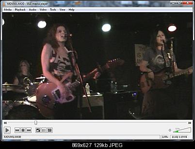

    Thanks for your reply, but I don't think that is it. Here is a picture of what it looks like when I first open this in VLC without going to full screen mode:

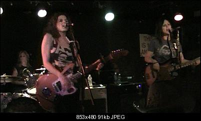

    And this is what the picture looks like when I use the "snapshot" funtion within VLC for that same exact frame of the video - no black bars (853/480 = 1.777, same as 16:9):
Name:	VLC 16-9 screen pic.jpg

  12. I happen to have a .MOD file in my collection of odds and ends. GSpot reports the aspect ratio is flagged as 4:3. But it also shows the video has a sequence_display_extension that indicates the flagged 4:3 picture is contained in a 540x480 sub portion of the 720x480 frame. That means the full 720x480 frame contains a 16:9 video (1.333 * 720 / 540 = 1.778). So GSpot is partially correct. The pixel aspect ratio should be reported as 32:27, not 8:9.
