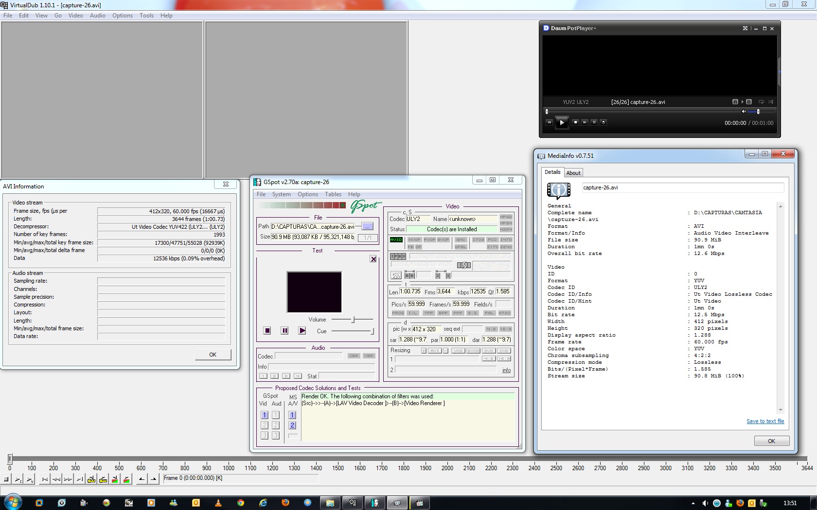

    Hello guys,
    I have a very strange problem.
    Fact : Video was recorded using Camtasia and UT VIDEO CODEC using ULY2 option (YUV422)
    Problem: My players not works (WMC-HC, POTPLAYER, KMPLAYER), No Virtualdub (gray screen) or VideoLAN (han) or Smplayer (No play).
    Can anyone give me a light?
    With UT CODEC installed - Video FourCC is=CLJR ( look here:
    Without
    UT CODEC installed - Video FourCC is= ULY2
    How to solve this?

  2. 64 bit vs 32 bit? VFW vs Directshow?
  3. Lone soldier Cauptain's Avatar
    Jan 2006
    Brazil
    UT Video codes are VFW codecs. You need DirectShow codecs to play in media players.
    I have DS codecs Jagabo but no way. Other files using UT VIDEO works, but the dimension is 720p or 480p.
    I try various camtasia records...All files have same problem (412x320x60fps). Camtasia no report error.
    Tks for reply.
    PS: I will upload file.

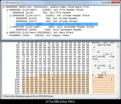

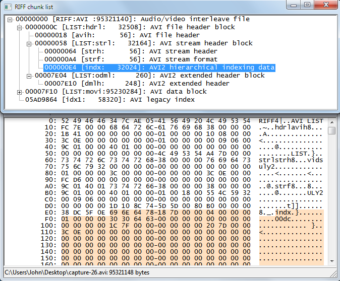

  8. Actually, it's not a palette index. But there's an extra "indx" which I don't usually see in AVI files.
    VirtualDub's hex editor has a hand RIFF Chunk Tree view:
