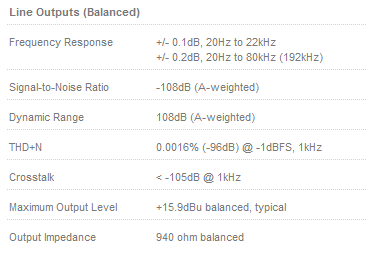

    Got it. The M-Audio 610 is a nice box. It can probably do a mono mix without using the Y cable. In analog mode it outputs balanced 600 ohm line level which is good for a couple hundred feet.
    The Canon HV30 requires unbalanced high impedance mic level.
    The most elegant solution would be a Beachtek DXA-2T at the camcorder. This could also be used to connect your mics directly for field shooting.

    Profire 650 out line level (balanced) to DXA-2T (switched to line level in). Then the DXA-2T feeds the HV30 at mic level (unbalanced). USB/Firewire not used unless you want to record an audio track backup to a PC.
