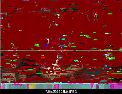

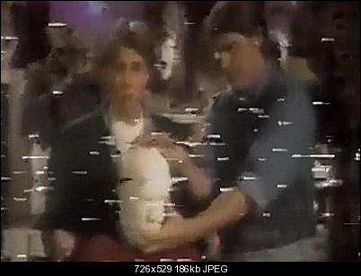

    How can I automatic remove those white spots from a VHS captured movie? I tried after effects film fix and virtual dub spots remover but they can't see those as scratches. Then I tried the filter pops.vdf and it can see those as scratches in debug mode but it doesn't have a fine tune action like after effects has and it can't remove all the spots.

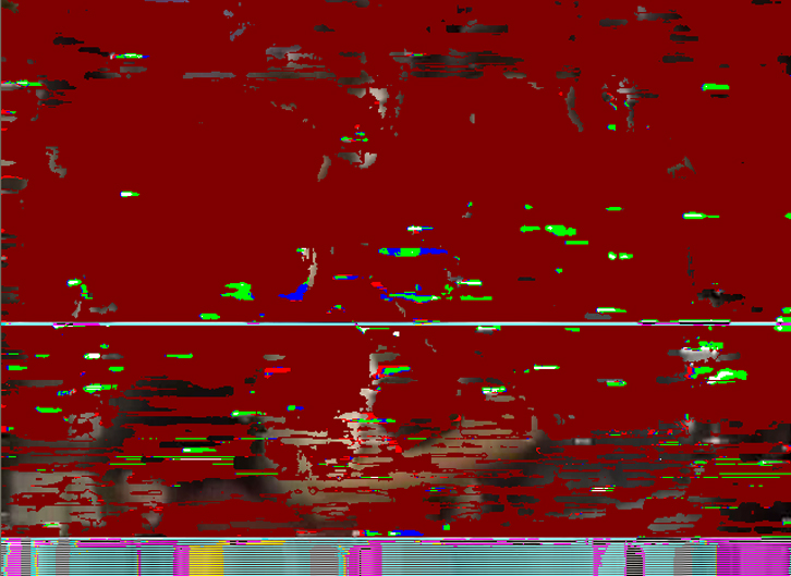

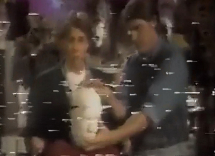

    Is there a blend=off option? I want to copy the pixels from the nearest good neighbors without any interpolation.
    Something like what's shown here:
