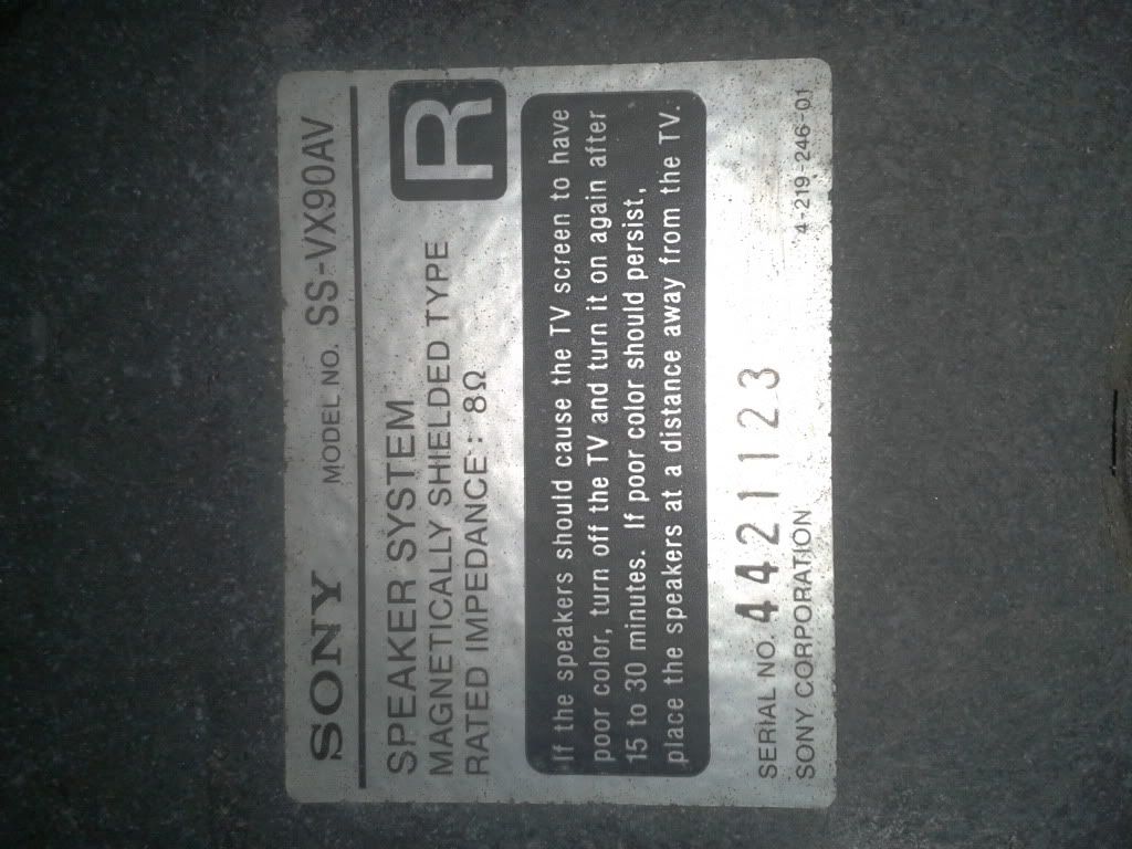

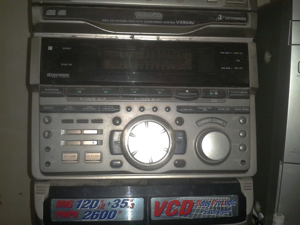

    The system has 345W RMS (120x2W + 35x3W).
    Model no is SONY HCD-VX90AV for VCD system & SS-VX90AV for speaker system (5 speakers).

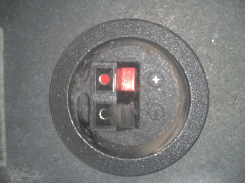

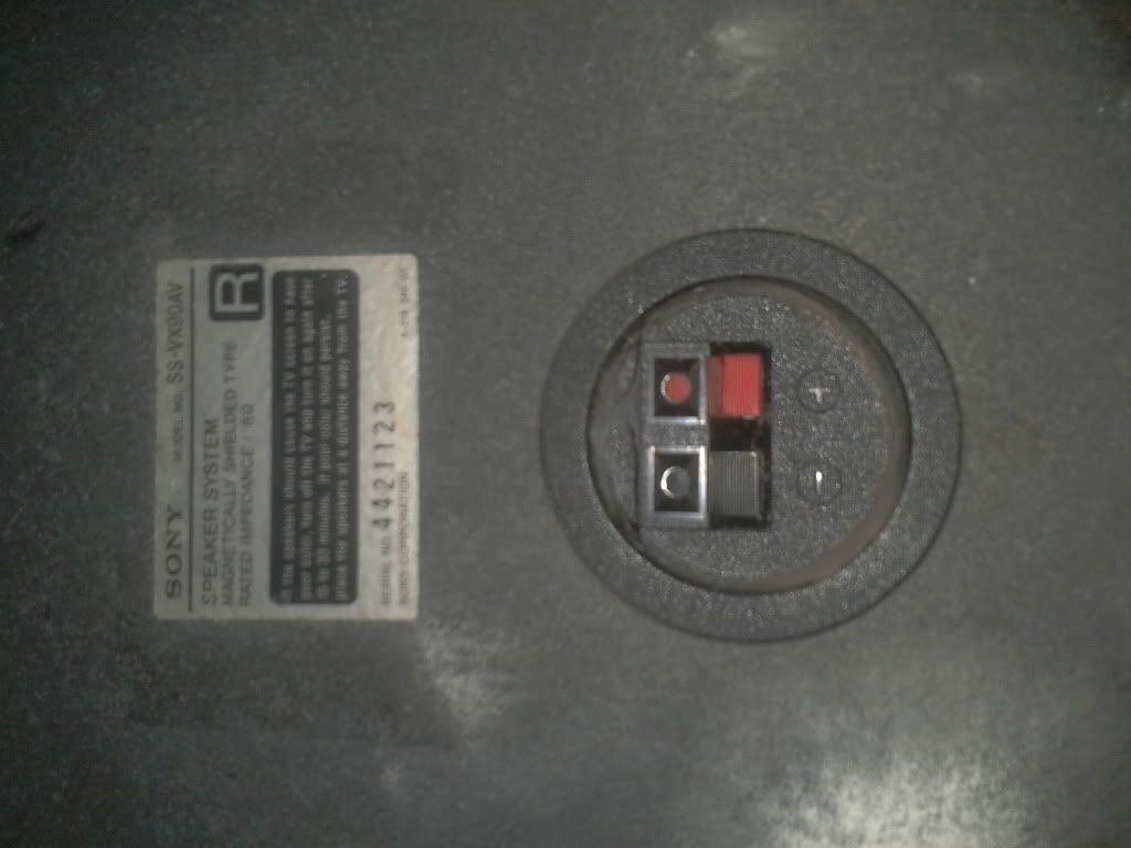

    the problem is that it doesnt have a Standard 3.5mm jack instead each speaker has 2 wires output.
    So is there any way through which i can connect those speakers wid my computer ???
    it has such type of connectors :- {instead of 4 there are 2 on each speaker}
    http://www.bikudo.com/product_search/details/29461/terminal_4pin.html
    PlZ help guyzz how can i convert this type of cables to a compatable jack that can be connected to my PC
    See i'VE uploaded the PiCS.
    Check the Speaker socket, how can i connect RCA CAbleS in the speaker socket ???

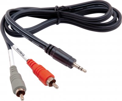

    You can get a very cheap cable to connect the headphone socket to the RCA input, as below.
    You normally set the volume at a medium level on the PC, to avoid clipping, and use the volume controls on the stereo.

    1/8" mini to RCA adapter
    1/8" mini to RCA cable

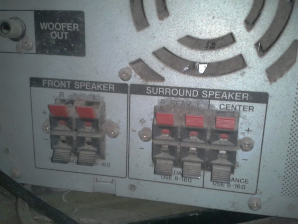

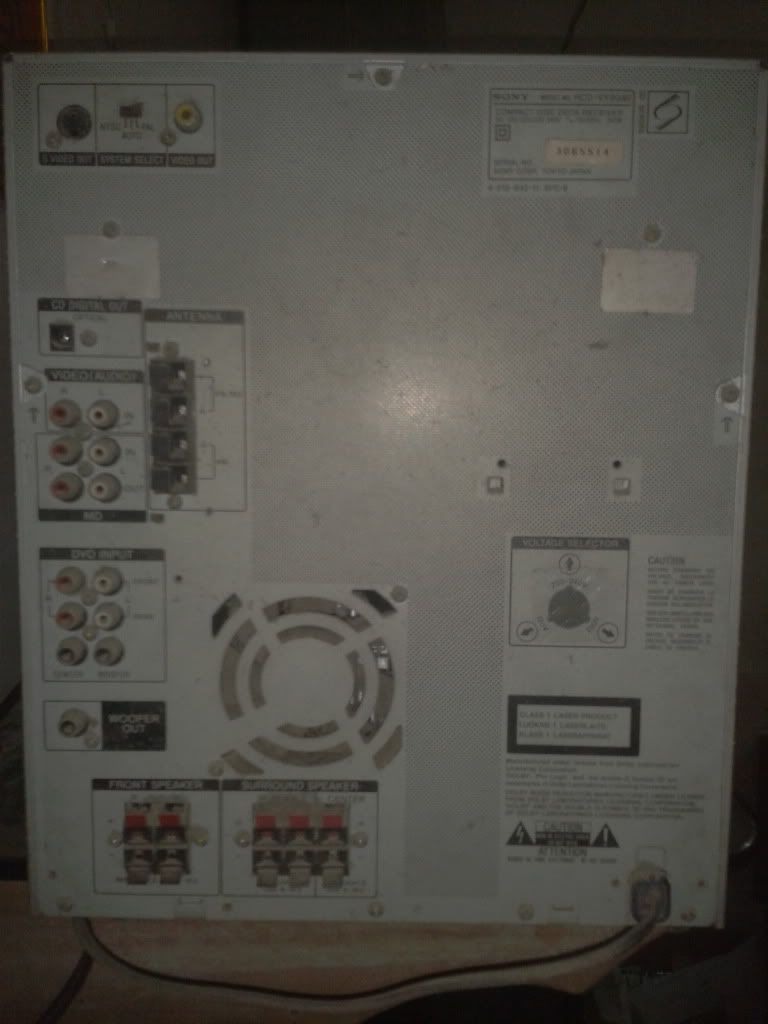

  4. i'VE uploaded the images of my system.
    Check out the socket of the speaker system.
    AS u guyz have suggested, RCA it doesnt fit in the socket of my speaker.
    So how can i connect it to my PC ????

    You can not connect those speakers directly to you computer it just won't work, the computer output has to be connected to your stereo. You have been given enough detail to work this out on your own but here goes.
    1.) get one of the 1/8 mini to RCA cable adapters
    2.) Connect small end of adapter to speaker output of computer.
    3.) connect RCAs to one of the audio inputs on your stereo, either the video or MD. (If all inputs are in use get a audio switcher or RCA
    4.) Switch stereo to desired turn on PC and PC should play through stereo.

  8. Member dragonkeeper's Avatar
    Jul 2003
    The signal out put from your computer will be sent to the Stereo where it will be amplified by the stereo.

    I already told you.
    And with your photos: connect the cable I showed from the PC headphone socket to the two "VIDEO" RCA inputs on your stereo.
    Then you choose "Video" as the source on the stereo when you want to hear sound from your PC on the speakers.
    I've got an old Sony stereo and do exactly that.
    You could connect the speakers directly; but you wouldn't hear anything. The PC only has enough power for headphones.
    The cable is very cheap from any electronics or audio store. Cost less than US$2.

    I was thinking that my Stereo System is of no use, as it just plays CDs & VCDs
    So i was going to throw it into scrap.
    As only the speakers were useful to me.

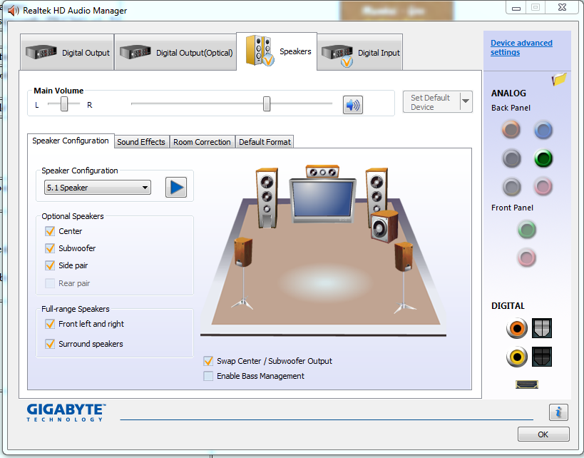

  17. hey i finally connected, all of my speakers through Stereo to my PC.
    but the problem is that i have 5 speakers.
    & when i connect all of that through the wires that are mentioned above,
    only 2 main speakers work.
    Others are not working, pls help.
    Here SS of my AUDIO MANAGER.
  18. SHOULD i Get all 3 wires ???
    or connect it to digital output ???
    pls. help ??
  19. Member Cornucopia's Avatar
    You can try one of 2 ways:
    1. Optical/TOSlink/spdif out from your PC (if you have this kind of connection) -> Digital Optical Input on the receiver ("stereo"). Can't tell if the optical on the stereo is really an input or an output (you'll have t5o test and see). Might work / Might not. 1 connection only, but probably not the best choice.
    2. Use the 6 connectors labelled "DVD In" on the stereo. It shows Front L+R, Rear L+R, Center & "woofer". Your SS showed you do have 3 stereo miniplugs that are paired to work with these inthe same order (Fr- L+R, Rr- L+R, Ctr+Lf) on the Analog Out Backpanel. If you get 3 of those stereo miniplug-to-RCA-pair adapter cables, you can easily have yourself a true, fullblown surround home theatre system! Should be sure to work (as long as your amp channels are all still working correctly after these years). More cables to deal with, but the surest choice.
    HTH,
  20. Originally Posted by Cornucopia View Post
    HTH,
    thnaks.
    BUt i still am confused & failed to understand few things :
    Can u pls. explain me what does all the above statements mean ??

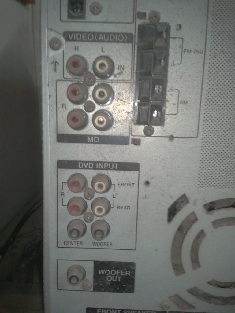

  21. Member Cornucopia's Avatar
    Look at that last picture you showed us...
    In that right-hand section (below where it says: "Device advanced settings"), you have 6 Analog jacks on the back panel of your pc, 2 analog jacks on the front panel of your pc, and 2 optical digital and 2 coaxial digital jacks on your pc, as well as a ??HDMI?? jack.
    The "coax" jacks are RCA type. all the analog jacks shown are NOT RCA (at least in that picture) but look to be mini plug type (1/8") - probably stereo (that's the most common configuration). If they're stereo, that means that 3 of those jacks on the back are for input and 3 for output (that's almost for sure with the 2 on the front panel - 1 for output/headphones and 1 for input/microphone). If 3 are for output, using the cable adapter(s) mentioned in AlanHK's post, you would take 3 of those adapters and plug them into the 3 backpanel output jacks.
    Now you have 6 RCA plugs at the other end. Plug them into the 6 "DVD" inputs on your receiver.
    The last bit about "all these years" was a guess on the age of that amp, based on the poor state of it in those pictures. If that's not accurate, my apologies. One still has to assume that all 6 of the channels are working correctly and at their optimum balance in order to have a correct surround output, though.

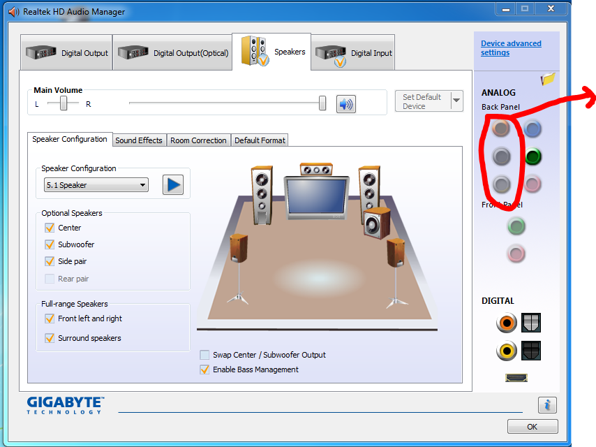

  22. so u are telling me to get 2 more {total 3} of those cables & attach the 6 JACKS on one side i.e. on the DVD of the steore & other 3 on my PC ???
    here as circled :-
  23. Member Cornucopia's Avatar
    Yes, that's what I'm saying.
    Although, you should of course READ THE MANUAL first, to make sure what those jacks actually are and which ones are for inputs vs. outputs. (Covering my butt ).
