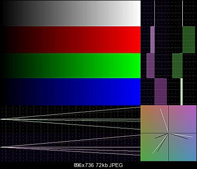

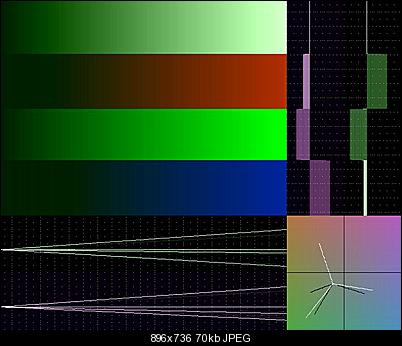

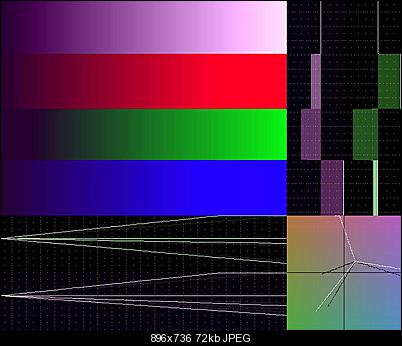

  5. Gain and contrast in ColorYUV are essentially the same thing. They both multiply the signal. But gain multiples around a baseline of 0, contrast multiplies around a baseline of 128. Since there can't be any values below 0, gain only increases values. But if video could have values below 0 they would decrease (become more negative).
    So increasing the contrast of of the luma signal results in darks getting darker and lights getting lighter. Increasing the contrast of the chroma signal increases color saturation. Increasing the gain of the luma results in all pixels getting brighter (except 0 which stays at 0). Increasing the gain of the chroma signals results in some weird color shift that I can't really fathom. Basically, positive values push toward purple, negative push toward green.
    WRGB ramps:

    cont_u/v=50:

    cont_u/v=-50:
