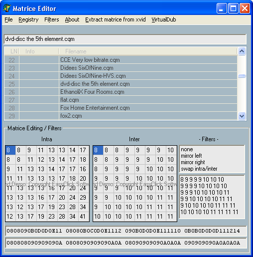

    thank you, manono, but i much prefer the one i'm currently developing. coding is one of my hobbies.
    thanks el heg, i knew about that quant dump feature--and used it a few times, a good feature indeed--but thats for mpeg2's, i'm looking for xvid avi's because it relates to what i'm trying to accomplish, which by the way, i solved. but now to get the 'dll calling' code to cooperate in my project--there is no example for how to do it using the resource i found, so i'm winging it through debugging.
    adding the ability to extract a matrice from an xvid will be a great feature to have!
    also, it wouldn't hurt to add a feature to determine if other matrices (from a list, D/L's or my own, folder, etc) are duplicates or not in a custom list i'm trying to work out...and a few other ideas. thanks again.

    Hummm, the app looks nice
    Especially because its window is resizable
    The editors by Rockas and Ligh do not use resizable windows.
