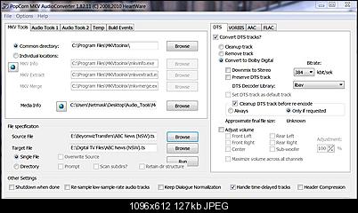

  15. Member netmask56's Avatar
    Sep 2005
    Sydney, Australia
    Originally Posted by carlmart View Post
    Originally Posted by netmask56 View Post
    Look in videohelp tools for Popcorn Audio Converter - it is designed to changed DTS to AC3 or whatever.
    Edit: here you are... https://www.videohelp.com/tools/PopCorn-MKV-AudioConverter
    I will need some tutorial for this program. It's far from intuitive.
    I really is quite simple under File Specification browse for your file
    next set the path for Target file ie processed file - you can browse for your desired location and then click on run.
    Couldn't be simplerClick image for larger version

  18. Member
    Jan 2004
    so I just extract/convert the DTS file and merge everything, with no headers.
    There is no need to extract and merge everything back together. This is done for you by popcorn.
    Simply load your mkv file into mkvmerge (along with your subtitles, if need be) and then select compression as 'none' in the extra options tab. The resulting mkv file will now have no headers.
    Now load this ouputted file (not the dts file on its own; thus no need to extract the audio) into popcorn and after you have selected your desired AC3 settings, just press run! That's all there is to it.
    What I do need is:
    1) End with a file with no headers.
    2) Add one of more subtitles.
    Will Popcorn allow me all that?
    Any concerns about quality?
    You will end up with a mkv file with subtitles (as you added these in with mkvmerge) and also no headers (as you set compression to 'none'). So mkvmerge will solve your above points. As for the quality; well i have had no problems at all with the ouputted mkv file. You may notice that the audio can seem a little low with AC3 files; problem solved, as you can tweak the volume setting with popcorn. I usually set mine at 150% output. But this is just a personal preference.
    If you are unsure in anyway, then try popcorn with a mkv sample file to get your desired output before trying it with your other files. Good luck.
