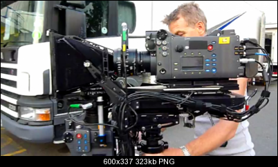

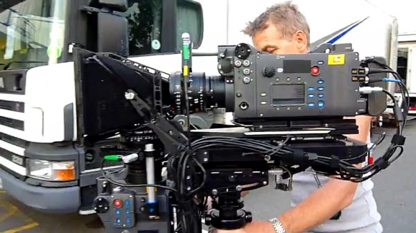

    Since The Inbetweeners is a recent production, it could take advantage of Euro digital 25 fps acquisition which is now allowed for D-Cinema as well as broadcast and Blu-Ray. 25fps is part of the new SMPTE standard "Additional Frame Rates for D-Cinema" described here.
    http://www.imago.org/index.php?new=76
    It is now possible to shoot and edit digital 25p and publish for broadcast, D-Cinema or Blu-Ray. Also 50p is supported for 3D (25p for each eye).
    The Arri Alexa can substitute for classic Arri or Panavision film cameras using the same lenses and support gear. The Alexa supports all the new SMPTE frame rates.
    Arri hype reel. It even works upside down for lefties! Take that Red
    http://www.youtube.com/watch?v=gVY8SOQVKTQ&feature=related
