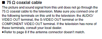

    The RF (tuner in) port needs set up for band and channels.
    The RF out should has this notice in the manual
    If you want to know why ask Panasonic.
