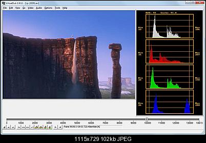

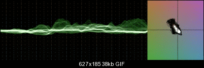

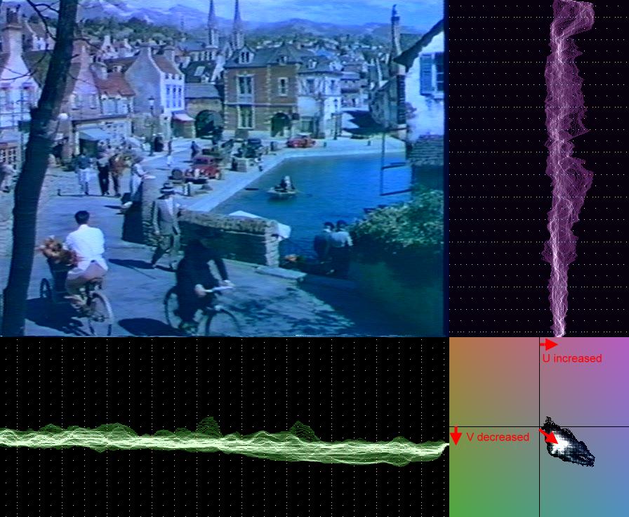

  1. The UV vector graph is useful in determining color shifts. For example, if you increase U and decrease V, ie move the colors towards the lower right corner, you shift the colors towards blue:

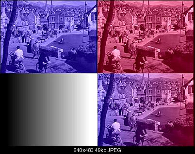

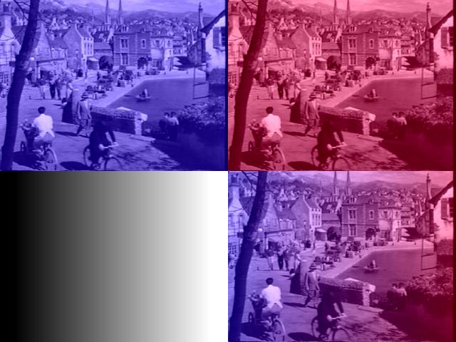

  9. Here's an example. I start with the sample image (to have something interesting too look at) and make it grayscale (so it will be very obvious what happens later). I make a copy of that grayscale image with the U plane shifted up, making it purple. Then make another copy of the image with the V plane shifted up, making it magenta. A horizontal gradient alpha mask was made using Gavino's suggested mt_lutspa(). Then the purple and magenta images were blended together using that mask:
    ImageSource("tooblue.jpg")
    BilinearResize(320,240)
    ConvertToYV12()
    Greyscale()
    purple=ColorYUV(last, off_u=50)
    magenta=ColorYUV(last, off_v=50)
    Mask=mt_lutspa(expr="x 255 *")
    mt_merge(purple, magenta, mask, true)
    StackVertical(StackHorizontal(purple, magenta), StackHorizontal(mask, last))
    The result is an image that's purple at the left edge, magenta at the right edge, with a smooth gradient between the two extremes:

    Going to what gavino posted above: The problem with blue is in the brights from RGB 180 up. Midtones are about right, then darks get too green, losing magenta. So the 0 and 128 points with blue are about OK, it's above RGB 128 that I was trying to reduce. For some reason cont_u at extreme negative values got blue out of the 155-plus range. But Blue was really shooting up there, I added a sharp VirtualDub grad curve from 180 on up!
    The image I posted is early in the scene. It's 13.5 seconds, during which it displays the same hue changes as the titles on all versions. I thought this was Macrovision effects on the tape, but it's on cable too. Hue changes last longer as the movie plays, then gradually dissipate until 30 minutes later they're almost gone.
    So, the opening minutes are a mess in all versions. Vectorscopes of following scenes show no slope, but slower hue drifts between cyan and magenta (more subtle, too). Then you suddenly hit something like the carnival scene, with problems similar to this one. It's the same on VHS and cable.

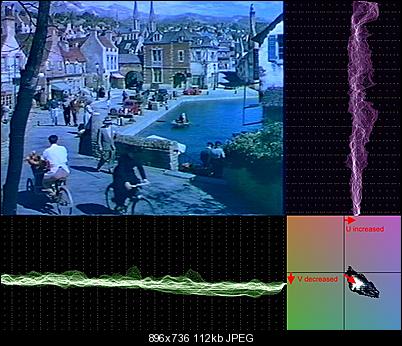

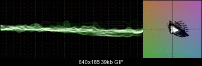

    Frame 194 gives this vectorscope, for 1 frame only. But I don't see any color changes at all:
Name:	f194 scopeR.gif

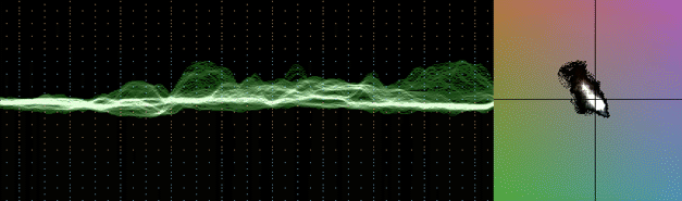

    Frames 58 and 59 have a small but bright Sunkist orange to the left of the larger red vehicle -- exactly like both cable versions (No bobbing this time. I'll use SeparateFields. In the IVTC version I'll run RemoveSpots)
    150 frames after the frame I posted, it's too green. 80 frames later, too red. Just as blue starts taking over again, the scene ends and the next scene actually looks good with scant color work needed. After spending an hour reading up on masktools, looking at the scene again it appears the left side street and buildings are also too blue, just as bad, all above RGB 180 - and no red/green color difference in bright building facades between left and right. Effectively, then, the entire scene has too much bright blue and too much green in shadows. So the mask colors reduce browns and yellows in the buildings. Green in the darks is another problem. The suit worn by the man walking left to right would change color. So I think I know why the cable versions are so green: apparently it masks many of these hue changes thru the movie.

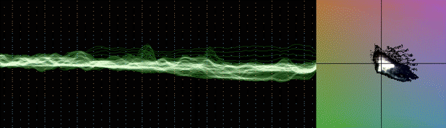

    Vectorscope for the next scene has less of a slope (mixed light with bluish shadows, and lots of greenery here). By frame 1210 there's no slope at all.

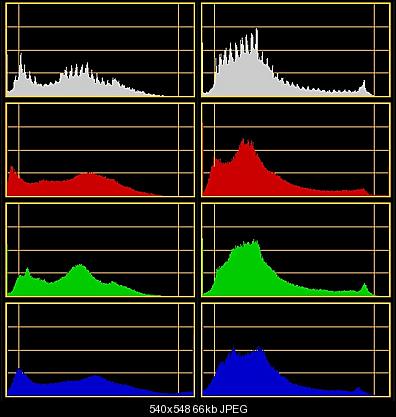

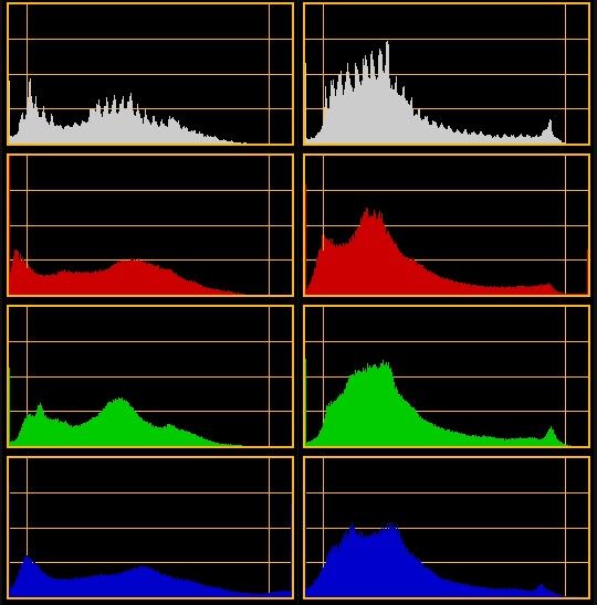

    These are RGB histograms of the unmodifed capture. The problem street scene is on the left. You can see bright blue stretched beyond the other colors.
    I just looked at all 4 VHS captures. This scene looks like the same doodoo on all of them. But all the other scenes, including 4 more shots of this same location, don't have the blue problem or the red offset seen in the 'gram on the left. The other scenes (all of them) look similar to the histograms on the right. The cable recordings have a different problem with this shot (red).
    Any mask that adds blue to any part of the scene makes blue look worse and harder to handle. After trying a few mask ideas in Photoshop and Avisynth, no one mask resolves blue or other left-right color imbalance. The trick with this scene involves green shadows and too much red on the left and middle. I'm getting my proc amp and stuff and capturing this scene again. I hate VHS.
  12. Originally Posted by sanlyn View Post
    I'm not arguing that the street scene doesn't have too much blue, but there's no reason the RGB histograms should look similar. The colors in this image are all close to what the creator intended and the histograms look nothing alike:
    Similar RGB histograms usually means there's lots of grays in the image.

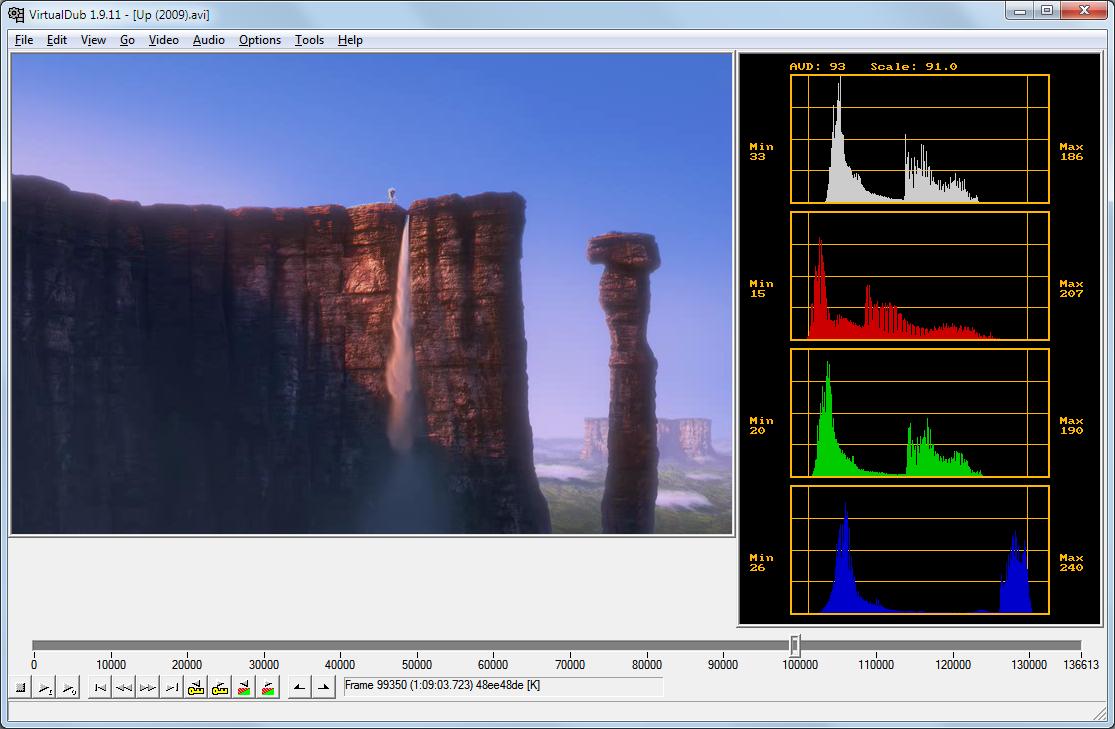

  15. Banned
    New York, US
    What are you using to show histograms in Vdub?
    Copy VirtualDub output window to clipboard, paste in new image in ancient Photoshop or ancient PaintShopPro. Then crop, etc.
  16. Originally Posted by lordsmurf View Post
    ColorTools. http://www.trevlac.us/colorCorrection/colorTools.html
    My cap was an Alt+PrintScrn cap of the VirtualDub window, pasted into an image editor, saved as JPG. The forum software displays it downscaled. Click on it a few times to get full size.

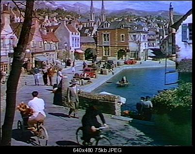

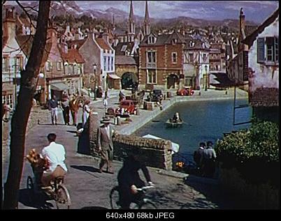

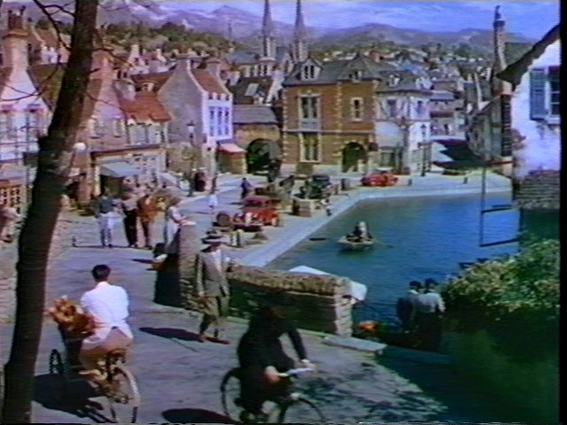

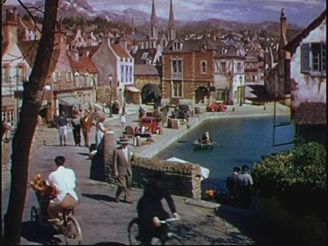

    The VHS production lab decided that instead of warmish morning light, this scene should look like a brilliant, blue-blasted high noon with a color temp approaching 12000K (you don't even get that much blue under heavy overcast!). You expect to see Gary Cooper on the street under a blazing noon sun. The cable version has the more correct Fall morning light. Reduce bright blue on the VHS, and you find data mostly destroyed in the RGB 30 to 90 range. A new capture with a proc amp didn't fix blue.
    unmodified VHS:
    unmodified analog cable print (buildings have correct colors for French Alpine villages):

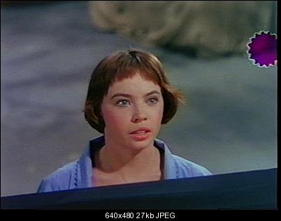

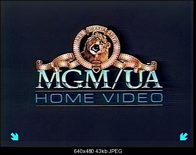

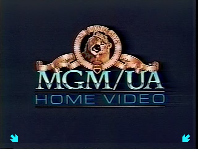

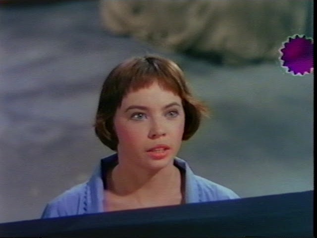

    Later, all versions of the movie have crap like below. Nothing like a huge reel change signal to liven things up.

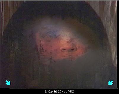

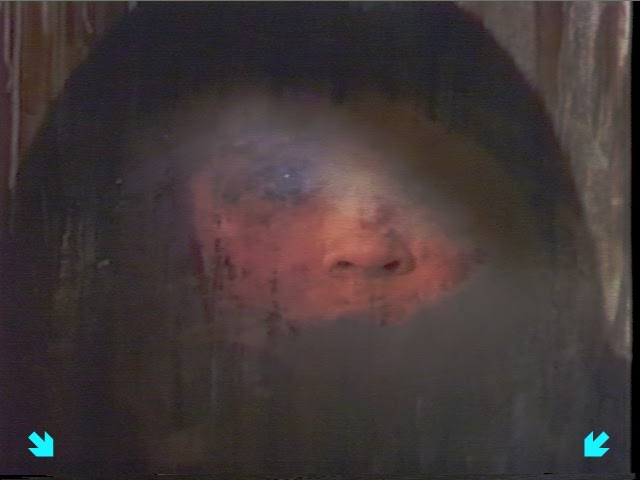

    This is the problem I mentioned with the SignVideo PA-100 proc amp and some Macrovision tapes. At bthe bottom of the image is a 20-pixel high discoloration ("gray bar"). I've had to exagerrate the brightness/contrast to make it more visible a PC monitor (it's far more visible on TV). Arrows in the images indicate the problem area. The affected area is visible as lighter gray in dark areas, darker gray on bright shots, around RGB 24. It doesn't appear on home-made or unprotected tapes. About 30 to 45 minutes into a tape, the affect dissipates and can't be seen.
    I know the images show other noise problems; I fixed those, but the gray bar persists. In the "Home Video" logo, the gray on the right-hand border isn't in the movie. This happens with every player, capture card and OS. My usual setup for VHS capture with VirtualDub is:

    How I arrange components in the circuit makes no difference. As soon as I remove the PA-100, the gray area is gone. Same problem if I capture directly to a DVD recorder or play directly to TV with the PA-100 hooked up, so the capture card or TBC isn't a factor.
