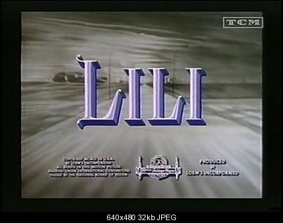

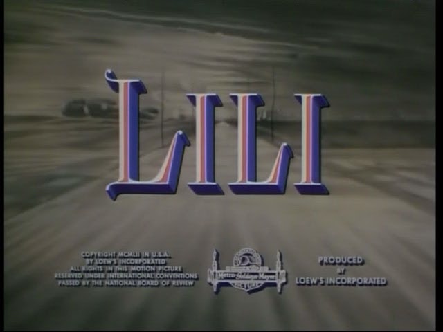

    I have no frames from my VHS titles. The tape was damaged, the titles wouldn't play. I'd fast-forward the tape to a point just past the titles, then slo-mo back until I hit the point where titles faded to black. My captures started from that point. That's why I'm borrowing titles from a cable broadcast.
    The TCM cap on the 'net doesn't look like the LD version I saw 'way back when, or any other version I've seen, including my TCM recording in June 2010. Maybe that's from an early tape?

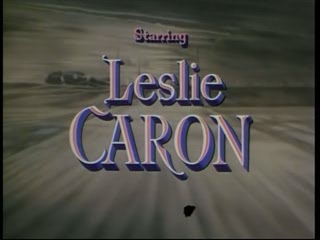

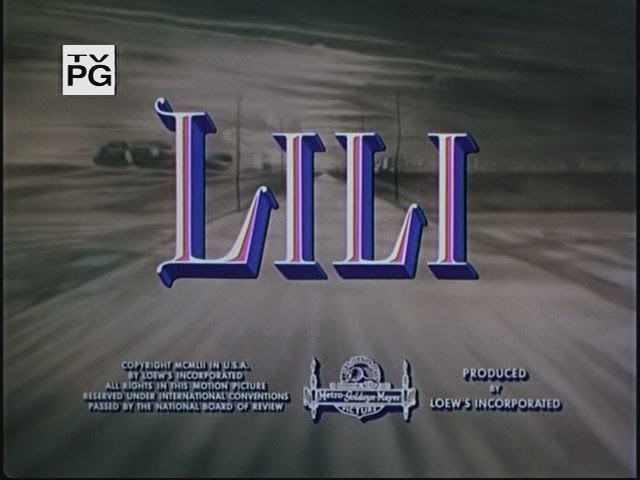

    internet image:
Name:	cable titles.jpg

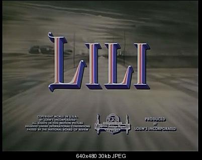

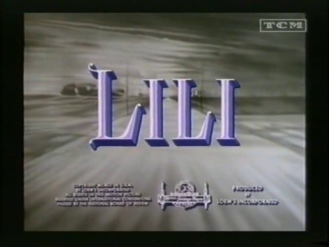

    TCM titles I recorded off SD-digital cable June 2010:
Name:	TCM Title.jpg

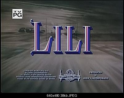

    PBS title I'm working on, recorded off analog cable line Nov 2006:

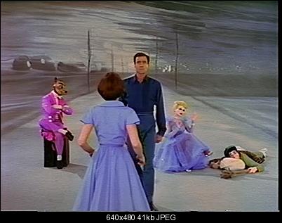

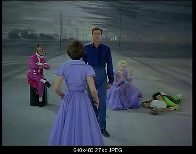

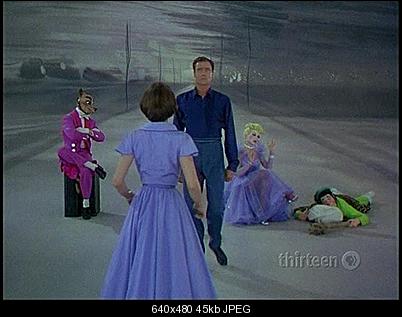

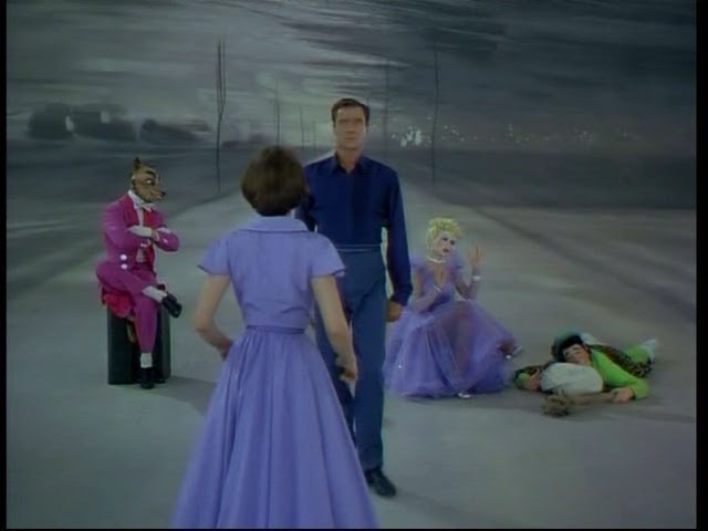

    Here's a scene comparison on near-end of LILI project I'm trying to finish now (only 4.5 minutes of video left to go). NOTE: none of these shots have had any color work or processing so far. Obviously the VHS version has some red chroma bleed requiring a bit of work (that's why we love Panasonic VCR's, right? The JVC was worse... :
    TCM broadcast:
    PBS broadcast:

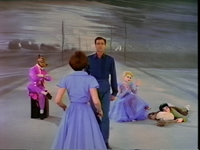

    VHS capture:

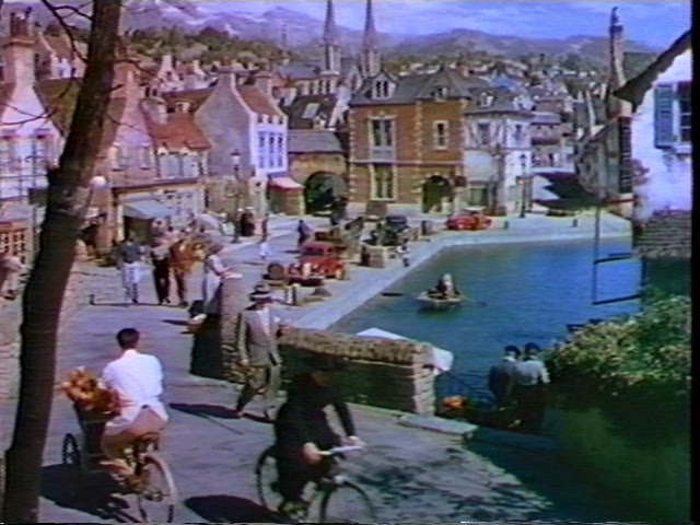

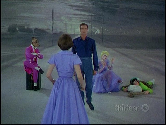

    Ok, so on this VHS restoration (remember that?): I have a number of scenes in the VHS and cable versions where color and luma values in the original YUY2 are banging against the right-hand side of histograms. I'm able to fiddle with ColorYUV luma OK and reign it in to 16-235, fixing some crushed blacks and fried highlights. But this does nothing for u and v colliding into the bright side of the histogram. Gain and offset just screw up everything across the board. Or does ColorYUV chroma contrast do something I'm not aware of?
    This sample has luma doing OK (the image is unaltered in other respects). I know, it has other problems I can fix later. Bright blue contrast is off the chart. I've always had problems controlling specific color ranges in YUV. With scenes like this, once I bring it into RGB or MPEG I lose bright detail in some colors.

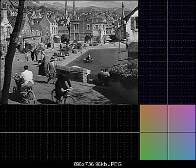

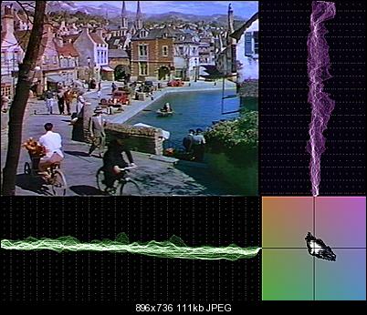

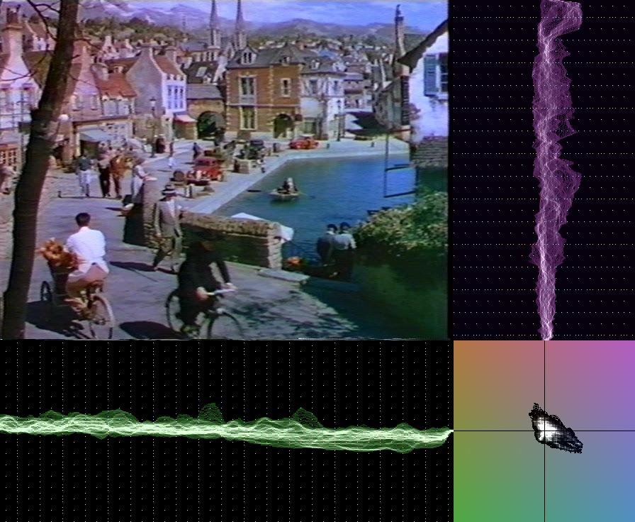

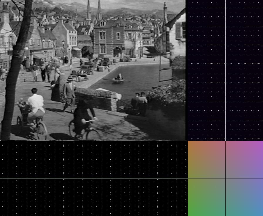

  24. You use off_u/v to set the white balance. Use cont_u/v to change the saturation.
    Use VideoScope("both", true, "U", "V", "UV") to see graphs of the U channel on the right, V below, and the UV vector graph at the bottom right:
    Grayscale has U and V channels set to 128:
    Ie, the U and V channels are flat planes of 128.

    OL, I'm keeping that offset and cont action in mind (thanks, best explanation of those two I've seen), and in AvspMod getting used to the vectorscope. I think the v-scope works better for this sort of balancing act than the histogram or others.
    Gettin' there, jagabo. This one's kinda fiddly, blue/green are spread from end to end, but it's coming along. I had my proc amp going during capture, but this shot sneaked up on me. The next scene doesn't have enough blue. I hate VHS.
  26. It also looks like the vscope graph of the V channel is tilted. The right side is drooping lower than the left side. A simple off_v won't fix that.
  27. Banned
    New York, US
    Mm, the only ColorYUV statement going when I made that cap was ColoYUV(off_y=4,cont_y=-10). I didn't even need the -10. Luma is well below 235 without it. I just read vectorscope's doc and searched a bit on doom9, but nothing told me what a slant or slope means. End-to-end I understand.
    I was getting odd results with "offset". I ended up playing with gain + contrast, and having to tweak a tiny bit with offset to stay above the dark end. I'm assuming the vertical tick marks in the sides of the V scale are . . . well, come to think of it, I don't really know what they are.
  28. Maybe use tint?
  29. Banned
    New York, US
    Tint, I think, goes back a bit. What I recall of that function, I'd have no idea how to adjust the settings. The only color that's actually wacky here is blue. I'm still fiddling, though The original blue started out at 255 (and probably "raw" values higher than that), but I have it down to 241 now. Lots of interruptions here at home tonight. ....Woops, there we go -- down to 237 max. Look at the white shirt in the image. Blue 237 is still some 20 points higher than green and red.
    There are other whites and some grays, all too blue but getting better. The street, I think. should be close to gray (that's a guess, but who ever heard of a blue street? The village is French, so you never know). But I'm getting closer. I'll keep at it. Back in a bit.
  30. Banned
    New York, US
    FInally got bright blue under control without totally wrecking the other colors. Thanks for the tips. offset worked OK at the dark end, but bright and midtone responded mostly to gain and contrast. Gotta go forage for food now. I'll tweak it in RGB.
