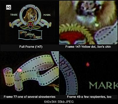

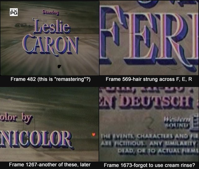

    It's a shame the movie "Lili" (1953) with such beautiful color work has to get short changed with inferior VHS editions and an even worse laser disc. I'm making a 2nd effort at restoring the movie's color from my 2 old VHS tapes. I've learned a little in this forum since I first tried this 4 years back. The problem here is the opening titles. Both tapes had the titles devoured by a faulty VCR (since dumped, and good riddance).
    Frankly, the VHS titles aren't just noisy; they're really, really ugly. I have 4 cable broadcast recordings (I think all cable stations show the same crummy laser disc version) with intact titles and so-so audio. I borrowed the titles from my 7500-bitrate DVD recording off a PBS station. They're the cleanest I've seen (that still doesn't say much for the LD). What the LD titles have is some noise in the margins of the MGM lion's roar. But worst is the spots and tiny explosions during 1-min 13-sec of the movie's start.

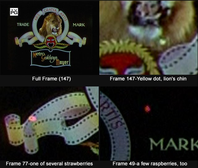

    After struggling for a week with every de-spot filter I found, I devised an AviSynth script that de-spots the hard way: frame by frame -- field by field, in fact. The caps below show some of the debris that the laser disc people call "digital remastering". IMHO they just copied some bad film stock without using so much as a dust cloth.

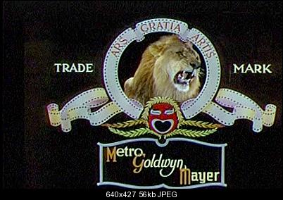

    The MGM lion's name isn't Leo, BTW. It's "Jackie" (Yes, Mulder, the truth is finally out there).

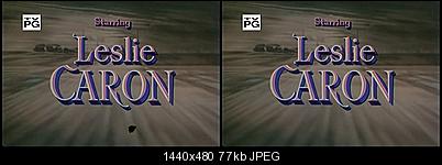

    The opening credits are just as bad:
    Here is a sample NTSC MPEG2 of cuts from the titles - not the whole thing, just some of the worst frames. 11.7 MB (No audio, from the unmodified DVD recording).
    http://dc426.4shared.com/download/PqmKlPjf/Sample_Spots.mpg
    If you care to see all 13 minutes of the original, unchanged titles that I just spent 3 days with, here 'tis (NTSC DVD, no audio, 46-MB):

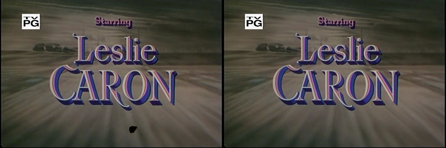

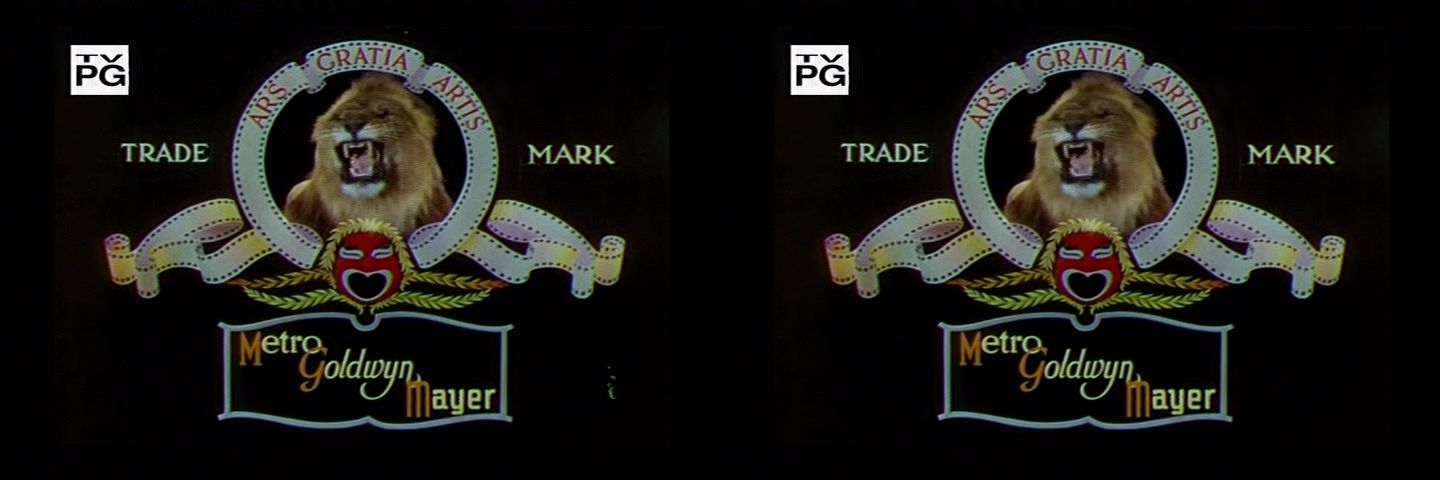

    The result of de-spotting Jackie the MGM Lion:
    NTSC MPEG2, 6 seconds, no audio, 3.5-MB
    http://dc234.4shared.com/download/_feM7ikb/Jackie_fix.mpg

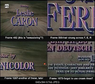

    After three days of this unconventional script, here's 1-minute 13-seconds of the opening titles -- with audio and everything!
    NTSC DVD, 13-min, Dolby audio, 55.4-MB. It's anyone's guess what the background colors look like (they keep changing). I made the letters look like those in the final "The End" titles.
    http://dc223.4shared.com/download/i61jCet5/TE3.mpg
    Probably broke every rule in the AviSYnth Bible with that script. Anyone wishing to haul me onto the carpet for this method, have at it. While you're at it, consider what might be done with all the noise in the margins of the MGM logo shot. I have many classic color film recordings, and that noise appears on quite a few shots of this 1950's logo. I just might have to buckle down and learn some masking techniques in After Effects to clean this:
    You might also note that the opening titles change color every 10 seconds or so. This happens on the VHS and the LD broadcasts. It gradually clears after about 10 minutes of the movie. I don't know what causes it, but autolevel filters made it look awful.

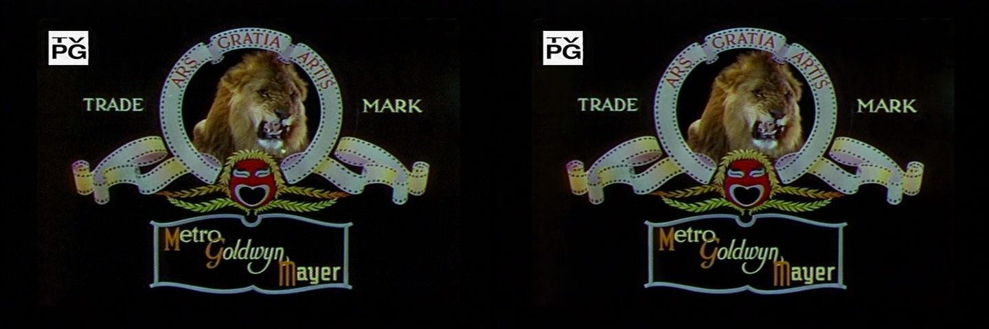

  6. Yes, IVTC first (TFM().TDecimate()) then use RemoveDirt(). That will take care of most of them.
    http://www.removedirt.de.tf/
    http://avisynth.org.ru/docs/english/externalfilters/removedirt.htm
    RemoveDirt() also degrains. I have a slight mod that only removes spots:
    function RemoveSpots(clip input, bool "_grey", int "repmode")
        _grey=default(_grey, false)
        repmode=default(repmode, 16)
        clmode=17
        clensed=Clense(input, grey=_grey, cache=4)
        sbegin = ForwardClense(input, grey=_grey, cache=-1)
        send = BackwardClense(input, grey=_grey, cache=-1)
        alt=Repair(SCSelect(input, sbegin, send, clensed, debug=true), input, mode=repmode, modeU = _grey ? -1 : repmode )
        restore=Repair(clensed, input, mode=repmode, modeU = _grey ? -1 : repmode)
        corrected=RestoreMotionBlocks(clensed, restore, neighbour=input, alternative=alt, gmthreshold=70, dist=1, dmode=2, debug=false, noise=10, noisy=12, grey=_grey)
        return corrected

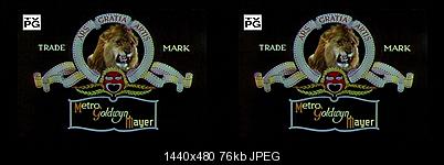

  8. Originally Posted by sanlyn View Post
    This project is going into DVD, so I'm reading up on how to cut out duped fields but still end up with 29.97 fps interlaced DVD that lasts for exactly 4470 interlaced frames to synch with music and dialog.
    TFM().TDecimate() will leave you with 23.976 fps progressive film frames. You encode that as 23.976 fps progressive MPEG 2 with 3:2 pulldown flags. That will retain the original running time.
    RemoveDirt() and RemoveSpots() don't work well during fade ins and fade outs, or when motions get too large.
    Some samples where it worked well (original left, RemoveSpots() right):
    Import("C:\Program Files (x86)\AviSynth 2.5\plugins\RemoveSpots.AVS")
    Mpeg2Source("Sample_Spots.d2v", CPU=2)
    TFM(d2v="Sample_Spots.d2v")
    TDecimate()
    StackHorizontal(last,RemoveSpots(last))
    There's also an MC version of RemoveDirt() that should work better (albeit slower) when there's motion.
