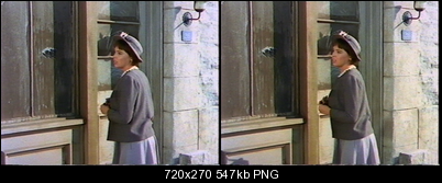

    One scene with really ugly color problems. From various discussions I learn that these effects are caused by (a) lousy mastering for the VHS, WNET's digital broadcast, and TCM's digital Broadcast, (b) Macrovision effects, and (c) VHS that's been played to death. The scene starts green, then red and green and blue "pump" for several seconds. None of the colors look correct anyway: the girl's clothing is supposed to be dull gray, the purse and suitcase black, lighting is harsh early morning sun -- no telling what the colors of the buildings are, they look different in every shot.
    Here is Lagarith YUY2 AVI as captured (it has been ivtc'd, nothing else). Color pumping is obvious, especially in the brights:
    http://dc595.4shared.com/download/GgXSSnOb/A01f_L3A_ivtc.avi (49 MB)

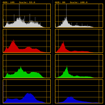

    This is Lagarith YUY2 AVI of the histogram. Note bright pumping, especially blue:
    http://dc589.4shared.com/download/ufWuGnI-/A01f_L3A_ivtcHIST.avi (2.4 MB)
    After much filtering, despotting (exactly the same spots, cherries, grapes, etc., are in the digital broadcasts), AutoLevels, SmoothLevels, ColorYUV, MCTemporalDenoise, QTGMC, and lord knows what else. This is the first several seconds of the scene in MPEG2. You can see why most "auto" controls don't work here. They make levels and color balance worse whenever anything moves.
    http://dc528.4shared.com/download/F1PbACnT/A01f_L3A_ivtc_RSYout.m2v (20 MB)
    These effects are in all versions, from all sources. There are complaints about the godawful color in reviews on Amazon and elsewhere, and the problems aren't peculiar to VHS. The effects gradually fade; after 20 minutes they're less visisble. By 40 minutes, they're gone (thank goodness) and colors look normal, even on old tape. In WNET's versions the effect is partially masked by a heavy red color balance; TCM's is much too green and soft but it's still there.
    My brilliant idea is to (a) live with grunge in this scene and move on, or (b) figure what I can do to try to stablilize red and blue layers separately, then rejoin in either YUV or RGB. Haven't found any ideas yet.

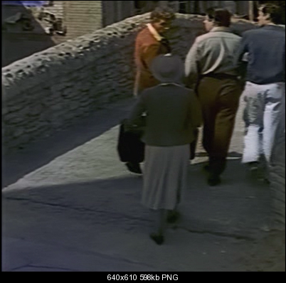

    Making progress -- and finding more problems (why am I not surprised?)
    I found a decent solution for those chroma pumping scenes. Not 100% OK, but maybe 80 ? ? Here's yet another damaged shot with bad red-green pumping at the start, not to mention a ton of noise. I was going non compos mentis over this shot and the one in Post #190. An MPEG version of the original AVI capture is attached below as B02b_original.mpg (13.3 MB). I applied 2 fixes. The pumping fix is highlighted in blue below. Then I tried some masking to help with burned highlights. Still some work to go there. Results of the script are attached as B02b_try1.mpg.

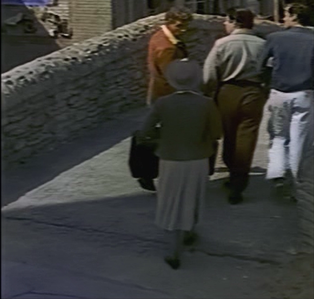

    Still along way to go. Colors are still awful. I hate auto filters, but the combo of AutoWhite and FFT3D was the only way around the pumping. In the "fixed" clip you'll note how AutoWhite screwed up gamma in the latter part by trying to lighten darks and brighten whites at the same time: contrast is royally screwed as the scene ends. So I devised a 2-step process, the 2nd step being a higher-contrast version of step 1. I should be able to dissolve the two versions together somewhere around frame 360 onward.
    After some noise is removed, etc., you start noticing other problems. The blown-up image below shows some reddish gunk on the girl's sweater, a blotch on the left-hand guy's tan jacket, and blue stain in the lower left (it's a blue peak around RGB 70 that screws up everything). Even with AutoWhite, the color balance has gone green, skin tones are weird, and the guy in the middle was wearing brownish red slacks that are going dark olive here.

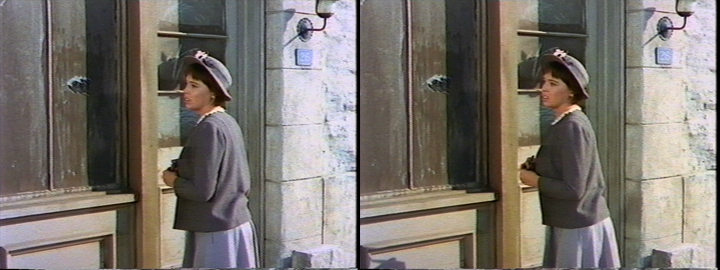

    The way the color balance shifts from too green/red at the start to too blue at the end is frustrating. An RGB histogram of the original AVI shows what colors look like at the early frames (left image), then how blue has shifted right and red left at the end (right image). Note in the right-hand histogram how midtones and brights have flattened out, with the scene looking wishy-washy. So I figure 2-step is the way to go here. Pain in the neck.

    For shimmering objects and walls, you can use QTGMC in progressive mode (inputtype=1)
    You can limit it to walls by motion tracking a mask, but "damage" to other objects won't be that noticable on low quality VHS sources
    Is it me or there seems to be some "rumbling" in the try1 version? Like the wall is jittering at that end of the sequence that wasn't there in the original ?
    EDIT: it is there in the original but seems worse in try1. It's frame warping primarily at the top 1/4 of the frame

    The ripple is in the original, and in the tv versions -- where, in a few spots, it looks worse. I have 9 captures with 4 VCR's, it's exactly the same on all, same frames. RemoveSpots() actually calmed it down in a few shots, but didn't help here. Yes, you see it more clearly after QTGMC or even yadif, but it's definitely there under the noise as well. I also note the first two or so frames in a new scene change will often jiggle or is even a little tilted in the frame. And some frame-by-frame play shows a re-rendered, fuzzy first frame where there was apparently some sloppy lab editing and joining (?). You seldom notice it during play -- although there was one scene cut followed by 3 reddish, dark, ugly frames -- fortunately no audio there, so I just deleted them.
    Looking at the books on AfterEffects now. 3 big tomes, 3 DVD tutorials. Gimme a couple of weeks. Thank heavens most of this poop video ends about 1/3 in. The worst of the pumping seems due to Macrovision (but it's in the tv versions, too) and dissipates halfway thru. I fear that masking in AE is the only way I can repair some of that color.
    Thanks for the notes.
    P.S.: that rippling, I did fix a couple of frames with MCReplaceFrames(), not shown in the script. Might tackle a few more, as they're usually just 1 frame, then 1 later, etc. Pain in the neck, but it did work.

    So, 2 months later I fixed some more ripples and jitters. Contrast masking created a nightmare, notably because AutoWhite() created a gamma and contrast nightmare that changed every 150 frames -- but AutoWhite and FFT3DFilter cleaned up most of the chroma bounce (still some remnants in shadows, lower left). Made 2 versions of this scene, each with different levels/color fixes, then joined with a dissolve around frame 330. Thus, autowhite fixed one chroma problem and generated a dozen new ones.
    The original clip and the earlier effort are in post #204. The scene immediately following this marks the start of fading Macrovision effects, waning noise, and decent color and detail to work with (saints be praised!).

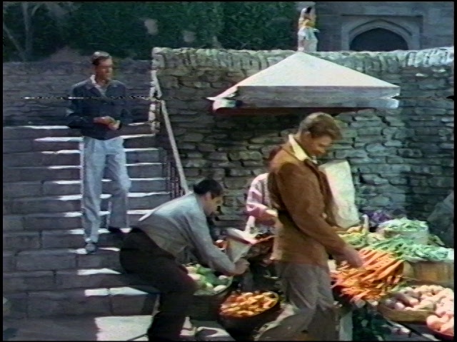

    Interlaced or not? So this capture from VHS is from the movie that is "supposed to be" progressive with 3:2 pulldown. The capture was first ivtc'd and should now be progressive, right? But I have one bad frame with a horizontal streak near the top of the frame that DeVCR and other filters didn't catch, likely because there's too much motion.
    Original frame 382, with streak near top of frame:
    [Attachment 15095 - Click to enlarge]
    But if you SeparateFields() or use yadif (I used yadif here), you double the frame numbers and find that even frame 764 doesn't have the streak but "deinterlaced" frame 765 shows the streak near the top:
    yadif frame 764 (Top), yadif frame 765 (bottom):
    [Attachment 15096 - Click to enlarge]
    [Attachment 15097 - Click to enlarge]
    So I used the script below. It creates a copy of the clip ("a2") with Yadif, which deinterlaces the first 385 "progressive" frames. Then it adds 1 extra frame to a2. It then replaces the original progressive "bad" frame with the clean frame, then uses Select Even() to get a clip with the same frame numbers as the original clip. Finally it replaces the original bad frame 382 with the yadif'ed frame 382.
    a1=AviSource("E:\LIL2\A\L3A_ivtc_RS.avi"
    a2=a1.Trim(0,400).AssumeTFF().Yadif(mode=1,order=1)
    a3=a2.DuplicateFrame(0)
    a4=ReplaceFramesSimple(a2,a3,mappings="765").SelectEven()
    Out1=ReplaceFramesSimple(a1,a4,mappings="382")
    return Out1
    The result looks like yadif'ed frame 764 (the middle image above, with no streak). I might have got a sharper frame with QTGMC, but I'm sick of looking at this damaged section of tape. Hope that fix is a valid one. It plays OK after more fixes and color work.

  29. What happened was one field was messed up on the tape (or when capture) so when that field was combined with the complimentary field the defects were retained. Yadif compares the two fields. Where there is no motion (or other mismatch) it uses data from the other field. Where there is motion (or other mismatch) it interpolates the missing line. So it saw the noise in the complimentary field, ignored it, and interpolated from the existing field.
    Remember, analog video is transmitted as sequential fields. It's entire possible for one field to be messed up and the other to be just fine.
