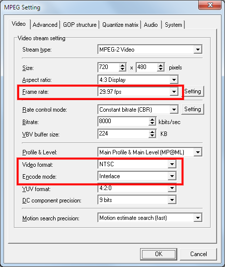

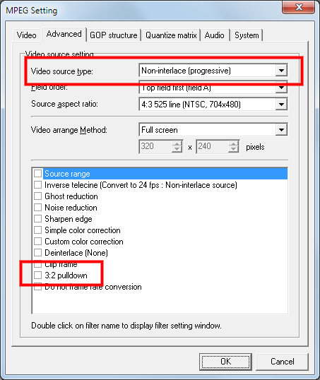

    I just put the two encodes thru SeparateFields and bob(). The HCenc and the later TMPGenc encode look exactly the same, frame for frame, no blending in either when viewed in those ways. Each field is distinct and telecined on exactly the same frames. I captured a 10-field sequence from each and mounted them in Photoshop, then turned the layers off-on, etc.; field for field, they're exactly alike.
  2. Yes, your file in post #148 is fine, soft telecine. I didn't mean to imply otherwise.
    In case it's not clear to anyone: for soft telecine (video encoded as 23.976 fps progressive frames, 3:2 pulldown flags added to instruct DVD players how to produced 59.94 fields per second output) of a 23.976 fps progressive source in TMPGEnc Plus you want to use these settings:

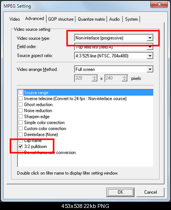

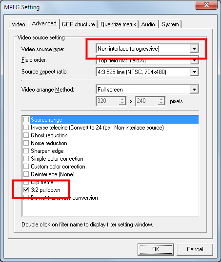

    Hmm. The post in 148 was with the "3:2 pulldown" checkbox. The settings shown above are the ones I used for the earlier post here in #129.
    The attached m2v is a re-run with the above settings. To me, it looks like its mate posted in 148, until you bob() or SeparateFields -- under those conditions, they don't look like anything posted in #148 from either HCenc or TMPGenc.

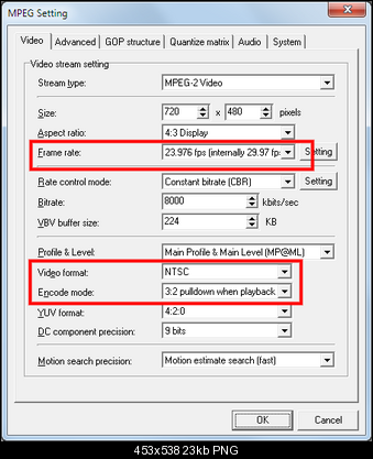

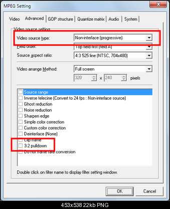

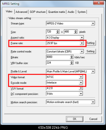

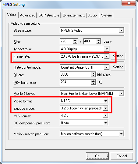

    Thank you, jagabo, for that refresher on frame and field display. The settings you posted are the two TMPGenc setups I used -- once I figured out what was wrong with the IVTC scripts. To rephrase your excellent posts on how frames should appear, using the sample clips I posted:
    OK, I reorganized and started over (again). I made entirely different versions of the TMPGenc projects -- that is, rather than keep opening the same project and changing its buttons for every encode, I created a different project for each encode, with a different name, in separate folders. Meanwhile there's only ONE copy of the TIVTC'd AVI for input, instead of 3 or 4 revisions everywhere (I think multiple copies of the input caused confusion??). All other revisions, encodes, etc. moved to an external drive, outta sight.
    With HCenc, I see only two controls for 3:2 pulldown: either click the "3:2 pulldown" radio button, or click "Make DVD compliant". I tried HCenc both ways, same results.
    So I now have three pulldown encodes that seem to work as intended: a soft HCenc, soft TMPGenc, hard TMPGenc. And I have the original cable and VHS sources.

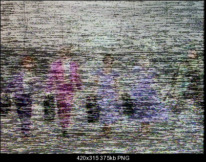

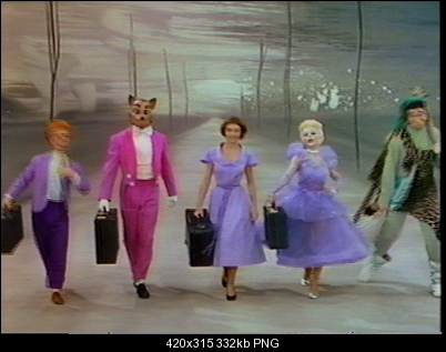

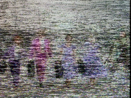

    This being my first iVTC/3:2, I'll give all these suggestions a try. I got a PM recently asking why I'm cutting those AVI's and treating scenes differently. Most would just capture, clean, encode, author and burn in one swoop. Wish I weren't so picky.
    I'm working with three captures from two VCR's. Each has their good and bad points, in different places. The image below is from capture #1 (capture #2 looks exactly the same). Both from the same 1998-era VCR. No IVTC or processing, just encoding for the mpg.
Name:	capture 1 and 2.png

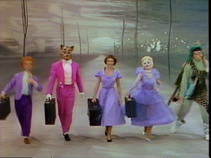

    The image below is the same frame, from a 1995-era VCR. The scene leading into this is a long 15-second whirlpool-dream-sequence dissolve. Capture 3 oversoftens the dissolve, details aren't crisp. So I'm using the preceding scene from Capture 1. No IVTC or processing, just encoding for the mpg. This frame is hard telecined.
Name:	Capture 3 - before IVTC.png
    The attached mpg's are from each capture. The damage in Capture 1 and 2 goes on for 16 frames. Even without damage like this, I'd still be color grading for individual scenes. I hate VHS.

  24. The frame rate in an AVI file is given by two integer values, a numerator and a denominator. Different programs when given a floating point value like 23.976 will use different methods to convert that to integers. One may use 23976/1000, another 24000/1001 (the latter is the true value, 23.976023976023976...). You can use AviFRate to view the integer values of the two files.
  25. Banned
    New York, US
    OK, got that. I saw similar notes in AVisynth docs. I took the doc's advice, specified the frame rate and it worked, fits OK with other segments as well. Just struck me as odd that I've done these joins before but never saw that message. Thanks, jagabo. One learns something new every day around here.
