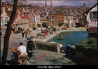

    Scene with Man on bicycle (very fast motion)
    Using SeparateFields()
    Left-hand column = field pairs (TFF) in each frame
    middle column = source fields displayed
    right column = encoded fields displayed
    158-159 - a/a - - a/a
    160-161
    - b/b - - b/b
    162-163 - b/c - - bc/bc
    164-165 - c/d - - bc/cd
    166-167 - d/d - - cd/e
    168-169 - e/e - - e/e
    170-171 - f/f - - f/f
    172-173 - f/g - - fg/fg
    174-175 - g/h - - fg/h
    176-177 - h/h - - h/h
    178-179 - i/i - - i/i
    180-181 - j/j - - j/j

    In the above post, I can see that the original progressive/telecined source is duplicating fields to achieve NTSC 3:2 pulldown on a 24fps > 30fps film original. In the TMPGenc example, the effect on duplicated frames is combing in the duplicated fields/frames. So looking at the encode, the original progressive frames still look progressive, but the pulldown frames look interlaced. At least, that's the way they look on the PC. I'll recode this scene, burn to DVD, and see how it plays on TV. Will try it with HCenc as well.
    But a question: for every 5 frames of telecine, should there be 2 composite frames in every group of 5 instead of 3 frames in every 5?
  7. Originally Posted by sanlyn View Post
    That's the way they're supposed to look on a PC. The editor performs the soft pulldown. The reason editors (VirtualDub, for example) do this is because the the progressive frame rate can be anywhere from 19.98 to 29.97 fps. But the final output is always 59.94 fields per second, 29.97 frames per second when packaged as frames.
    You can use VirtualDubMod to view the video without performing soft pulldown. But you may not get the correct frame rate. For example, if you have a 25 FPS PAL source converted to NTSC keeping the 25 fps progressive frames and applying 3:2:3:2:2 pulldown flags, VirtualDubMod will give you all progressive frames but call it 23.976 fps rather than 25 fps.
    It depends on what pulldown pattern was used. Some programs use 2:3:3:2 or 3:2:2:3 instead of 2:3 or 3:2.
    2:3:3:2: AA BBB CCC DD EE FFF GGG HH -> AA BB BC CC DD EE FF FG GG HH
    3:2:2:3: AAA BB CC DDD EEE FF GG HHH -> AA AB BC CD DD EE EF FG GH HH
    In the 2:3:3:2 example above all the original progressive frames can be found in the 29.97i video without having to recombine fields (the reason 24 fps progressive DV camcorders do this). The latter shows the pattern of 2 uncombed frames and 3 combed frames.
    In case it isn't clear to you, pulldown flags tell the decoder how long to display each frame. There are only two possible values: 2 fields or 3 fields. So a 29.97 video can use 2:2:2:2... flags to achieve 59.94 fields per second. A 19.98 fps video can use 3:3:3:3... flags to achieve 59.94 fields per second. Any rate in between those extremes uses a mixture of 2 and 3. To get from 23.976 fps to 59.95 fps requires a 50:50 mix of 2 and 3. But it could be 2:3... or 2:2:3:3... or 2:2:2:3:3:3... etc. Different patterns give different amounts of judder.

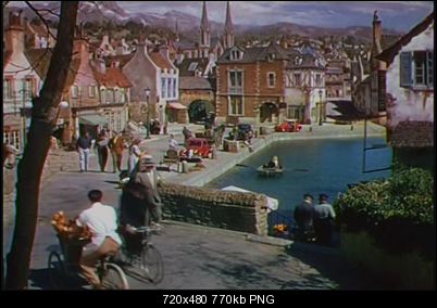

  27. I'm not talking about comb artifacts. If you look at individual frames with VirtualDubMod, or fields after a simple bob, you will see frames/fields are blends from two different film frames.

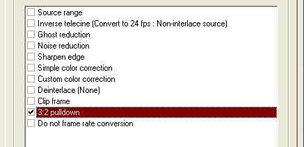

    OK. TMPGenc and HCenc should look alike as far as telecine goes. TMPGenc worked 3 frames in every 5 (instead of 2 in 5) probably because I used this . . .
    ...instead of this:

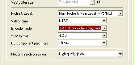

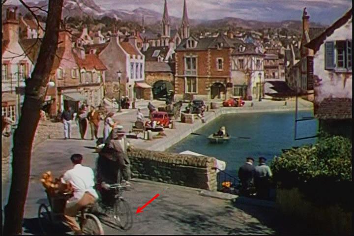

    Encoded again (new TMPGenc 3:2 attached below). Both encoders do the same thing, frame for frame.
    TMPGenc:
    HCenc:

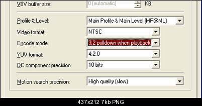

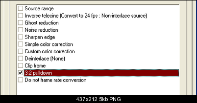

  29. Yes, you're supposed to use the "3:2 pulldown when playback" option. The other one is a hard telecine -- which would require you to set the Encode Mode to Interlace and the frame rate to 29.97 to get a proper file. I see that TMPGEnc generates the blended frames/fields when you use the hard telecine option with the wrong encode mode and frame rate options.
    Your earlier AVI encoded with TMPGEnc with both soft and hard telecine:
  30. Banned
    New York, US
    If I set "3:2 pulldown when playback", according to the doc, the frames will be interlaced and the fps automatically gets populated with "23.976 fps (internally 29.97 fps)" (unquote). If I select the "3:2 pulldown" button, TMPGenc fills in the frame rate as 29.97 fps (the other "internal" choice does not appear in the list). The encode mode choices then become "interlaced" or "non-interlaced".
    The earlier encode used 3:2 pulldown on playback with the 23.976 fps+29.97 internal option. That gave me 3 blended/interlaced frames for every 5. If I try to choose 29.97 fps with "3:2 pulldown on playback", TMPGenc will not allow me to set the frame rate to 29.97. The only frame rates allowed with that option are 23.976/29.97 or 24/30.
    For the encode posted above, I used the 3:2 pulldown box and set encode mode to non-interlaced @ 29.97 fps (TMPGenc filled-in that fps when I checked the 3:2 box).
