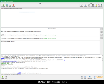

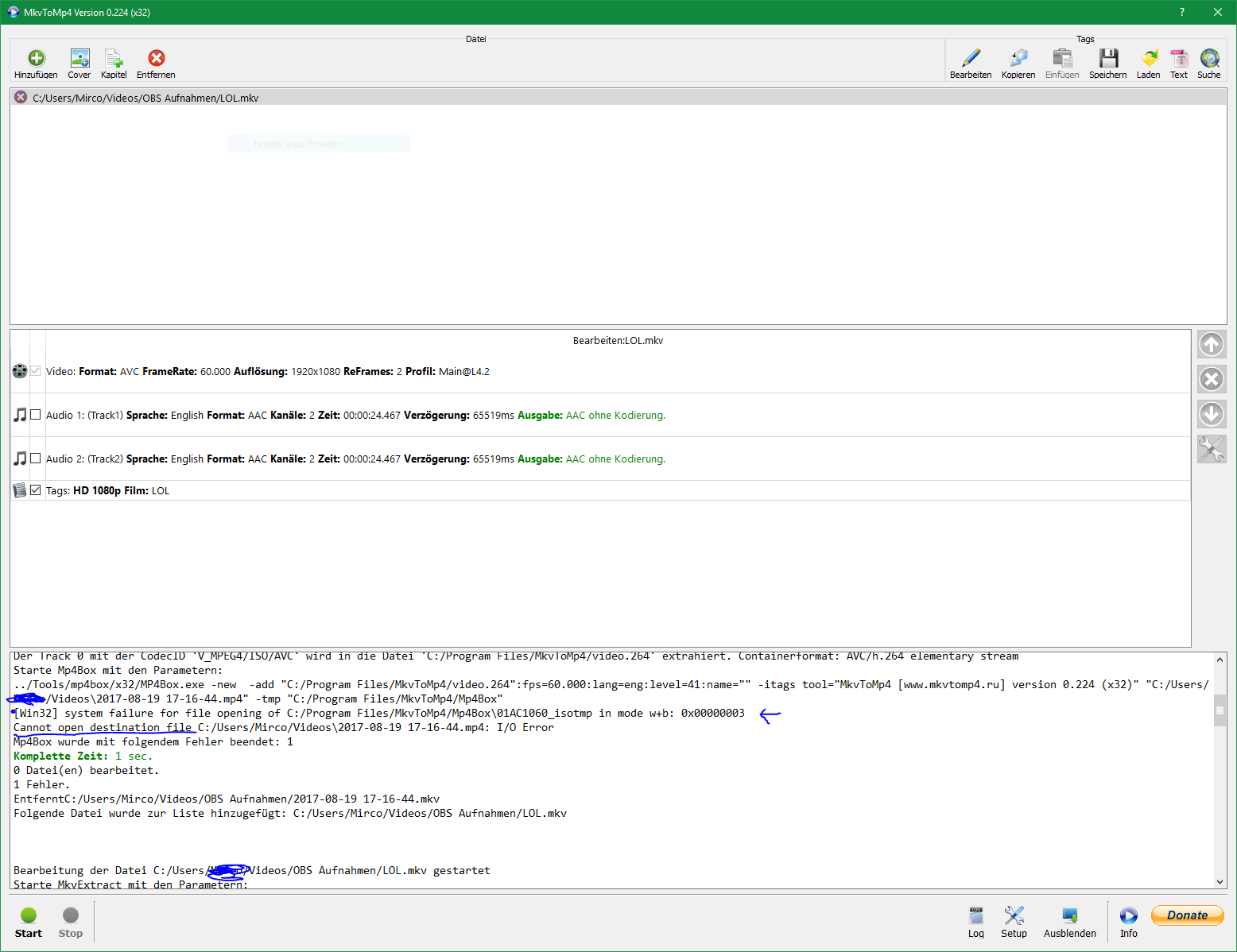

  16. It doesn't work for me because of a crazy error
    I hope you guys can help me!
    Everytime I start the progress with my video added it says sth mad in the log but see yourself:
    Beside of that how can I get the BEST settings available through this app?
    1080p 60fps
    Thanks!
    Your fwnjkafn
  17. The error may be because you put MkvToMp4 into c:\programe files (x86)\. That folder is usually write protected. You have several options:
    - move MkvToMp4 to a folder with less restricted rights or
    - run it with admin rights or
    - set temp folder to a folder with less restricted rights (you need to run it with admin rights once to make the setting, though, because the settings are also a file with write protection)
