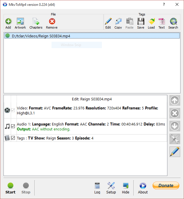

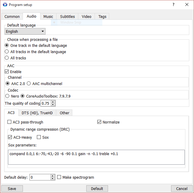

    Quick question to the experts out there -- I've been using this tool for quite a while and have been VERY happy with it. And my apologies in advance if this question has been answered previously: I realize that this tool is great for keeping video "as is" without re-encoding. But is there any setting in the software to make sure that the AUDIO is not encoded (in my case, it's 2 channel AAC)?
    I see there's a checkbox for AAC and an AAC Multichannel and AAC 2.0 settings to choose from.
    Anyway, how do I ensure that the audio is also left untouched?
    Thanks!

    You can do it globally through the settings...
    Enter setup, choose the audio tab, and right under AAC there is a check box to enable/disable AAC.
    Alternately you can do it on a per file basis. Once you have loaded the file, It will list the tracks in the bottom pane. If you haven't already, enable edit mode (pencil icon on the right side of the bottom pane), and double click the audio track after that. It should bring up the encoding properties for that track, you can enable/disable, etc.
    PS - You can set it to automatically enter edit mode each time you load a file....Setup>Tags>check the box to enable mp4 edit mode when loading file.
    Thanks for the quick response Dakon720!
    OK -- I'm just confused about that particular global setting -- if I *uncheck* the box next to AAC in the global settings, does that mean that the existing AAC tracks will be left untouched? (Which is exactly what I want!)
    My tests seem to indicate that I'm not getting any audio at all in my result file if I uncheck the AAC box. So, what's the proper setting for AAC passthrough/no re-encode?
    Mar 2013
    Texas
    Sorry, just had a chance to respond. If you are wanting passthru, leave the AAC enabled, choose either AAC 2.0 or AAC Multichannel. (important to note for passthru it has to be same encoding as the source). When loading the file, it should list the different tracks, and for the audio track, you should see green writing that says...
    Output: AAC without encoding
    That means it will just add the track as is.
    PS - Wow, I totally missed the (in my case, it's 2 channel AAC) part. By default it should passthru AAC 2.0!! I'd mess with the settings, or just reset them to default.
