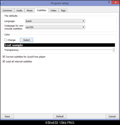

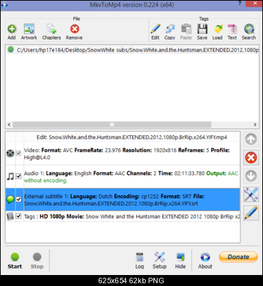

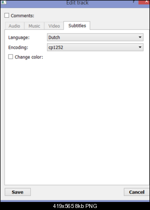

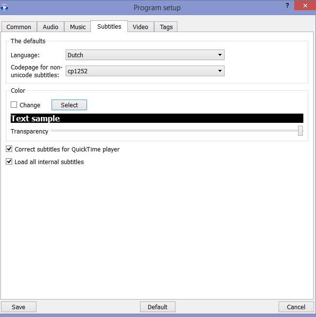

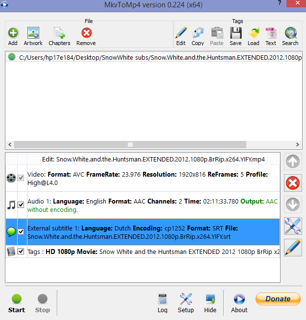

  20. Please help me!!!
    I downloaded a movie for my grandfather. His ears are getting worse so he needs subtitles. The film is already an MP4 file, and I also downloaded the subtitels, wich are a .srt file. I tried adding the subtitles over and over again but it simply doesn't work. With the film itself is nothing wrong. I redownloaded the subtitles several times and used different sites. It still doesn't seem to work.
    The Log:
    Repack/encoder video to MP4 for Apple iPhone, iPad, ATV2. MkvToMp4 version 0.224 (x64)
    Build from: Sep 24 2013 14:57:05
    Use log file: ../Temp/Logs\01_07_2015_19_29_52.txt
    CoreAudioToolbox version: 7.9.7.3
    Added on list: C:/Users/hp17e184/Desktop/SnowWhite subs/Snow.White.and.the.Huntsman.EXTENDED.2012.1080p.Br Rip.x264.YIFY.mp4
    Started processing file: C:/Users/hp17e184/Desktop/SnowWhite subs/Snow.White.and.the.Huntsman.EXTENDED.2012.1080p.Br Rip.x264.YIFY.mp4
    Starting Mp4Box with the parameters:
    ../Tools/mp4box/x64/Mp4Box -raw 1 -out "../Temp/video.264" "C:/Users/hp17e184/Desktop/SnowWhite subs/Snow.White.and.the.Huntsman.EXTENDED.2012.1080p.Br Rip.x264.YIFY.mp4" -tmp "../Temp/Mp4Box"
    Extracting MPEG-4 AVC-H264 stream to h264
    ../Tools/mp4box/x64/Mp4Box -raw 2 -out "../Temp/Snow.White.and.the.Huntsman.EXTENDED.2012.1080p.Br Rip.x264.YIFY_internal_audio_2.AAC" "C:/Users/hp17e184/Desktop/SnowWhite subs/Snow.White.and.the.Huntsman.EXTENDED.2012.1080p.Br Rip.x264.YIFY.mp4" -tmp "../Temp/Mp4Box"
    Extracting MPEG-4 AAC
    ../Tools/mp4box/x64/Mp4Box -TTXT "C:/Users/hp17e184/AppData/Local/Temp/Rar$EXa0.498/Temp/Snow.White.and.the.Huntsman.EXTENDED.2012.1080p.Br Rip.x264.YIFY_external_sub_0_utf8.srt" -tmp "../Temp/Mp4Box"
    Timed Text (SRT) import - text track 400 x 60, font Serif (size 18)
    Conversion done
    ../Tools/mp4box/x64/MP4Box.exe -new -add "../Temp/video.264":fps=23.976:lang=eng:name="" -add "C:/Users/hp17e184/AppData/Local/Temp/Rar$EXa0.498/Temp/Snow.White.and.the.Huntsman.EXTENDED.2012.1080p.Br Rip.x264.YIFY_internal_audio_2.AAC"#1:fps=23.976:l ang=eng:name="" -add "C:/Users/hp17e184/AppData/Local/Temp/Rar$EXa0.498/Temp/Snow.White.and.the.Huntsman.EXTENDED.2012.1080p.Br Rip.x264.YIFY_external_sub_0_utf8_change.ttxt":lan g=nld:name="" -itags tool="MkvToMp4 [www.mkvtomp4.ru] version 0.224 (x64)" "C:/Users/hp17e184/Desktop/SnowWhite subs\Snow.White.and.the.Huntsman.EXTENDED.2012.108 0p.BrRip.x264.YIFY_new.m4v" -tmp "../Temp/Mp4Box"
    AVC-H264 import - frame size 1920 x 816 at 23.976 FPS
    AVC Import results: 189260 samples - Slices: 1644 I 53083 P 134533 B - 1 SEI - 1573 IDR
    Stream uses forward prediction - stream CTS offset: 2 frames
    AAC ADTS import - sample rate 48000 - MPEG-4 audio - 2 channels
    Timed Text (GPAC TTXT) Import
    Setting up iTunes/iPod file...
    Saving C:/Users/hp17e184/Desktop/SnowWhite subs\Snow.White.and.the.Huntsman.EXTENDED.2012.108 0p.BrRip.x264.YIFY_new.m4v: 0.500 secs Interleaving
    Correction mp4 file.
    TKHD atom correction for video. TRAK 1
    TKHD atom correction for audio. TRAK 2
    TKHD atom correction for subtitle. TRAK 3
    Writing tags in file: C:/Users/hp17e184/Desktop/SnowWhite subs\Snow.White.and.the.Huntsman.EXTENDED.2012.108 0p.BrRip.x264.YIFY_new.m4v
    Open result file C:/Users/hp17e184/Desktop/SnowWhite subs\Snow.White.and.the.Huntsman.EXTENDED.2012.108 0p.BrRip.x264.YIFY_new.m4v for test.
    The file C:/Users/hp17e184/Desktop/SnowWhite subs/Snow.White.and.the.Huntsman.EXTENDED.2012.1080p.Br Rip.x264.YIFY.mp4 is processed successfully
    File processing time: 5 min. 11 sec.
    Total time: 5 min. 11 sec.
    1 files processed.
    The subtitles just ain't there, but when I chance the .srt file to a .txt file, the times and sentences are right. I reallyyy hope someone can help me.
    Please react a.s.a.p.
    TheMidnightNeko
    Mar 2013
    Texas

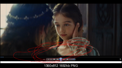

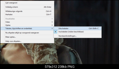

    Okay, first, what are you using to play the file for your grandfather? A computer? If so what player? Most players for the PC support embedded subtitles in an .mp4. But not all Bluray players, TV's, etc. do support them. According to the log, the subtitle track IS being created. But mkvtomp4 does not burn them in, so it will be a separate track from the video/audio. Which means if your player supports them, you have to turn them on. So basically, the next question relies on the answer to the first.

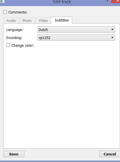

  22. I'm using my laptop to play the file. I connect it with the television using a HDMI cable. The player that I use is Windows Media player. The laptop is a HP Pavilion with Windows 8 and Radeon Dual Graphics. The new file of the movie is being made, but the subtitles just don't show up. I also tried xbox video, but the subs don't show up there either. Click image for larger version

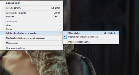

ID:	32367 These are some pictures from the settings and the result. I'm very thankful that you are willing to help me.Click image for larger version

    WMP does not turn on subtitles by default, try this link and post back...
    http://windows.microsoft.com/en-us/windows/show-captions-subtitles-media-player#1TC=windows-7
  24. I tried but it didn't work. If I put it on a USB, would it show on other computers maybe?
    UPDATE: Doesn't work

    First off, I wanna explain that it isn't an mkvtomp4 issue. It's doing what you want.

    It is a player problem, fortunately, I googled "Windows Media Player subtitles mp4" and pages of solutions came up! All involve installing third party software to fix. In that case,I would recommend installing a different player if you are not hung up on WMP (which I personally don't care for). VLC or Media Player Classic or PotPlayer are extremely good alternatives, and can be as easy as just installing it.
  27. Thank you so much for your help!!!! I'm going to install VLC right now. And again thanks!!!
