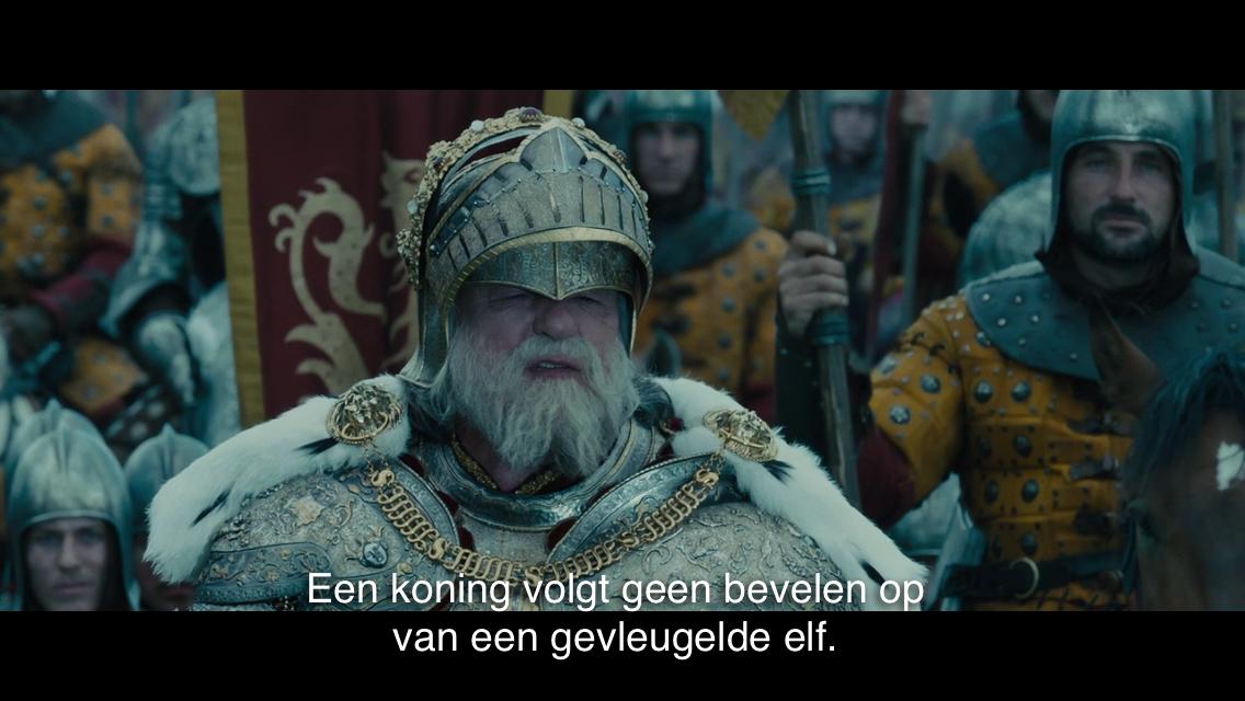

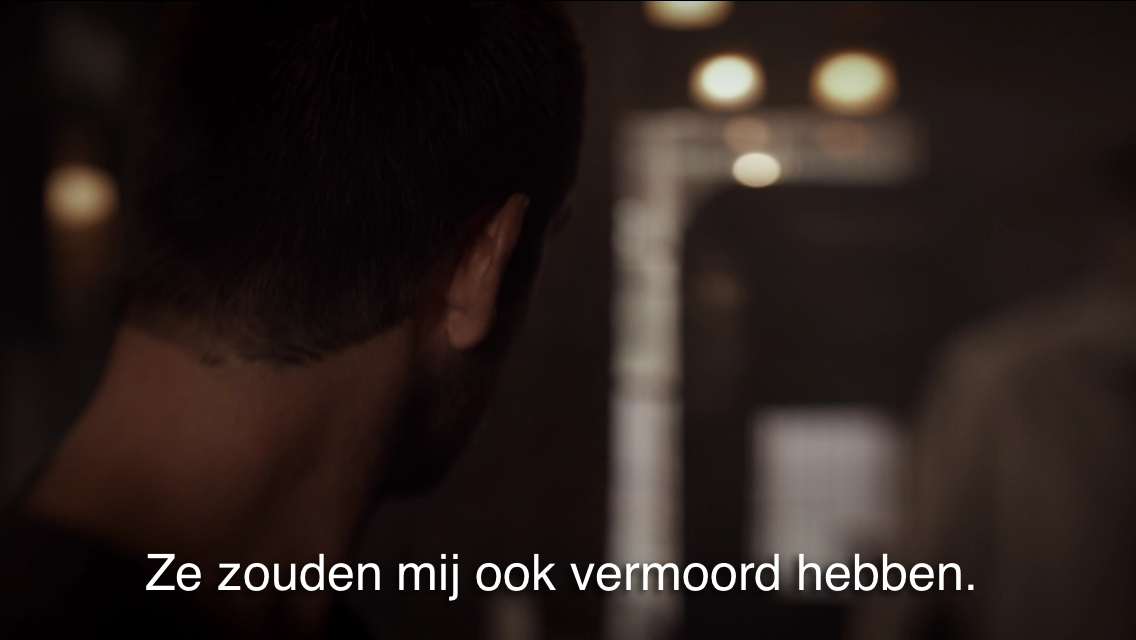

    Does someone has a solution to use the same subtitle size for all videos?
    Problem:
    I don't mean changing the subtitles with built in iOS 7, because there will still be the same difference (aspect ratio).
    Have this problem on iPhone iPad and Apple TV.
