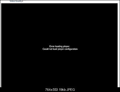

  3. I know that this might not be the place to ask this question, but I have to ask since it is a flash issue, and I know that coders are experienced with flash. Nonetheless, I need help with this issue (attachment jpg below): I'm trying to acquire an RTMPE using StreamTransport, but I keep getting this problem with flash. Additionally, my flash is updated to the latest version. I would appreciate any input or help in addressing this issue.
