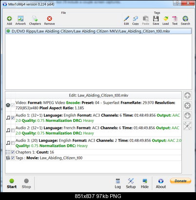

Name:	MKVtoMP4 files.png
ID:	22714Click image for larger version
Name:	MKVtoMP4 filesA.png

    Originally Posted by MAXIMUS01CAN View Post
    ...ran the MKV file through MKVtoMP4 and the video converted nicely, but the audio is out of synch.
    Are you trying to play the video through Apple devices? If so, then this appears to be a problem on Apple's end... I've tried remuxing MKVs using both MKVToMP4 and XMedia Recode, but all the resultant files have audio that plays slightly ahead of the video when playing the movie through my iPad or iPhone. The files are fine in other players, such as Windows Media Player or Media Player Classic.
    The only way I managed to get the audio & video in sync for Apple devices was to re-encode the entire video file. Sadly, this defeats the whole purpose of being able to quickly remux into another container for Apple users. At least there are other workarounds like nPlayer (non-jailbroken) or RushPlayer+ (jailbroken); both of which can play MKV files using hardware acceleration (the latter also offering DTS playback).
    Cheers,
    Visor

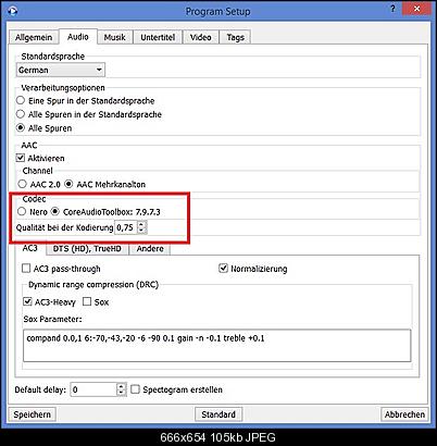

    Hello people,
    first time, thank you for this great software. The software is first class.
    In the settings, the "QuickTime" option is missing.
    "QuickTime" is installed.
    What should I do so this option is displayed.
    Everything is installed on Windows 8.1.
    Thank you.
