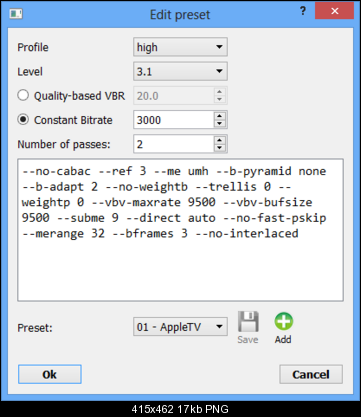

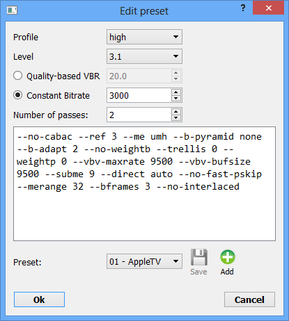

    What is likely happening is that you are repacking the file from MKV to MP4 without re-encoding it. The only way to change the bitrate of a video file is to re-encode it. If you double click the Video Stream in the "Edit" box you can tick the "Encode" box.
    Some options that might help:
    1. Under "Program Setup" then the "Video" tab you can alter "The encoding parameters".So if you're having spikes that high you can try specifying the bit rate.
    Select "Edit" then "Constant Bitrate" and enter a value of between 4 & 5k as that's pretty good for all 1080p encodes.
    2. Use the AppleTV preset.
    3. Or add the following in the text dialog box --vbv-maxrate 9500 --vbv-bufsize 9500. This should restrict the bitrate.
    As far as the best source for what ATV3 is capable of, it is best to examine the the maximum bit rate of iTunes movies.
    Most 1080p movies from Apple range between a maximum bit rate of 12 - 13.1 Mbps. With a typical average bit rate of 4 - 6 Kbps most being closer to 4.

    specs for ATV3 are as follows
    Video Formats
    • H.264 video up to 1080p, 30 frames per second, High or Main Profile level 4.0 or lower, Baseline profile level 3.0 or lower with AAC-LC audio up to 160 Kbps per channel, 48kHz, stereo audio in .m4v, .mp4, and .mov file formats
    • MPEG-4 video up to 2.5 Mbps, 640 by 480 pixels, 30 frames per second, Simple Profile with AAC-LC audio up to 160 Kbps, 48kHz, stereo audio in .m4v, .mp4, and .mov file formats
    • Motion JPEG (M-JPEG) up to 35 Mbps, 1280 by 720 pixels, 30 frames per second, audio in ulaw, PCM stereo audio in .avi file format
    Audio Formats
    • HE-AAC (V1), AAC (16 to 320 Kbps), protected AAC (from iTunes Store), MP3 (16 to 320 Kbps), MP3 VBR, Audible (formats 2, 3, and 4), Apple Lossless, AIFF, and WAV; Dolby Digital 5.1 surround sound pass-through
    If you notice, 4.1 is not recommended, if you want to better understand the levels, check out http://en.wikipedia.org/wiki/H.264/MPEG-4_AVC#Levels.
    Anyway, it basically means, with a 4.1 level, bitrate can spike up to 62,500 on high profile if needed. Whereas for a 4.0 level, bitrate won't spike any higher than 25,000 on a high profile. Those numbers are your ceiling for your bitrate at that level and profile. ("safe" really is 3.1, as it will limit it to 17,500)
