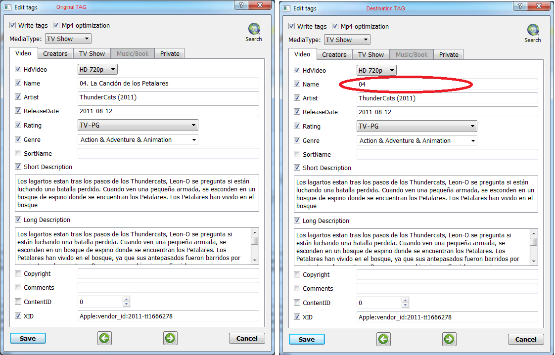

    I found a little bug using de copy and paste tags, and the save tag and import tag, in both cases the Name in the tab video don't be copied
    i put and image with the example
Name:	Error Mkv4Mp4.png
  18. MkvToMp4 author oreons's Avatar
    Nov 2011
    Russia
    augustosanchez,
    This is made specifically so as not to overwrite the name of the episode.

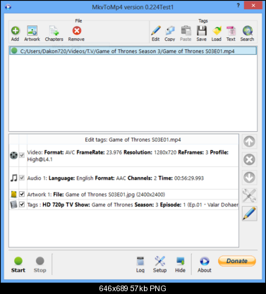

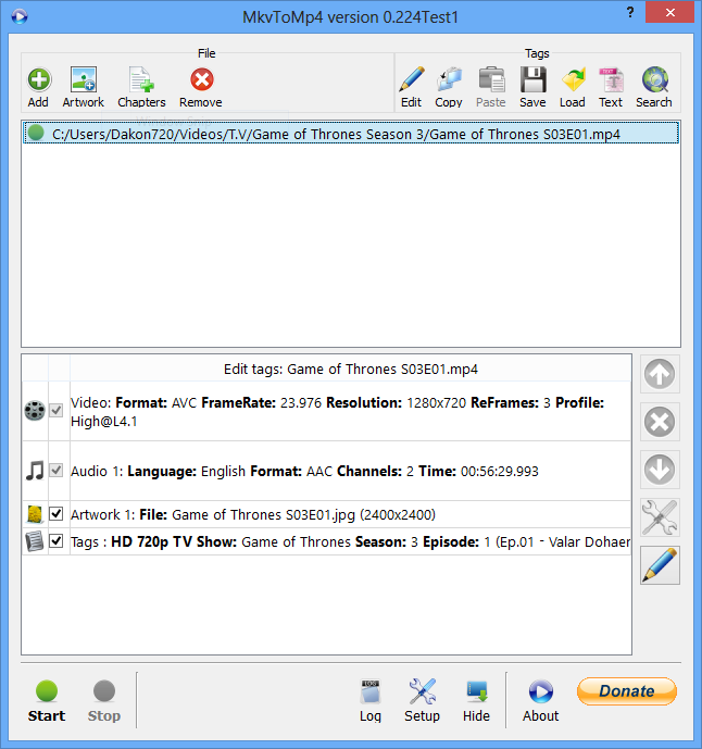

    What am i doing wrong? i waited till all covers were loaded.
    Possibly a dumb question, but after it loads all the covers, are you actually choosing one? (as in it loads into the details)
    After loading the cover, there should be a line for the artwork (you may need to enable edit mode, I've only had to do that if the source file was an .mp4)
    also if you repack a whole series it takes very long to load the bunch of covers on every episode. It would be gread if you could cache all covers while one session, so they dont have to be reloaded every time.
    I have never had to reload covers once I have let them all load the first time. Say there are 15; let them load, and the next time they are already there, as far as that goes I'm of no help. Oreons is good about responding though.
