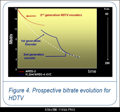

    Per that document, the transmission chain was an uncompressed 1920x1080 50p GV LDK-8000 camera up linked at 38.5 Mb/s to the demo in tandem with with a 1920x1080 50i encode.
    My point was 28 Mb/s 1920x1080 50p/60p is on the low side for an acquisition format because it needs to be re-encoded at least once to an edit master or to a distribution format. 50p has twice the pixels to process vs 50i. In fact, one could consider 1920x1080 50i to be 1920x540 50p the way it is handled in Blu-Ray players and advanced HDTV sets, hence the vertical resolution issue.
    I will grant you that 50p has 83% frame rate vs. 59.94p so it could be claimed it only requires 83% the bit rate. So 28.Mb/s @50p would be equivalent to 34 Mb/s @59.94 and may be adequate for a single re-encode.
    A parallel issue is AVC codec efficiency advances over time and when the new codecs reach consumer hardware chips.
    High end hardware broadcast encoders can perform at much higher compression than consumer camcorders and will improve over time. A key advantage for broadcast compression is uncompressed/low compressed acquisition and editing pre-encode.
    720 50p www.itea2.org/project/result/download/result/5590

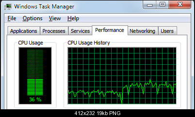

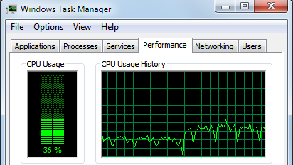

  17. Originally Posted by smitbret View Post
    Bitrate is a much smaller factor than frame rate.
    Please explain, because if that's the case, then why don't we just reencode BR rips to 48fps and reduce the overall bitrate to save space?
    I'm saying in terms of CPU usage doubling the bitrate has less of an effect than doubling the frame rate. Here's the CPU usage while playing same 60p source video encoded at 60 fps and decimated to 30 fps, both encoded at 30,000 kbps (CoreAVC with software decoding on a Core i5 2500K). The first half of the graph is the 30 fps playback, the second half the 60 fps playback:
    The 60 fps playback obviously requires much more CPU power. Try it yourself if you don't believe me.
