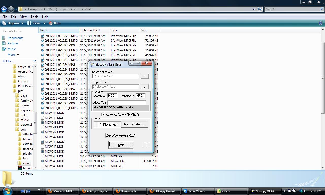

    SDcopy IS easy. Just had not used it for a while and had forgotten how it works
    Dec 2005
    Well, it only copied and renamed all 16 files to mpg but did not merge them and I am not seeing an option to merge in that small interface?

    What? I just used SDcopy v.199851d and and it gave me one .mpg file, which my NLE opens with no trouble...
    edit: I tested it with a Win7 Live MovieMaker and it accepted it too.

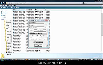

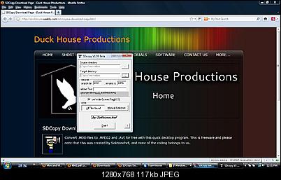

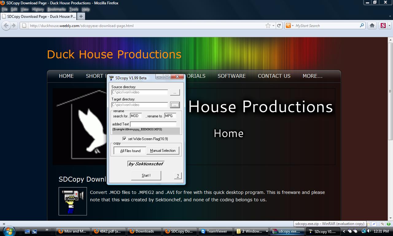

    well, please see both images, first image shows the sdcopy interface and the 2nd shows the result of it?Click image for larger version
ID:	9531Click image for larger version
    Oct 2011
    Finland
    Did you try to import the .mpg file to Windows Movie Maker? I just did that too with my older computer , which has XP and old MovieMaker. No problem, I got the video and the audio OK.
    edit: from a modcopy link:A tool for copying video files from memory stick based camcorders to hard disk. Copies MOD movie files from SD(HC) card and renames the file extension to MPG. In addition the widescreen flag is detected in the MOI file and applied to the MPG file.
    Maybe SDcopy does just that too?

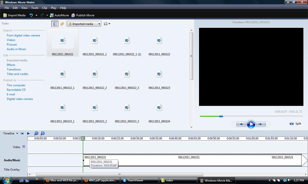

  18. Member
    Dec 2005

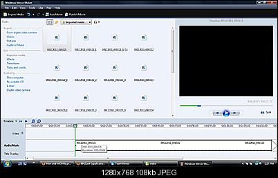

    Just tried importing only the mpg files into WMM and same deal, only sound no picture? I am using Vista Home basic and WMM Version 6.

    Did you drag a clip to the timeline? If you did and could not get the video, I don't know. Maybe Canon SD files differ from JVC ones.
    I only find this alternative http://sourceforge.net/projects/modcopy/

    Dec 2005
    Yes, i dragged a few clips into the timeline, still no pic

    Attachment 9533 doesn't show any clips on the storyboard/ timeline?
  24. Member
    Dec 2005
    pic doesn't show in timeline either

    Well, I don't know then...This workflow does do it here for me, tested it again with VMM5.1 / WinXP, no problem...
    Something's obviously wrong, but I can't make out what. JVC files must differ from Canon ones here so it's not working.

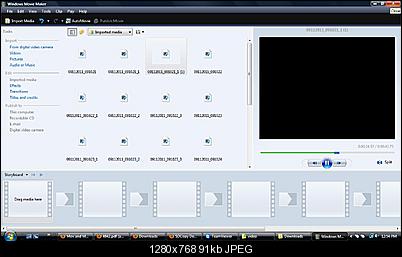

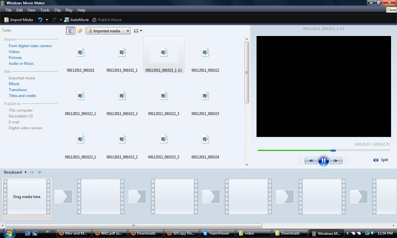

    ISSUE- cannot play mpeg in wmm.. all it does is play the audio..
    SOLUTION- drop clip in “STORYBOARD” and not on “TIMELINE”.
    once I dropped on storyboard and went back to timeline view, it played properly.
    Was able to continue editing...

    but it converted the files to .wmv and this does not import into WMM or play on my pc. I am not seeing where the "storyborad" is?
  30. Member
    Dec 2005
    Oh, found the Storyboard and yes it does work now, trying to see how to merge all files into one now.
