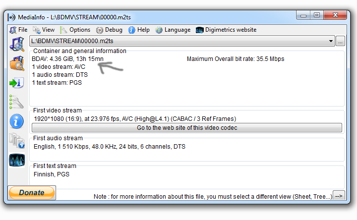

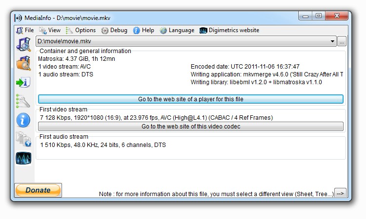

    Source picture: https://forum.videohelp.com/images/imgfiles/1B2Vd.jpg
    Result picture: https://forum.videohelp.com/images/imgfiles/3DdOD.jpg
    This happens once and then and I dont have a clue why. This is 4th time I encounter to this. As you can see the source is just plain mkv with audio and videotrack in side of it. No +ms in audio, header stripping, no subtitles etc. Nothing that could buggy the encode. I use avchdcoder.
    Im wondering if anyone else had similar experience? Conversion of this works with bdtoavchd, but I'd like to get it to work with avchdcoder because it supports multiple audio/subtitles (+ EXTERNAL SUBTITLES!!!!!!!!) that bdtoavchd does not support.
    ps. I have codecs ok etc. This happens like 1-2 times every 20 encodes, so it's not common issue, but it's 1-2 times too much still

    Encoded the movie without HQ subtitles (just unchecked the box) and it turned out to be ok (normal subs, normal size, lenght, plays correctly etc). Maybe this is smth to do with subs?

    Didn't experience this problem yet. If you added an external subtitles file this could happen (if the subtitles file has a line on 13 hour). Because the duration of the container is bases on the stream with the longest duration. So a couple of questions:
    If you play the disc in a blu-ray player or play the m2ts with a software player. Does it run fine? If you jump to 50% of the movie with the timeline. Does it go to 8,5 hours or not?
    So where did the text stream come from then? I suspect the issue with this is because of the subtitles added. And you have confirmed as much....
    When I opened m2ts file with splash pro or vlc it said its 13 hours long. Video and audio runs just normal, but even I had subtitles enabled they dont show up. If I jump to 50% of timeline it's all black, nothing goes there.

    Subs only work on a blu-ray compatible player. VLC cannot show them. Anyway this is source related. Your audio or subs are the issue.

    Now you misunderstood me. I know vlc is not br/avchd compliant player, but it still shows picture and I just wanted to see if it shows the same black content. I mainly use splash pro or cyberlink powerdvd for avchd, they work very well - and they dont show subtitles in those 13 hour long projects neither.
    This case solved when I turned hq subtitles off, result was normal length, subs normal etc. Earlier project it didnt help, normal or hq, result ended 13 hour and some minutes long and there were no subtitles. I remuxed video, audio and subtitles and encoded mkv with bdtoavchd and it worked, SO my wild guess is that it has smth to do with program in avchdcoder or that program in it that does subtitle converting.
