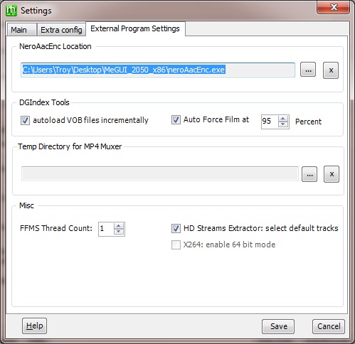

  9. did you setup the file paths for neroaac in the configuration for megui?
    does the mp4 play in mpc ? can you hear audio and how many channels ?

    Plays fine in wmp. I've attached the settings for NeroAacEnc.
