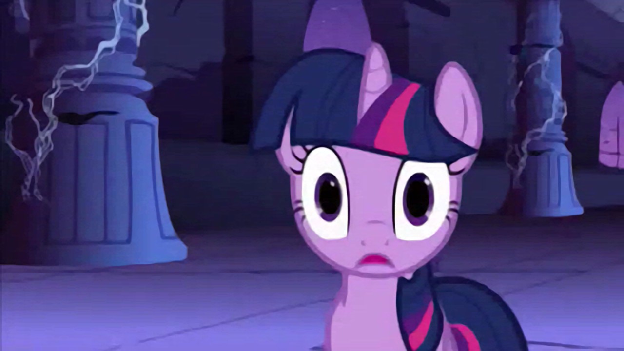

  7. Maybe something like this to get you started:
    ffVideoSource("Opening.flv")
    DeBlock()
    Crop(0,56,-0,-56)
    Sharpen(0,1.0)
    santiag(strh=2,strv=2)
    Nnedi3_rpow2(rfactor=4, cshift="BiCubicResize", fwidth=1280, fheight=720)
    AwarpSharp2(depth=20)
    MergeChroma(awarpsharp2(depth=32))
    I'd recommend reconstructing the opening fade in since it's a static shot otherwise.

    I encoded it using the above script into an avi file.
    The resulting vid looks pretty good unless there's a rapid movement. At those parts, it looks kinda smudged and blurred.
    I know the original is shitty and there's not much to work with so it's still a pretty good improvement.
    If you could go the extra trouble and try to change some settings to make the vid look less smudged in the fast parts (if it's even possibleú, I'd be extremely grateful
    I myself know only some basic AviSynth filters and have no idea what filter to change/add/remove to improve it
  9. Originally Posted by MousE0910 View Post
    Ain't gonna happen. There are two many blended frames and not enough clean frames.
