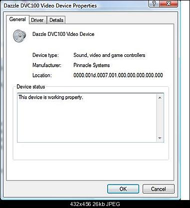

  1. I have just bought the Dazzle DVC 100 to record my Xbox 360 gameplay. All weekend i have been trying to figure out how to get it to work, i have Pinnacle Studio Plus 12 and when i go onto capture the audio works but there no video, a box comes up saying A valid input Signal has not been detected Please check your cables (added image to this thread). And when i open up Safetly Remove Hardware it only says Dazzle DVC100 Audio Device and not Dazzle DVC100 Video Device. The way i have set up my xbox to the dazzle is the composite cables are directly connected to the dazzle and i have a hdmi connected from the xbox to my tv, is that why there is no video? I have also tryed downloading the Vista 32-bit drivers for it but it still does not work. DOES ANYONE KNOW HOW TO SET IT UP PROPERLY?!

    Something to do with the drivers? Check the device manager for any unusual status.

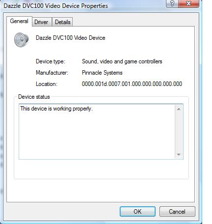

  3. Yes i think it might be the drivers. Ill try the device manager now
  4. Click image for larger version
ID:	9486It says its working propely but it just doesnt :L
    Mar 2008
    Are you sure there is a signal over the composite connection. Does the Xbox output HDMI and composite simultaneously ?
  6. Thats what i just found out, when i have the hdmi lead out of the xbox and only the the composite in it works :L So i need to try and find a way of making the xbox have two video outputs. Or i could just buy spliters and the double male composite lead
