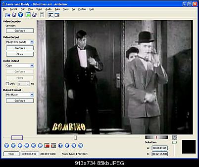

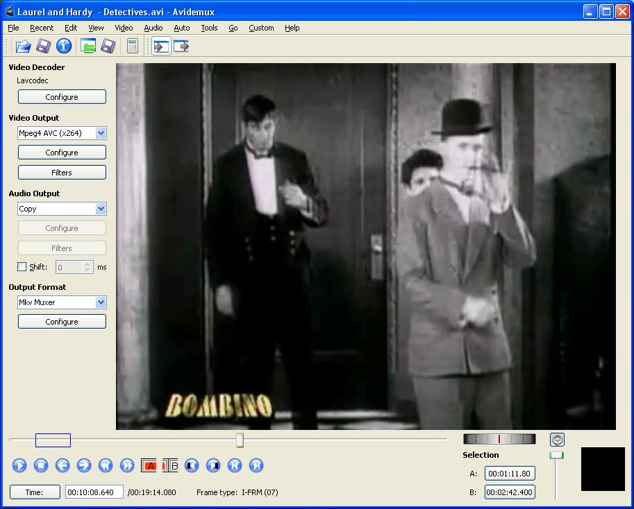

    Why don't you try, and see what you prefer? Open the video in Avidemux. On the left, under "video" set it to mjpeg.
    Select filters/transform/rotate (set your 90 degrees and close the dialog)
    Set the "output format" to AVI. At the top file/save, set path and complete filename . eg. new video.avi
    If you wish to try H264 (AVC), it's as above except set "video'" to AVC.
    Either keep it in an AVI, or perhaps MKV.

  16. You don't save the video from the filter dialog. After adding the filter you go back to the main dialog and save via the floppy disc icon of File -> Save.
    1) File -> Open
    2) Video -> select codec
    3) Video -> Configure... adjust settings if necessary
    4) Video -> Filters -> add Rotate filter (make sure it shows up in the right pane) close filter dialog
    5) Format -> select output format (AVI, MP4, whatever).
    6) File -> Save -> Save Video... be sure to include the file extension
