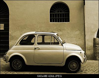

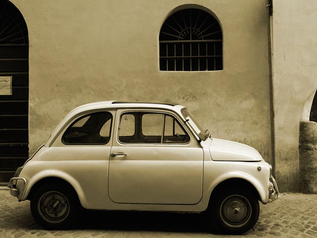

    How to explain this ....
    This is 640x480. Your display card is expanding it.

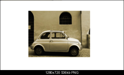

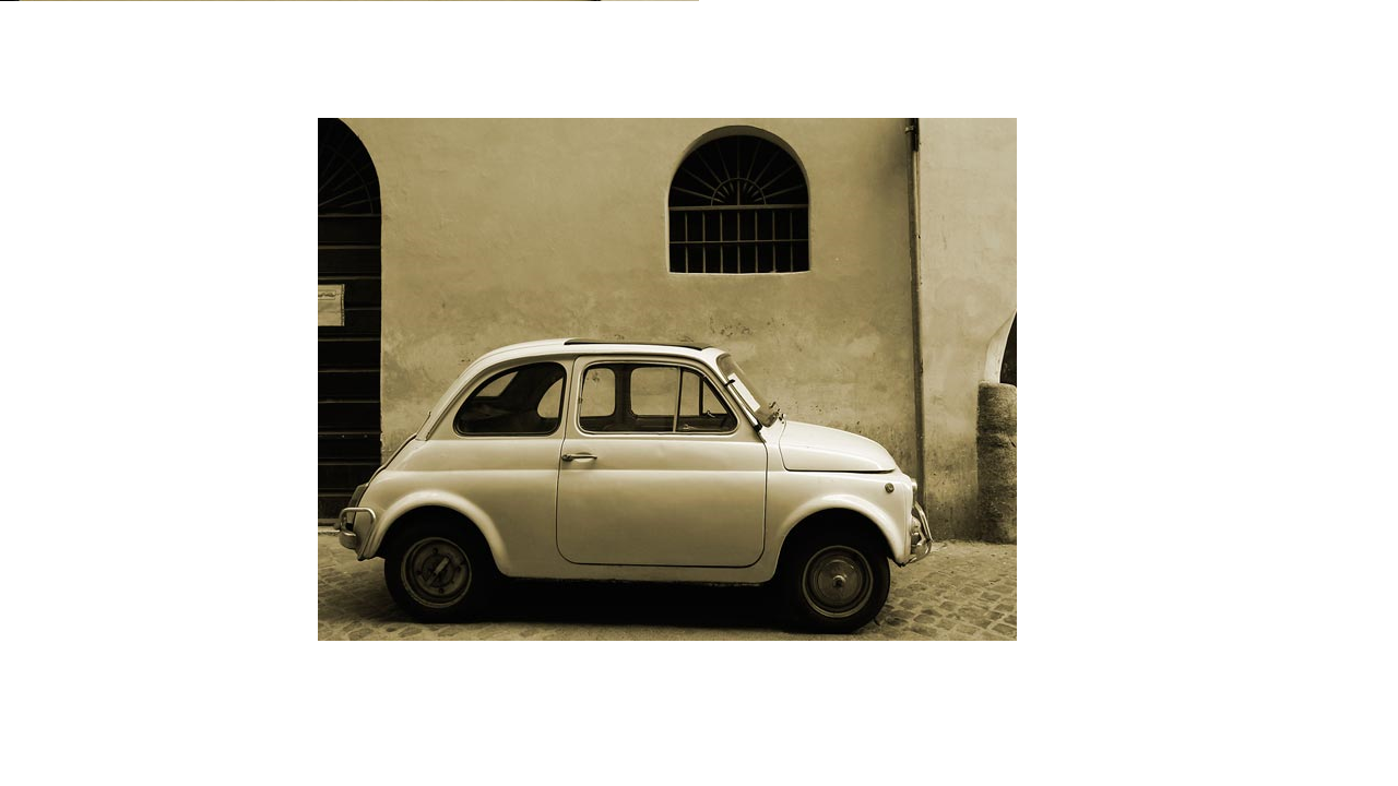

    This is 640x480 in a 1280x720 frame before upscale (stretch)

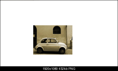

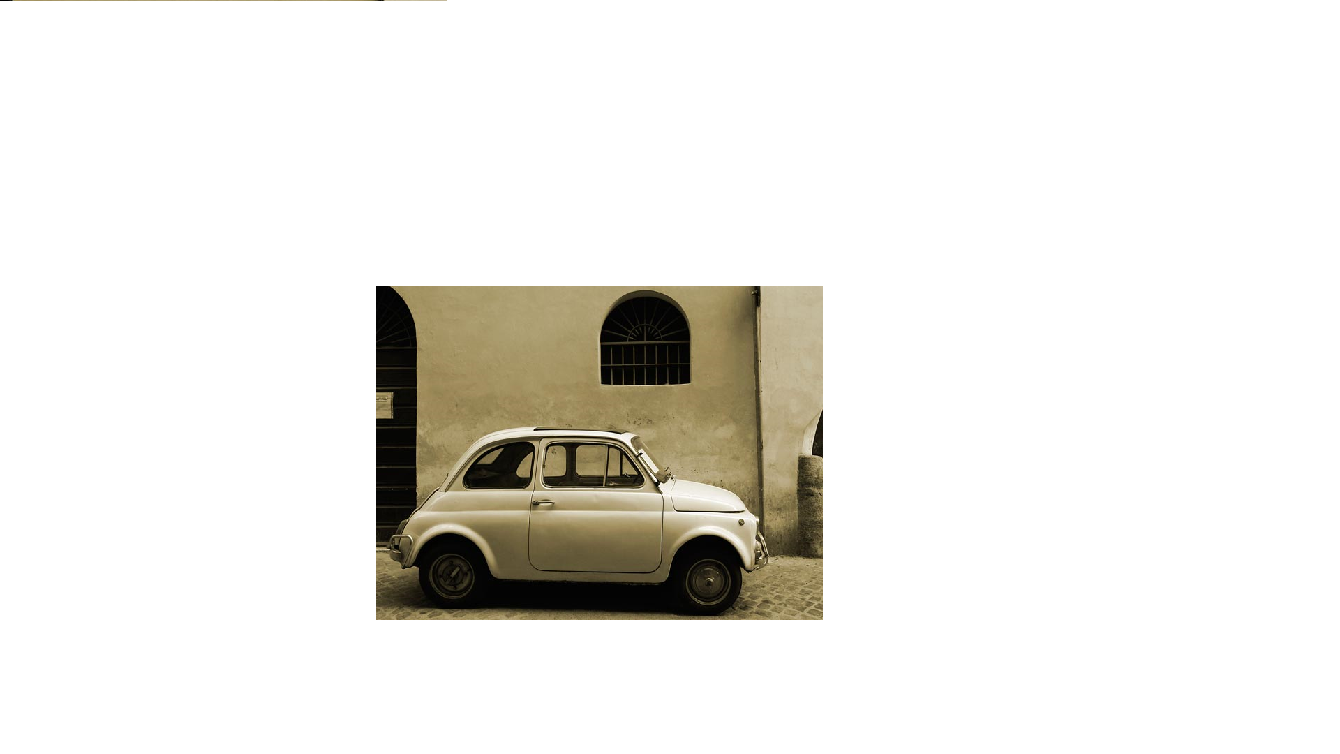

    This is 640x480 in a 1920x1080 frame before upscale (stretch)

    What's with the rolleyes? That was a bit rude.
    Anyway, I figured that that is what was/is happening. I was just holding out hope that there was a way around it, but it certainly doesn't seem like there is.
    I was being a little picky about the quality of the picture anyway, it looks good enough.
