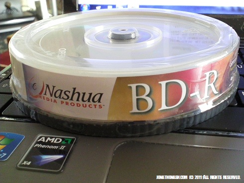

    Just pick up a new blu-ray drive from eBuyer today and a 10 pack of blu-ray media Nashua BD-R 4x Made in China, i never heard of that brand of discs and a quick search on google just came up with there website and not very much information, so has anyone heard of this brand of discs or should i send them back?

    30 years ago nashua corp was one of the better suppliers of floppy discs when they were floppy as in 8" and 5 1/4". now they are probably only thought of for their #357 duct tape.
    is there a mid that imgburn can find?
  3. Yes, give us a MID (media code) and maybe we can help.
    Pull! Bang! Darn!

  5. aBigMeanie aedipuss's Avatar
    Oct 2005
    666th portal
    search that mid on cdfreaks.com it appears they are pretty much junk. might be ok if you don't put more than 15gb on each.
  6. I'd send them back.
    If you want cheap discs, try the RiData or Titan (also Philips, same MID). They work fine with my burner (LG WH12LS30), and they probably would work well on your LG burner. Good luck.
    Pull! Bang! Darn!

    I finally got around to burning a few disc, they all burned fin3 and verified without errors, the disc are mostly just given to people i know, all the imported stuff will be written on Verbatim/JVC printables.
